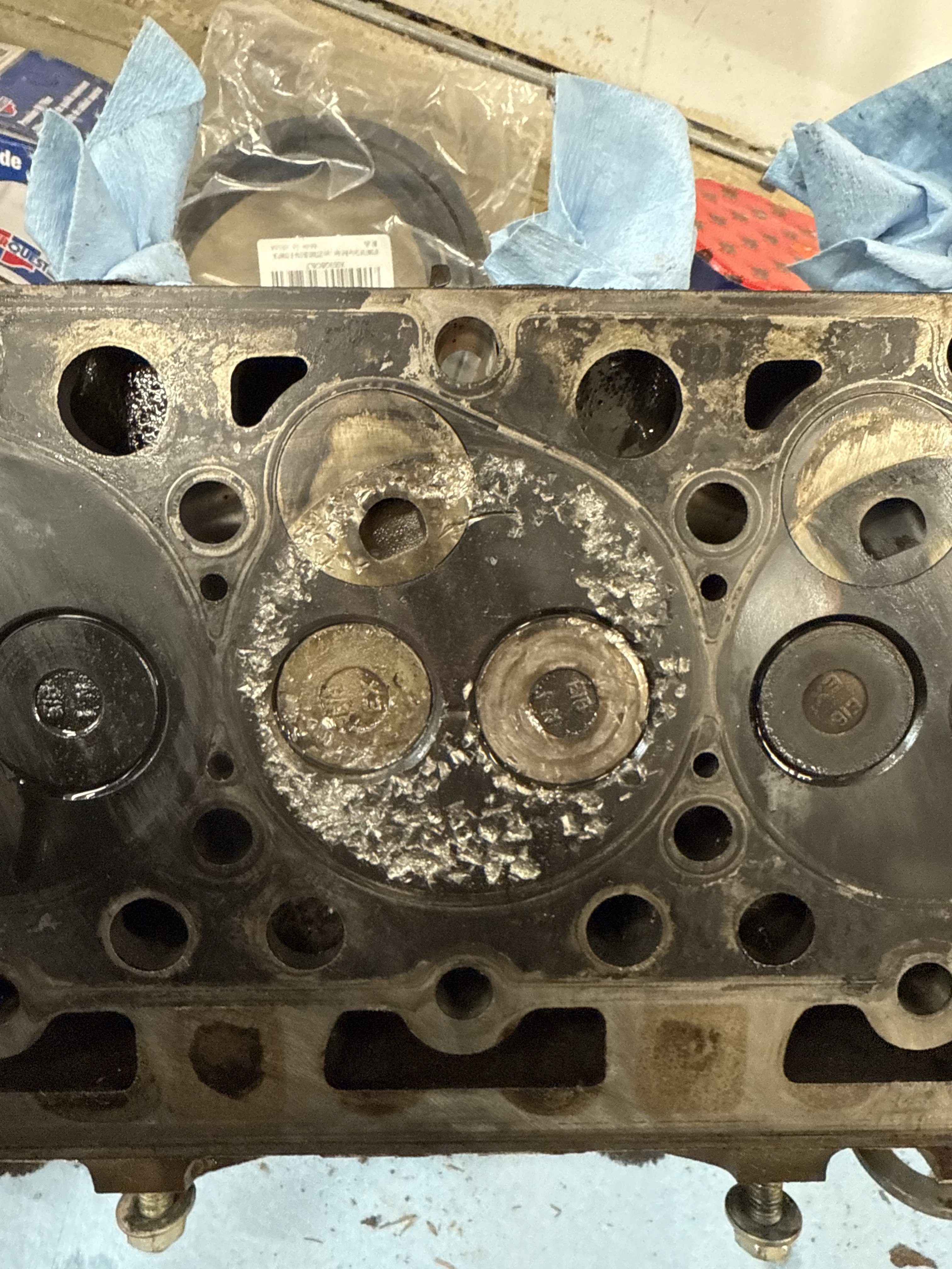

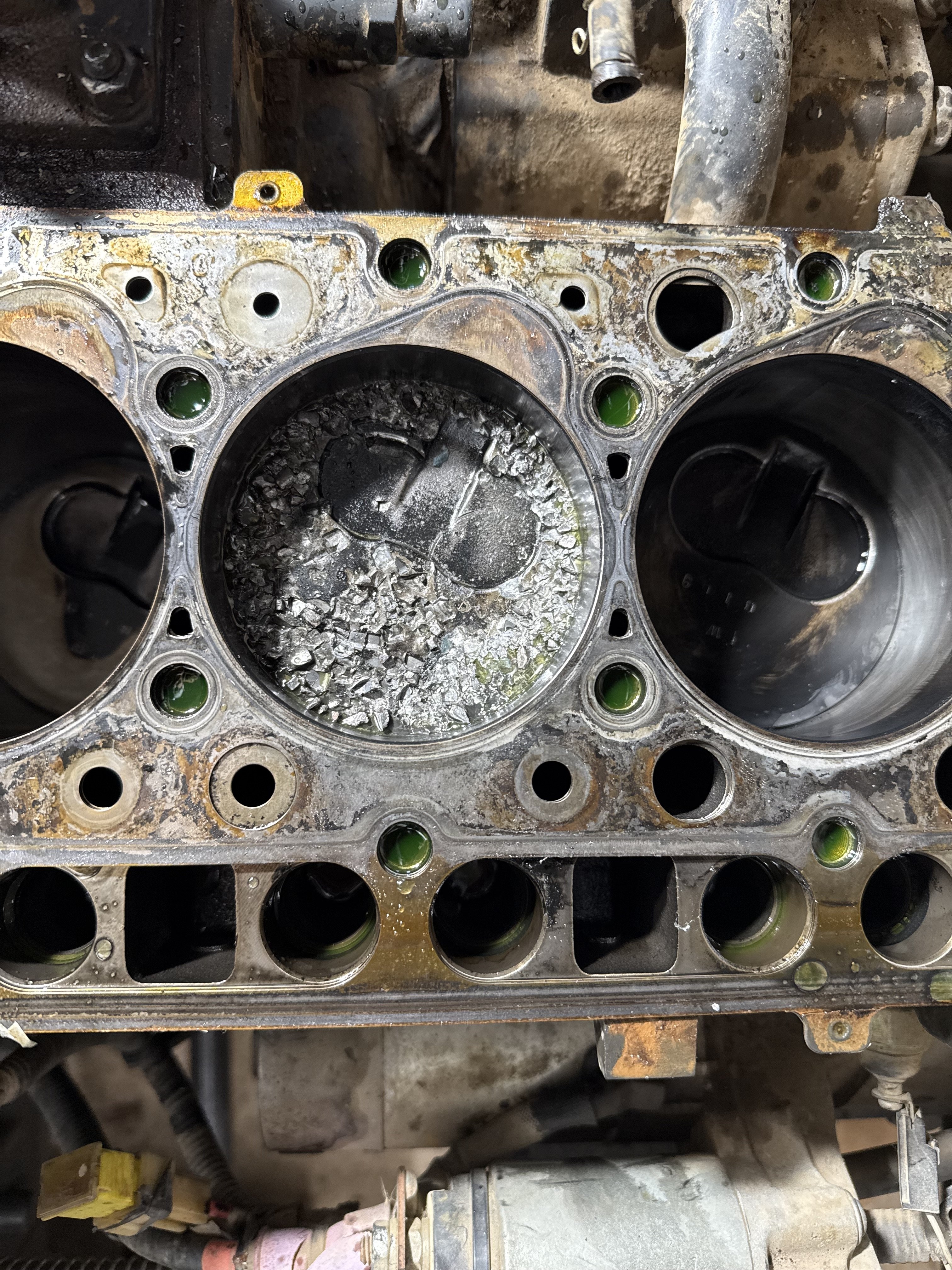

OK guys, back and not the best news, bent rod but terrible damage to the #2 piston and cylinder. I have no idea what metal caused this, as nothing in the top half dropped, valves, springs, retainers, rods...I mean it was all there a together. My best guess at this point is the top ring on the #2 somehow floated on top of the cylinder and then got crushed/melted into the piston and damaged the head.
PICS
As you can see form the pics it's quite a bit of damage and I now have to remove the whole darn motor and I believe that is going to require me to break the tractor in half (looking into this so please let me know if you don't believe this step is necessary) and then open up the bottom and see exactly how much worse it gets.
Needless to say last night turned into a 12 pack night as I drowned my sorrows, but the work continues and then we will see ultimately how I will address it all.
   / Tractor might be shot - now working on compression testing and have questions #30
For some reason I don’t think it was the ring but possible. It obviously sucked something in though.
