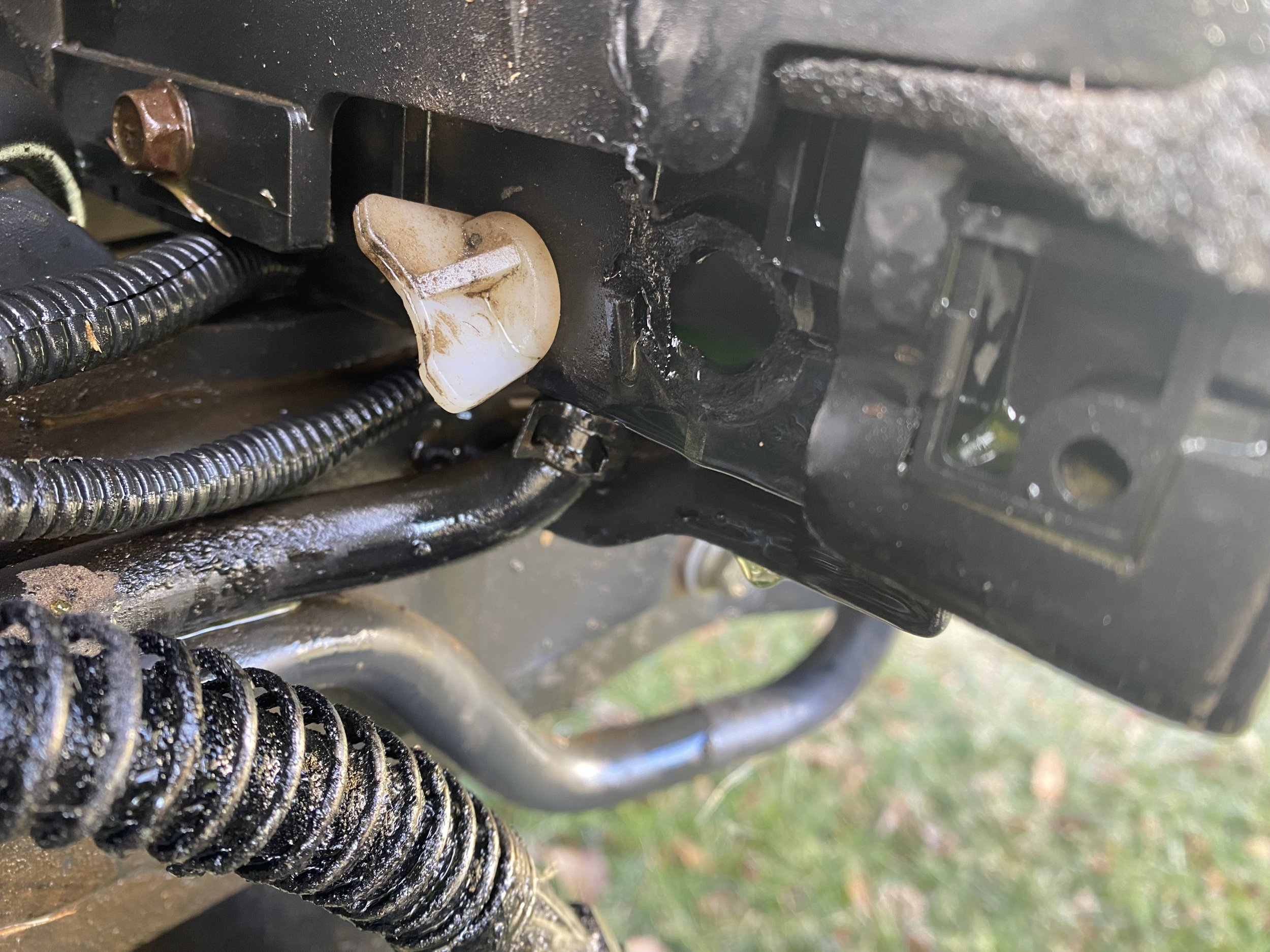

The lower tank is structural fiber and not repairable
I was wondering what type plastic it is too, but I've repaired some plastic stuff in the past with limited success. anything that gets cycled between hot and cold with plastic and metal doesn't seem like a good choice of materials to use. I can't imagine any repair to that plastic tank that I would put trust in. Honstly, I hate it when I see plastic parts used on engines. Some parts are fine depending on thier purpose and type of polymer it is. When I encounter a failure of a part on my stuff, I look to replacing it with something better than the original, which usually involves exploring salvage yards or fabricating a new part or modifying the original so it won't ever fail again. The downside of what I do is it takes more time to complete the fix vs. replacing the part with another original design part. I guess I'm stubborn and cheap, but I don't end up getting angry over another failure on the same component. Tractor parts are ridiculously priced. I suppose if you need it fixed sooner than later you could try scouring the interweb for used replacement parts that will just bolt right in and get you moving again for a little less moolah than $1000 bucks. I wish you luck Citydude. Please let us know how you make out.

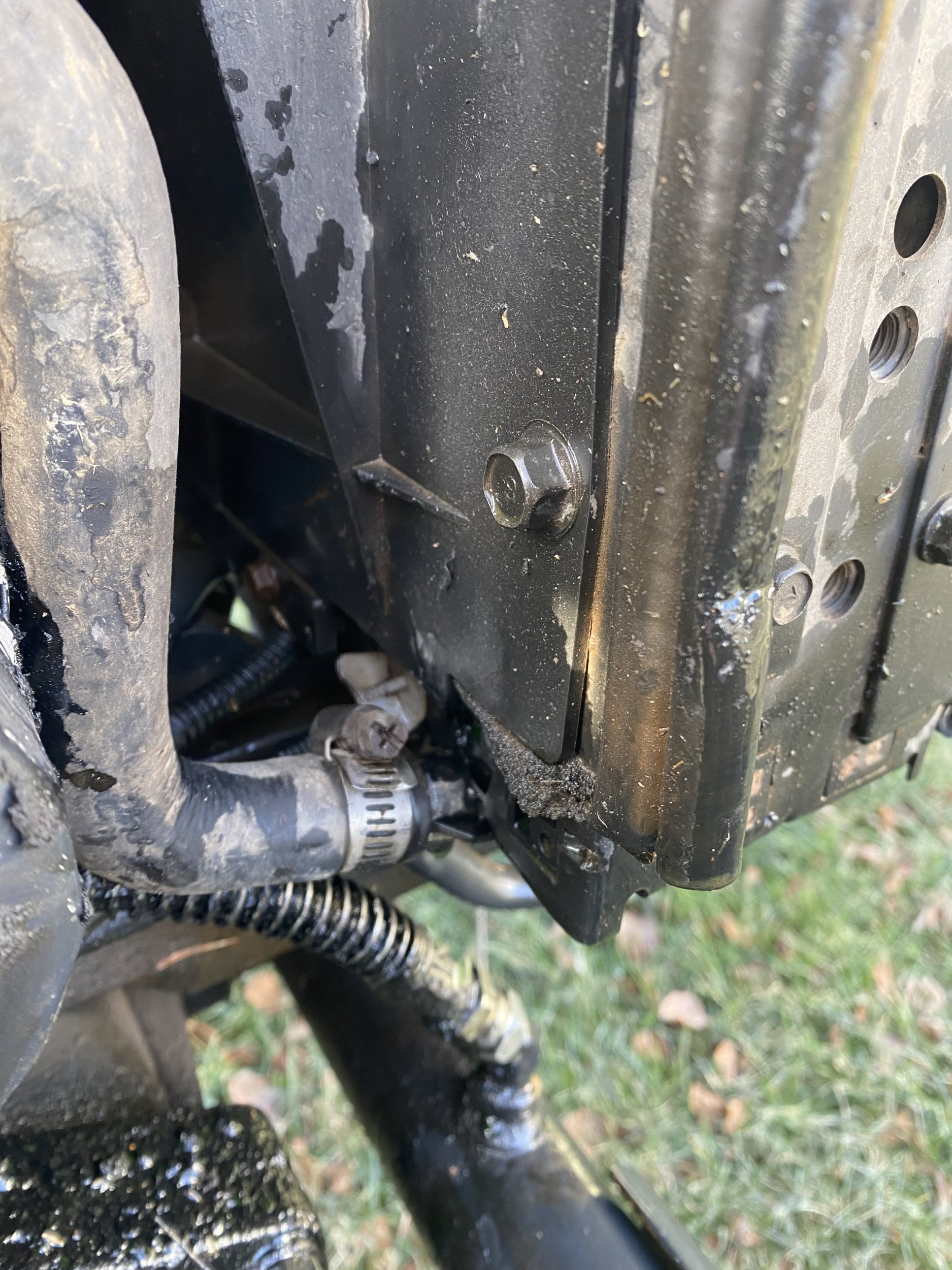

Well as the description says, was out clearing some brush and started smelling radiator fluid, checked and found this:

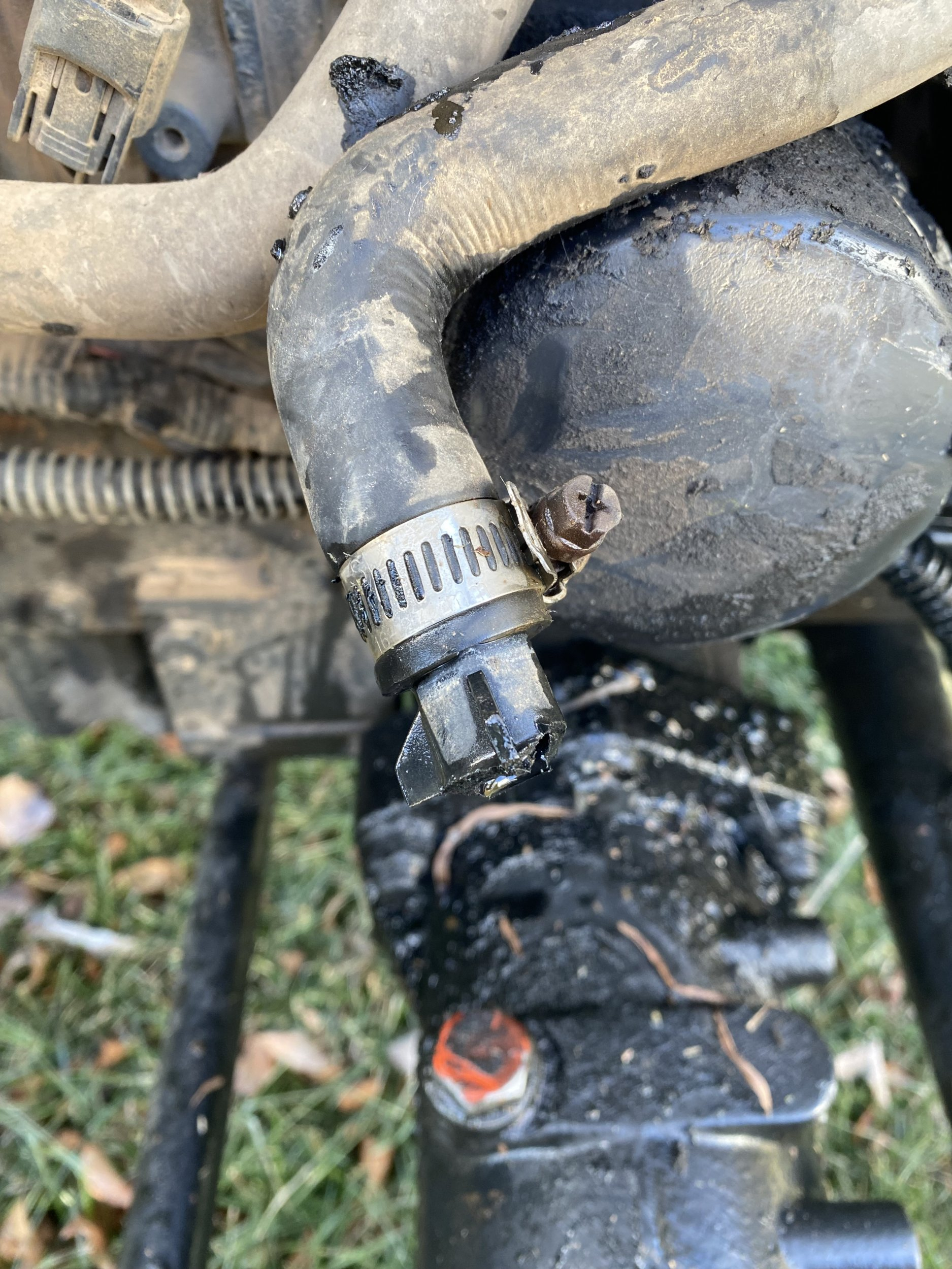

Closer inspection revealed this:
As you can see, the plastic part of the lower radiator, clean snapped off and is still in the hose. My guess is the only option is replace the radiator, but figure I'd check here first before buying something.
One last photo showing the broken opening on the radiator:
For the record, this is a Bobcat CT335....I don't think that matters but figured I'd throw it out there.

You'll NEVER clean it good enough for any kind of "glue", including JB. A radiator shop may be able to "weld" it, but I doubt it. A new one is in order, I believe.
My 3 different JB radiator repairs went from being emergency fixes to permanent fixes. After years of not failing. I just decided there's no use fixing anything that aint broke. I also patched a leaky gas tank with JB and that also became permanent after lasting for years. Go to town and buy a radiator or a gas tank, or send away for them if you have the money and the time. When you need a fix right now, JB can be a lifesaver. I don't leave home without it in my tool box.

looks like you are up for a new radiator, or at least a new bottom header, if you can get one. I would say a branch has got in there and snapped it off, you may want to provide some protection for the new one?

My first question before fixing it is, What caused this. Usually a broken engine mount or?. Something shifted causing it to break off like that. I have repair them before with super glue and baking soda mixed. Because there is no pressure at that point other than heat expansion. Something hit it or it flexed to break like that. My 2 cents worth. If you glue it I would also use this to staple it.
Motorguard (JLMMS2500) Magna Stitcher Plastic Repair System​
