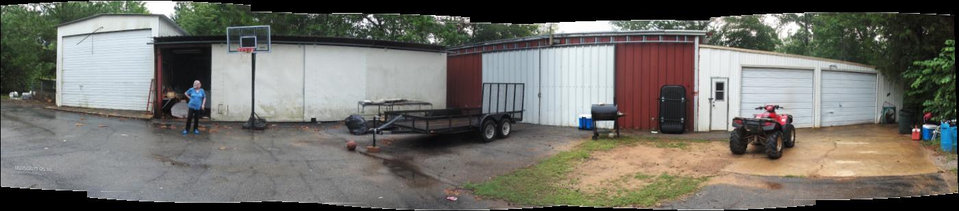

That's the main reason I bought my salamander.
attachment.php
With basically 4 shops totalling 5,500 square feet I needed a relatively inexpensive solution to warm up anywhere.
