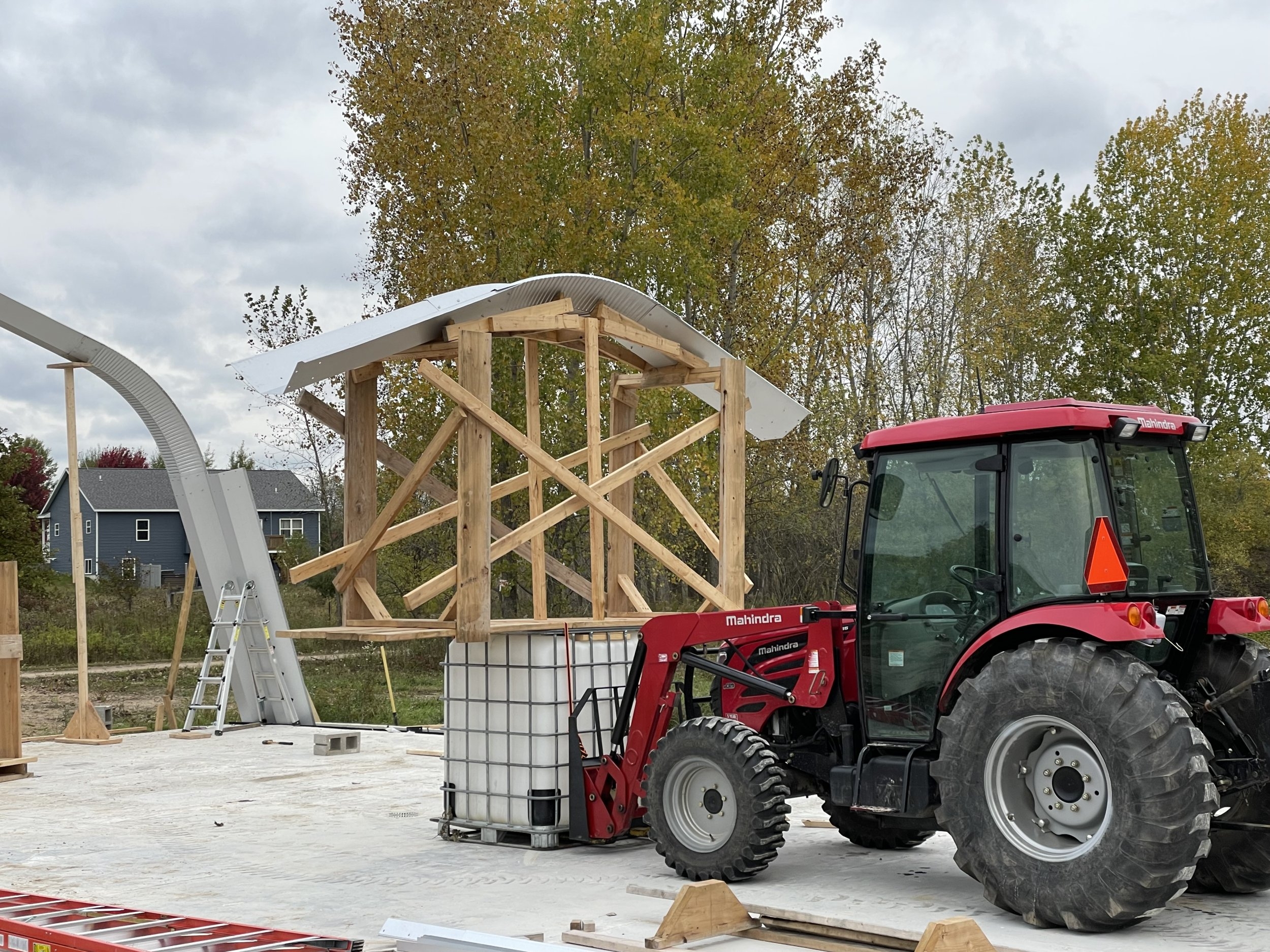

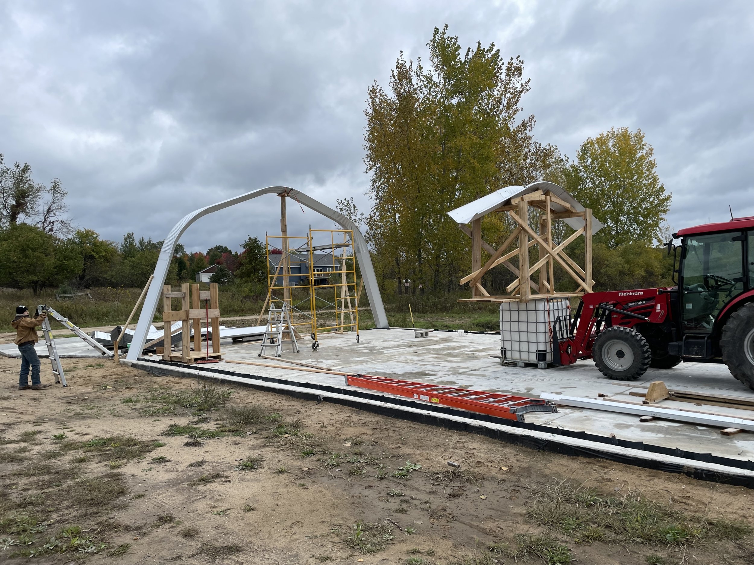

I am in the process of setting panels now. This what I am using to lift the center section of 3 .

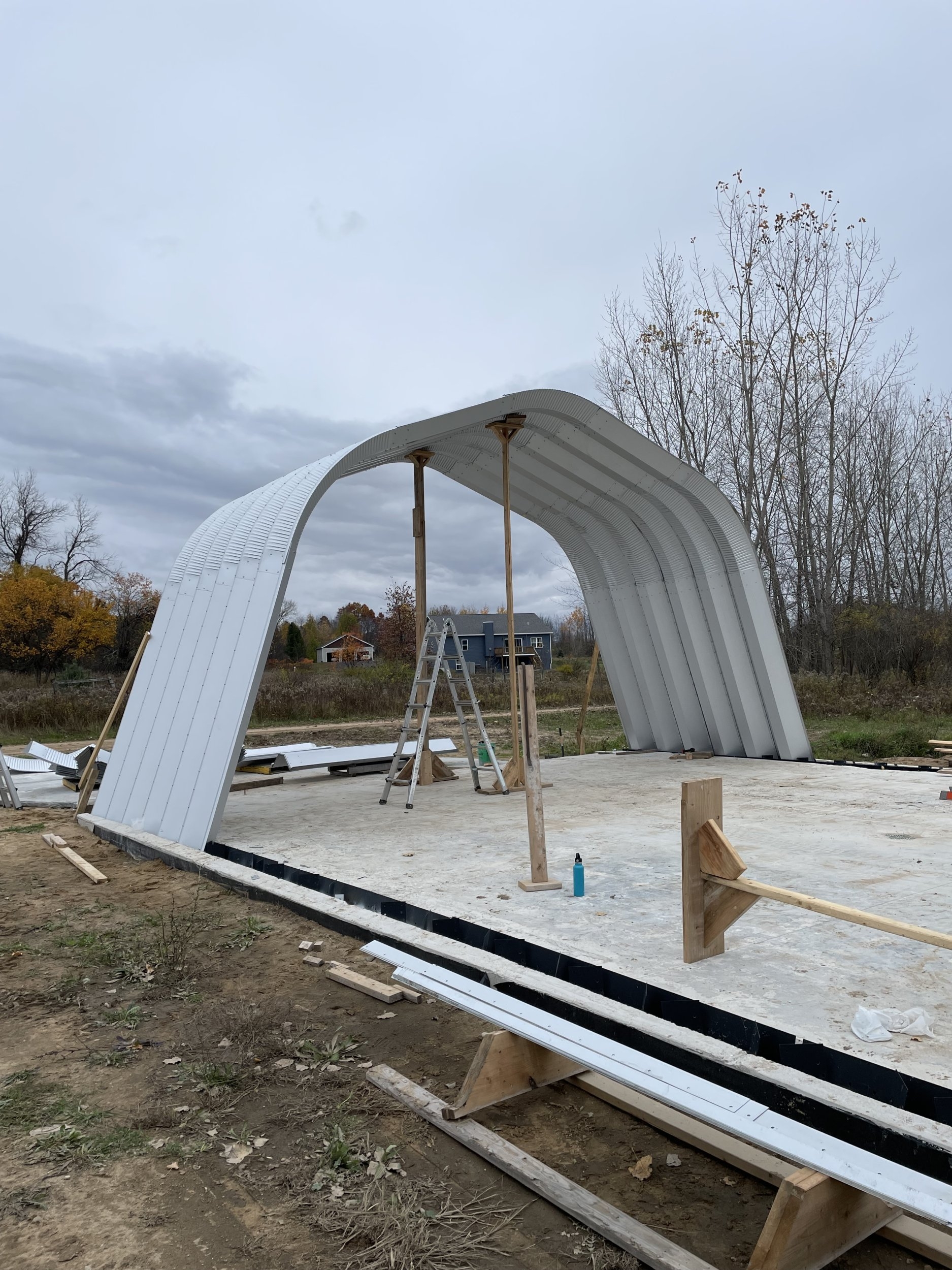

The Xframe is stronger for snow weight. I would not recommend elderly persons do this. The height and weight is a component of concern. I built my own baseplate. I found it very helpful for assembly. I would have bought the baseplate if it were 3k or less. The X frame was more like 7k for 48’ long. I feel that is not right priced.
