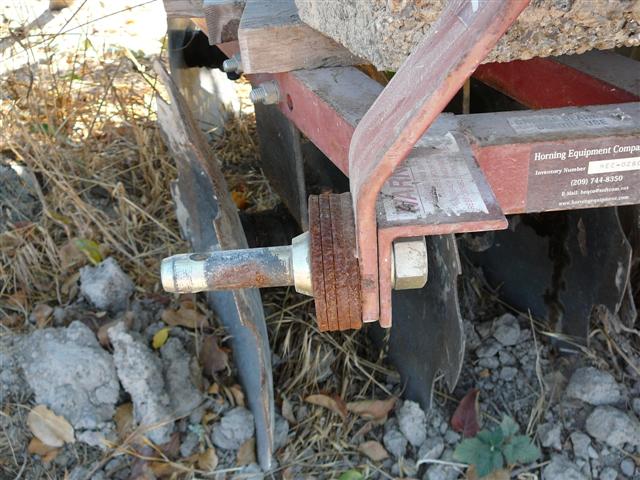

Yeah. Here's my minor improvement to a small disc to match the QH. New pins and some washers.
No bushings. There's no need for a precision fit in this application.
p1200137r4ftdiscpins-jpg.110154
Thanks for this image. I will need to reconfigure my old 7' rear scraper blade with something like this, probably.

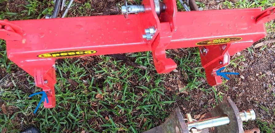

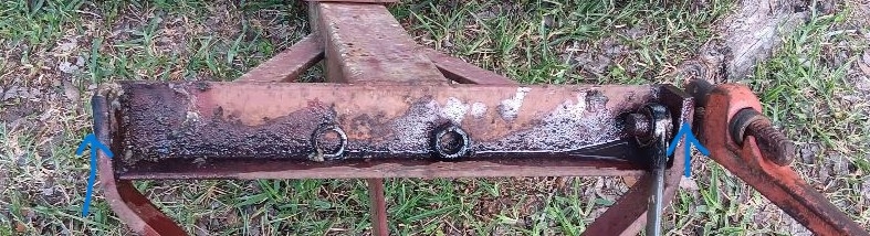

Brush cutter hooked up good to new Speeco QH it's the biggest heaviest piece I have so that's great.
Box will have to move mount and support arms, no biggie, but my 4' rake pins are to short.
Which bushings or extra long pins can I use? Need about 2 inches more each side?
5 1/4" now, need about 8" each?

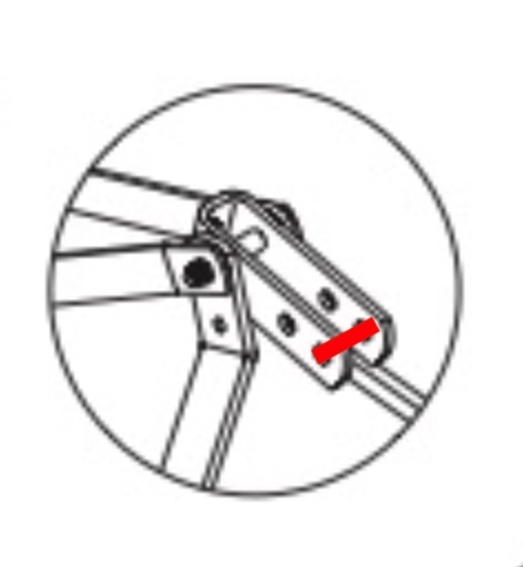

   / Quick Hitch #54
On a quick hitch when the bottom pins are locked in
its not possible for the top pin to jump out of the top
hook
willy
   / Quick Hitch #55
hook
willy
It appears to me that "top pin jumps out" complaints are from using a rotary cutter, in a quick hitch, with a pin (red) in the holes designed for the top link, instead of re-assembling the cutter hitch to fit a quick hitch.
The A-frame should fit the quick hitch, with the flex link behind the A-frame.
Bruce
The slightly longer pins shown above were from Tractor Supply.
For your rake needing substantially longer pins, and if maintaining OEM authenticity isn't important, I would cut off the pins and weld on a new pin assembly like shown in post #42 above, with the pins hammered full depth into square tubing.
I don't think a rake can cause extreme stress, but you think so then you might want to reinforce the new pin assembly. See the other post linked from post #42.
   / Quick Hitch
#57
The rake is light and could just hook it to 3 point but would be nice to have all attachments used with QH.
QH 29 1/2" rake is 21" Believe extra long pins from Rural King at 5 1/2 usable end 8" overall should work.
