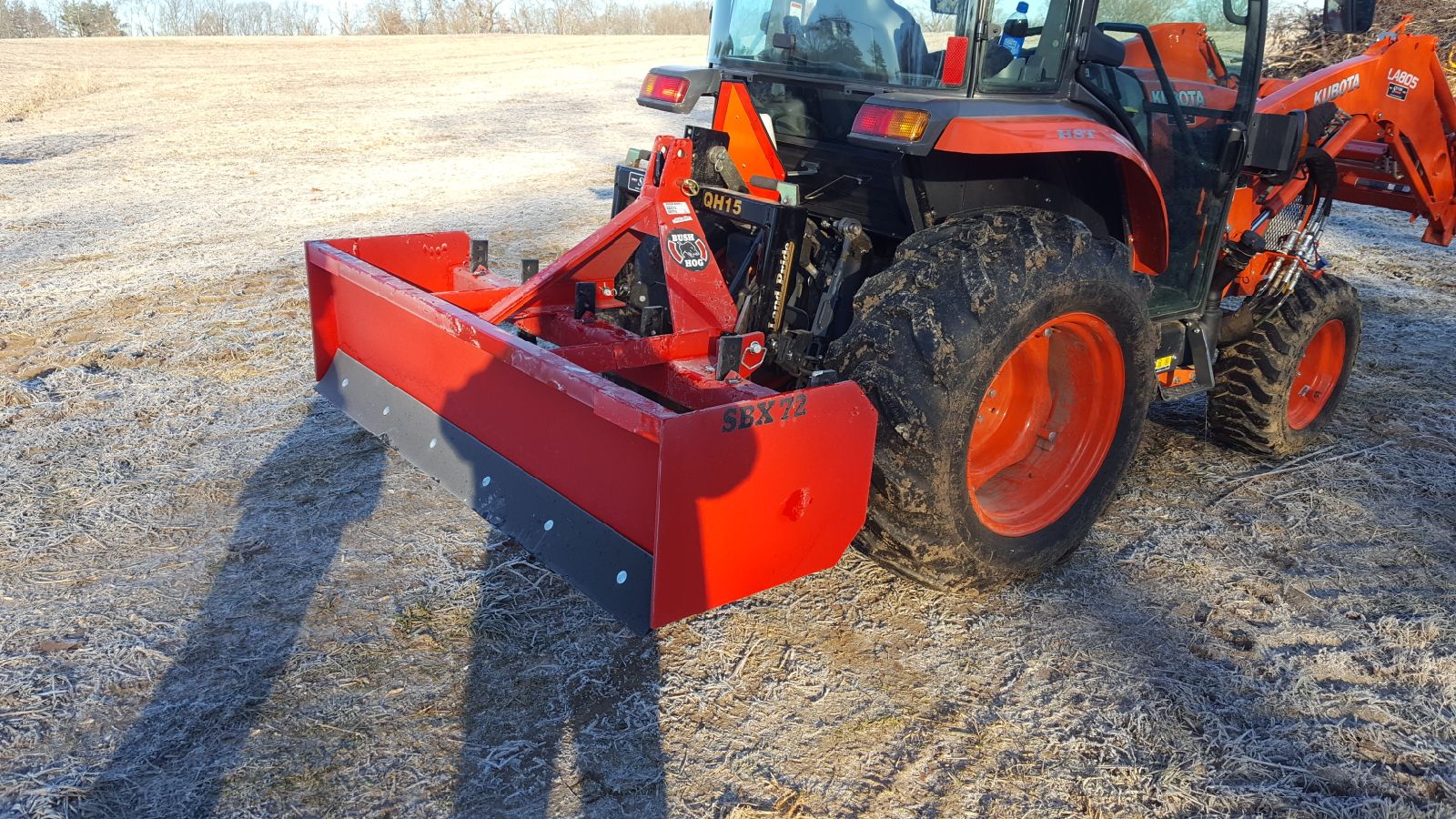

One of the first things I bought was a QH. Got a really good deal on a WOODS. Fits every implement I have. Box Blade, Grader Blade, Straight Blade, Boom Pole and Finish Mower. Works great.
