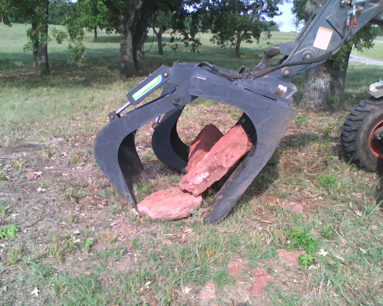

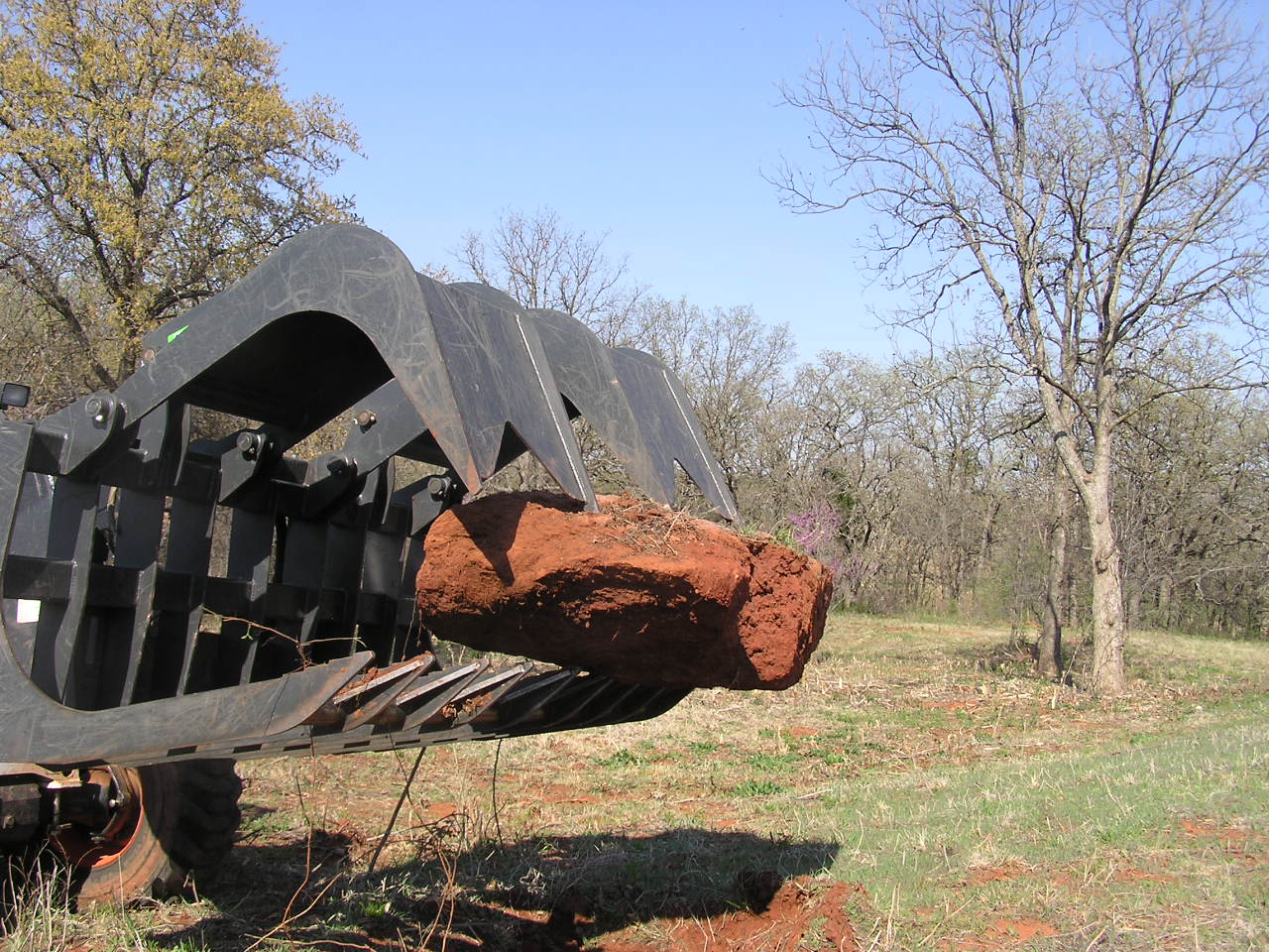

I dig out and pick up a lot of rocks with the open bottom style, also called the L bottom style:

See how Xfaxman sort of "comes down" on the rocks. That's the way I've found to work the best also. Scooping forward with the bottom tines scarfing the ground - most times will result in quite a bit of sod and dirt gathered also. Not what I want. I will rotate the grapple until its pointing almost straight down - open the jaws - come down on the rock or chunk of pine log - close the grapple - lift and rotate the grapple to the full upright position - if I'm going any distance. Otherwise - leave the grapple pointed down and move whatever I've got in the jaws to somewhere else.

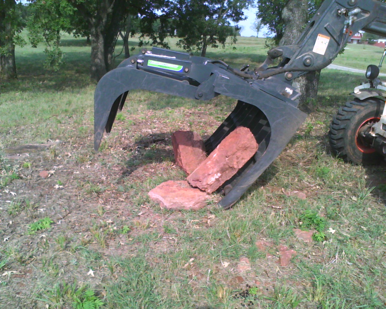

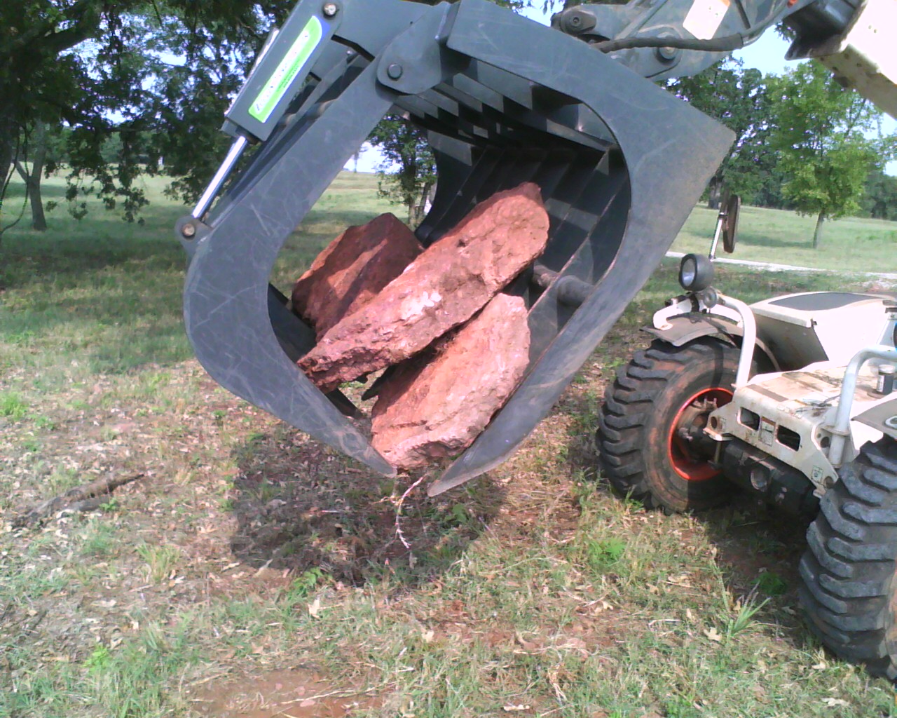

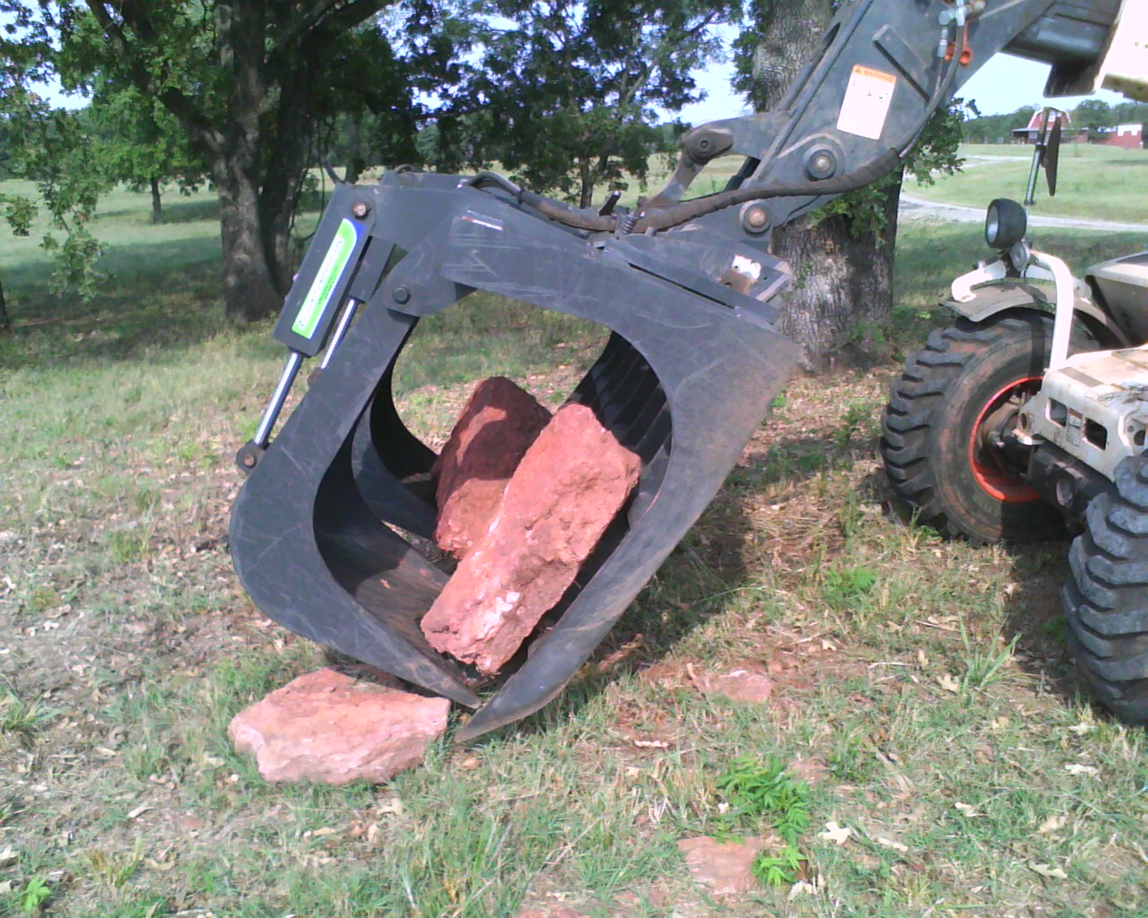

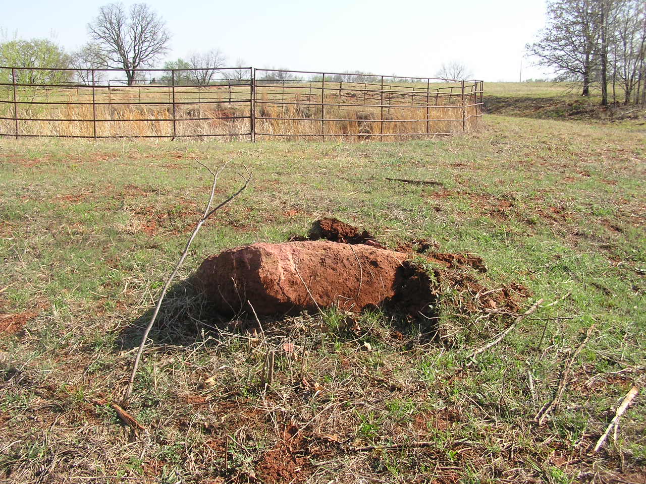

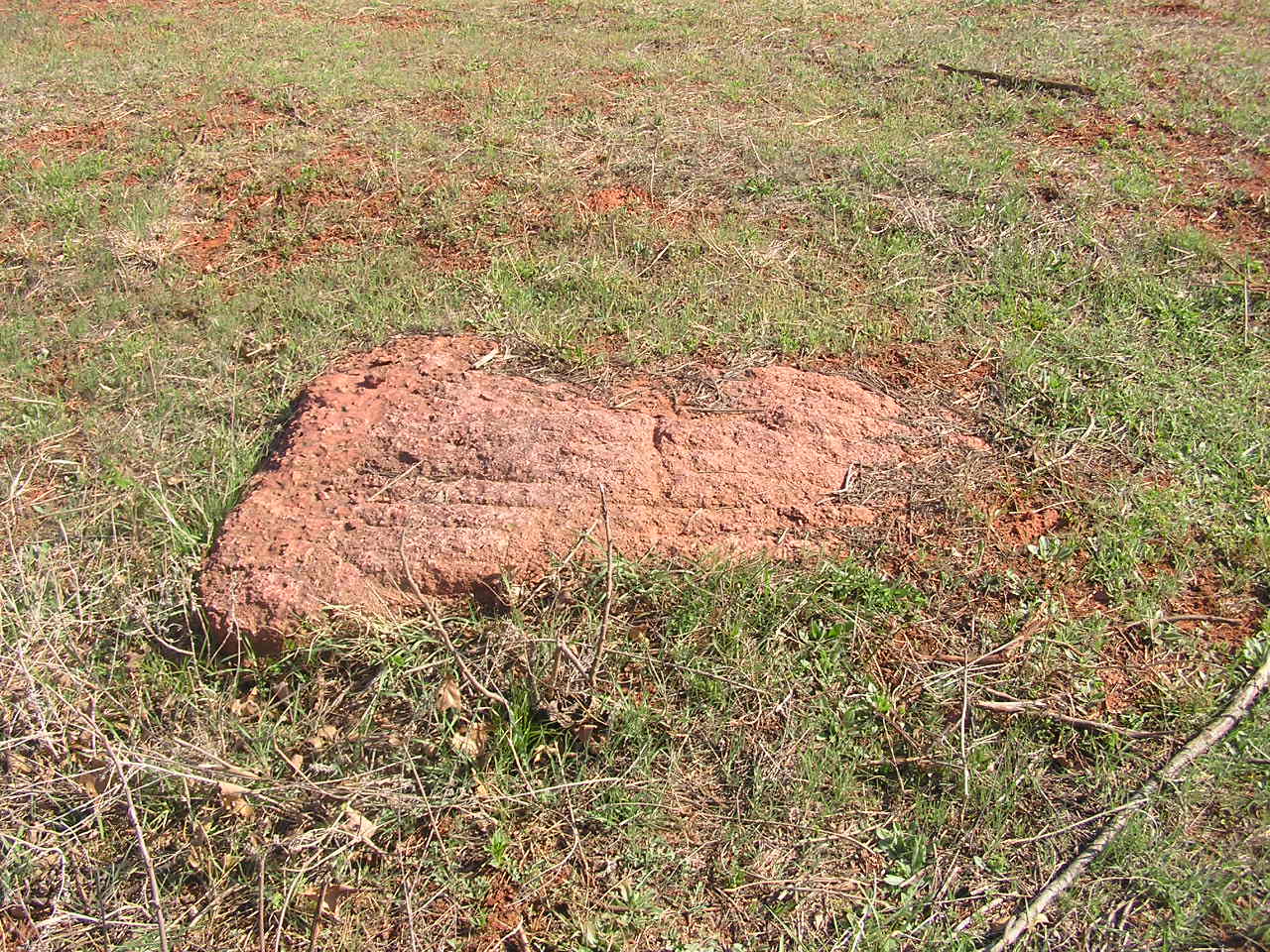

Here is the L Bottom style picking up a large rock, mostly below ground level:
Put the bottom tines against it and popped it up:
Slid the bottom tines under, clamped and picked it up:
Curled up and opened the lids:

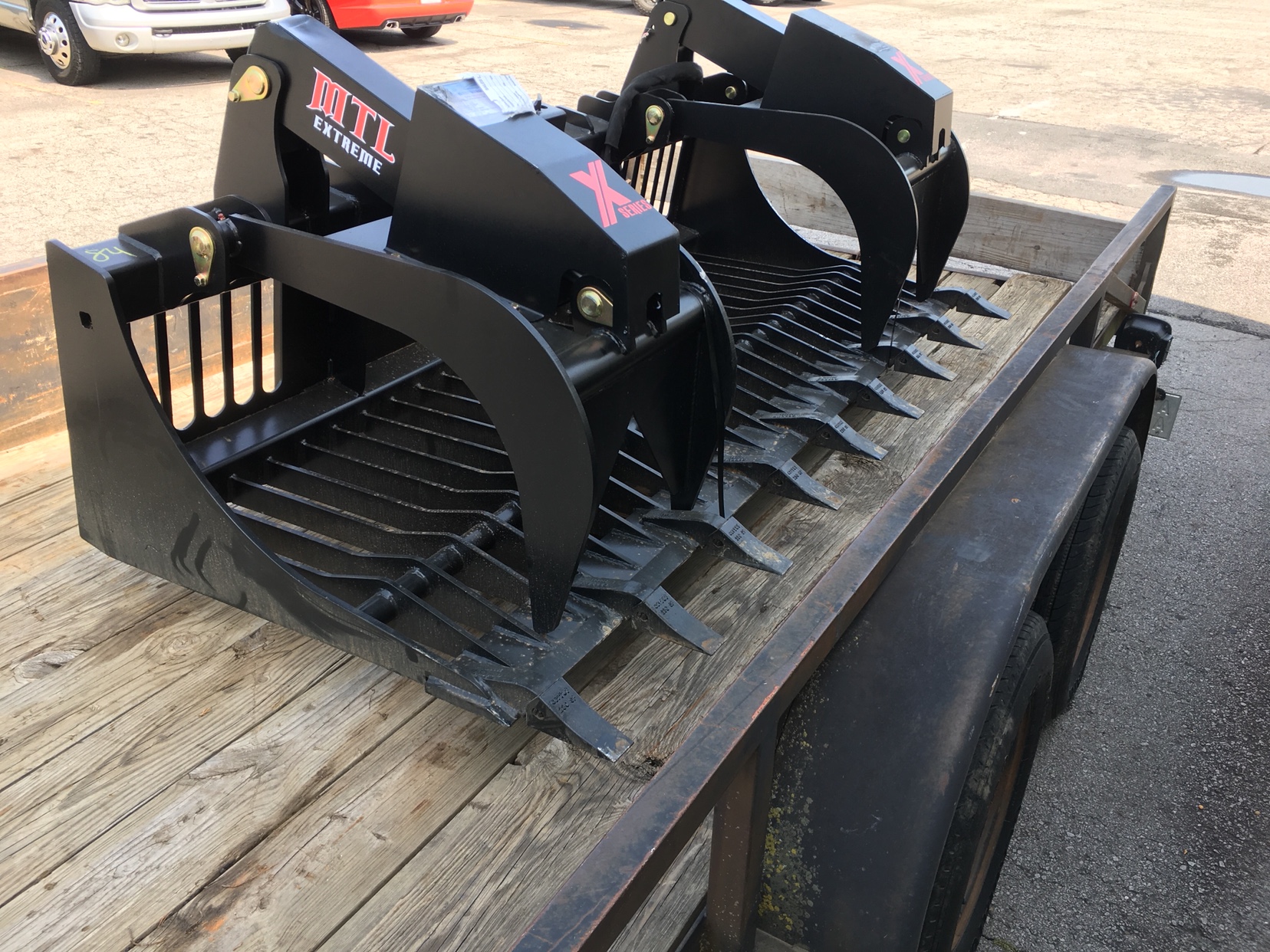

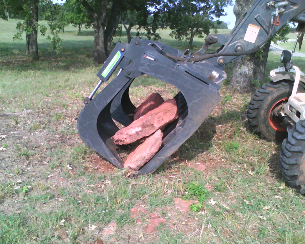

Here is my rock bucket with grapple. And I second the vote on picking up the rocks from above instead of scouping them up. IMG_1631.JPG
/ Questions for the grapple guys #12
There are many styles of grapples. I would not choose a brush grapple to pick rocks. As you can see the L-style that Xfaxman uses works great - so does the rock & root grapple I use. Different strokes - etc, etc. JMHO - but, its not so much the exact type of grapple that will make a good rock grapple - its more the skill and experience of the operator.
