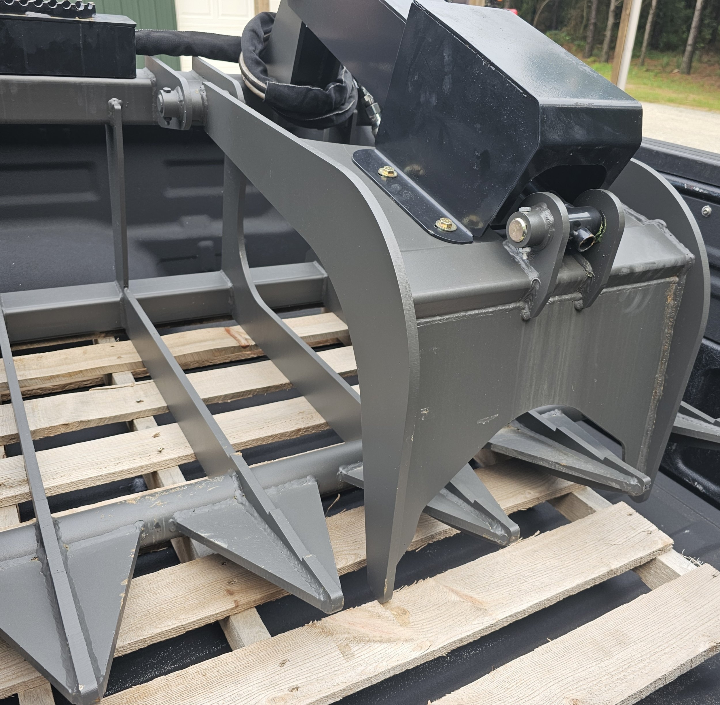

Just got this today...

Just received my 55" Homestead Pinnacle series grapple last week. It's very well made.
