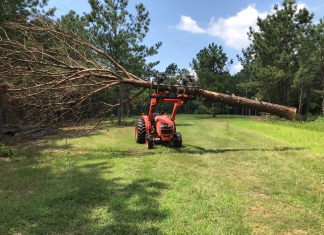

The construction grapple on my tractor

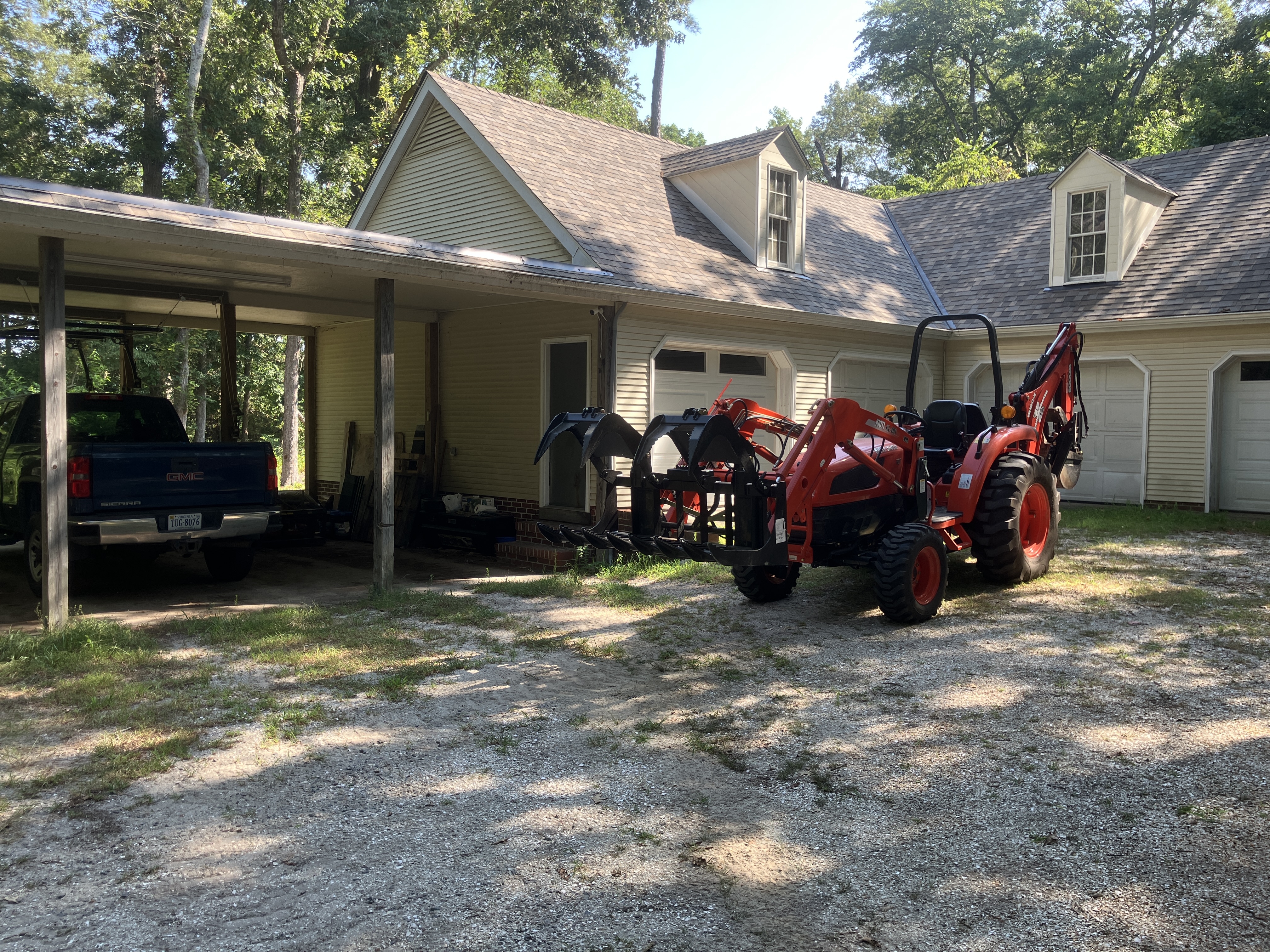

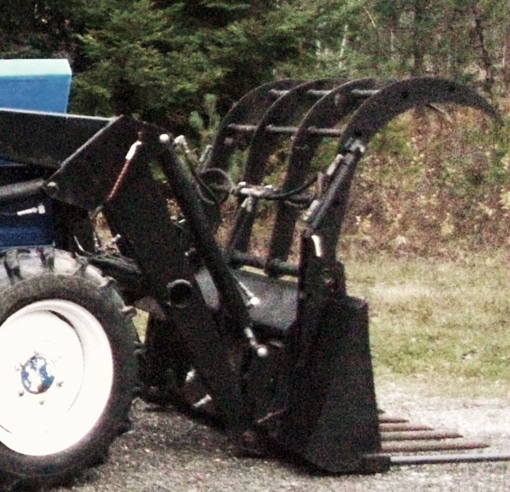

For what you are describing a MTL will work fine for you. I have had a MTL for about 5 yrs and ita done just fine.
