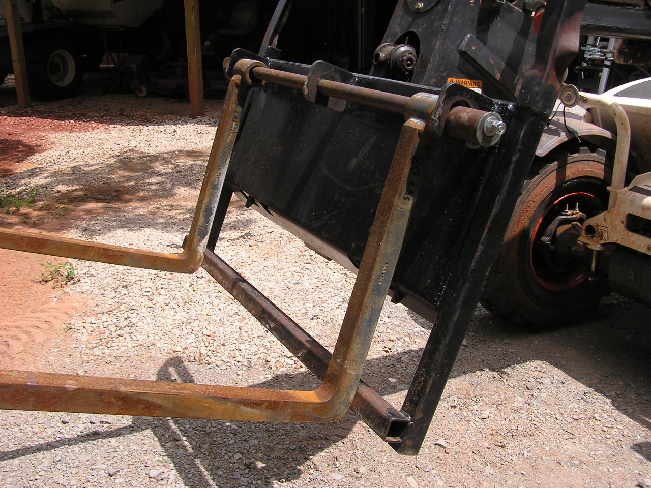

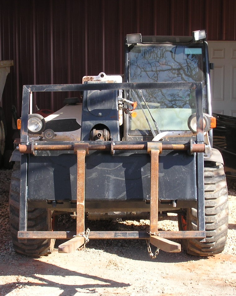

Very interesting. Need more info and pictures of how it latches at the bottom. Did you modify the top of the fork to fit on the Quick Attach?

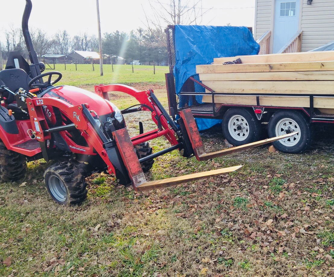

I bought a pair of clamp on forks from Titan with the spreader bar. They work OK but as others have warned, you cannot lift much with them as the load is way out there. My JD FEL is rated at 700 lbs.
For moving firewood, I cannot use them effectively. I use a carry all to move cut down pallets than hold 1/4 of a cord.
They are handy to have for moving empty or lightly loaded pallets, and for moving brush but I find that I need to manually stack the brush onto the forks. As I plan on moving firewood and brush, I will be adding a Thumb bolt on grapple this year.
I would not feel safe using mine as a platform to work from.
If/when I upgrade, I would purchase a QA unit and have both a bucket and fork attachment. I believe you will get tired of removing and attaching pin on attachments so think about that if you decide to go that route. A lot will depend on what your primary work activities are and how often you will want to switch them out.
