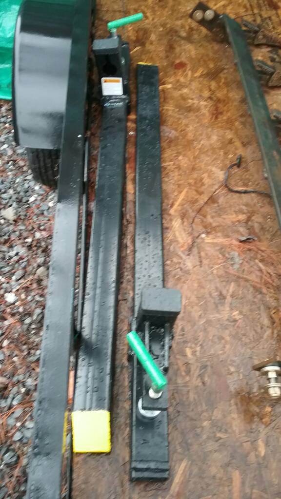

I just received a pair of Titan 4ft. Forks, 5ft overall, $134 with shipping. Looks well made.

I would get the ones with a chain that goes around the bucket. Otherwise you run a real risk of bending the cutting edge of the bucket. I would also get one with a spreader bar to keep them properly aligned.

Here's a picture of the Titan ones I just got.
I do have a tooth bar for bucket and forks are made for a chain to go around bucket if necessary. $134 free ship I couldn't make them for that.20190212_121503.jpeg
