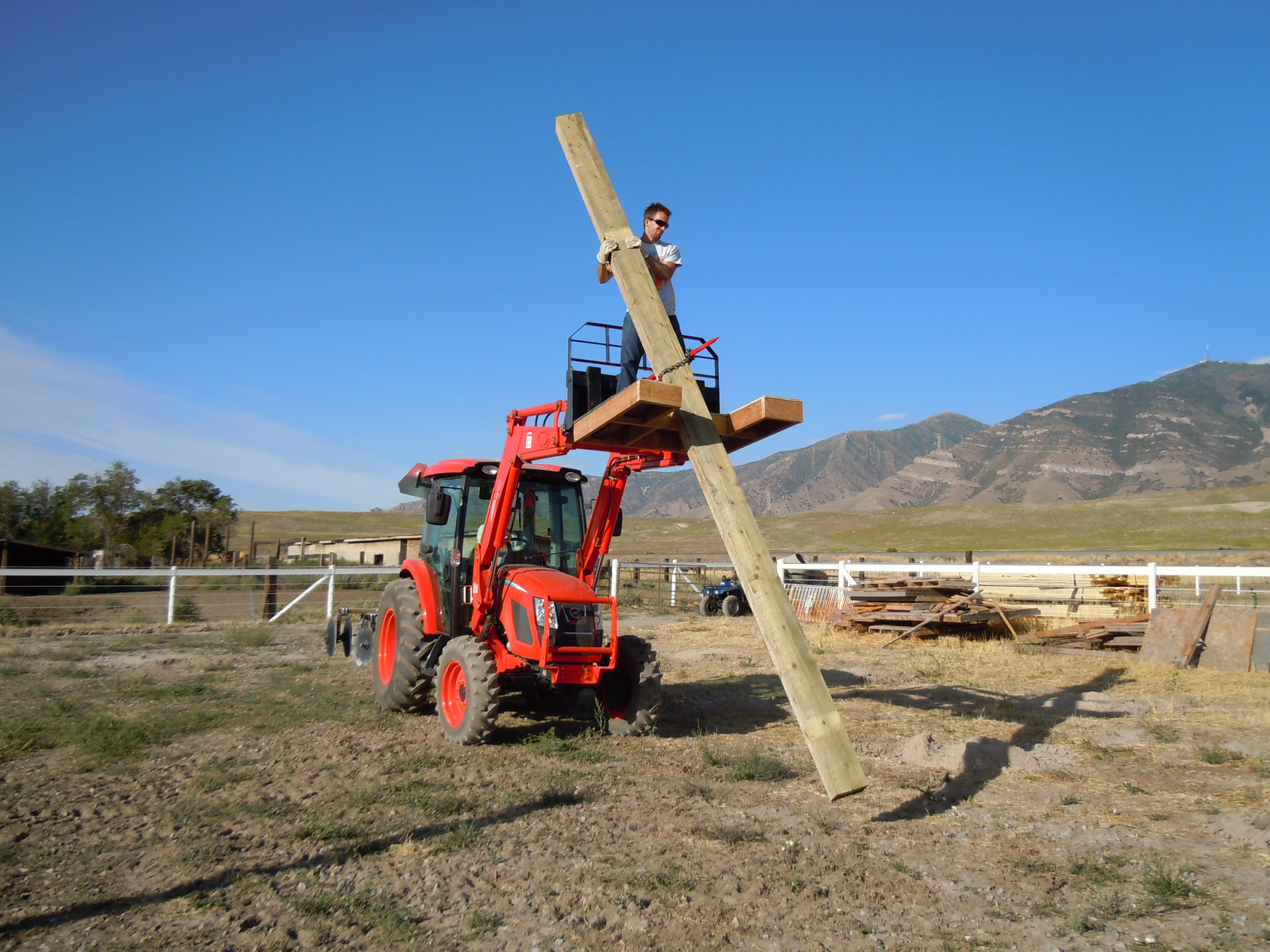

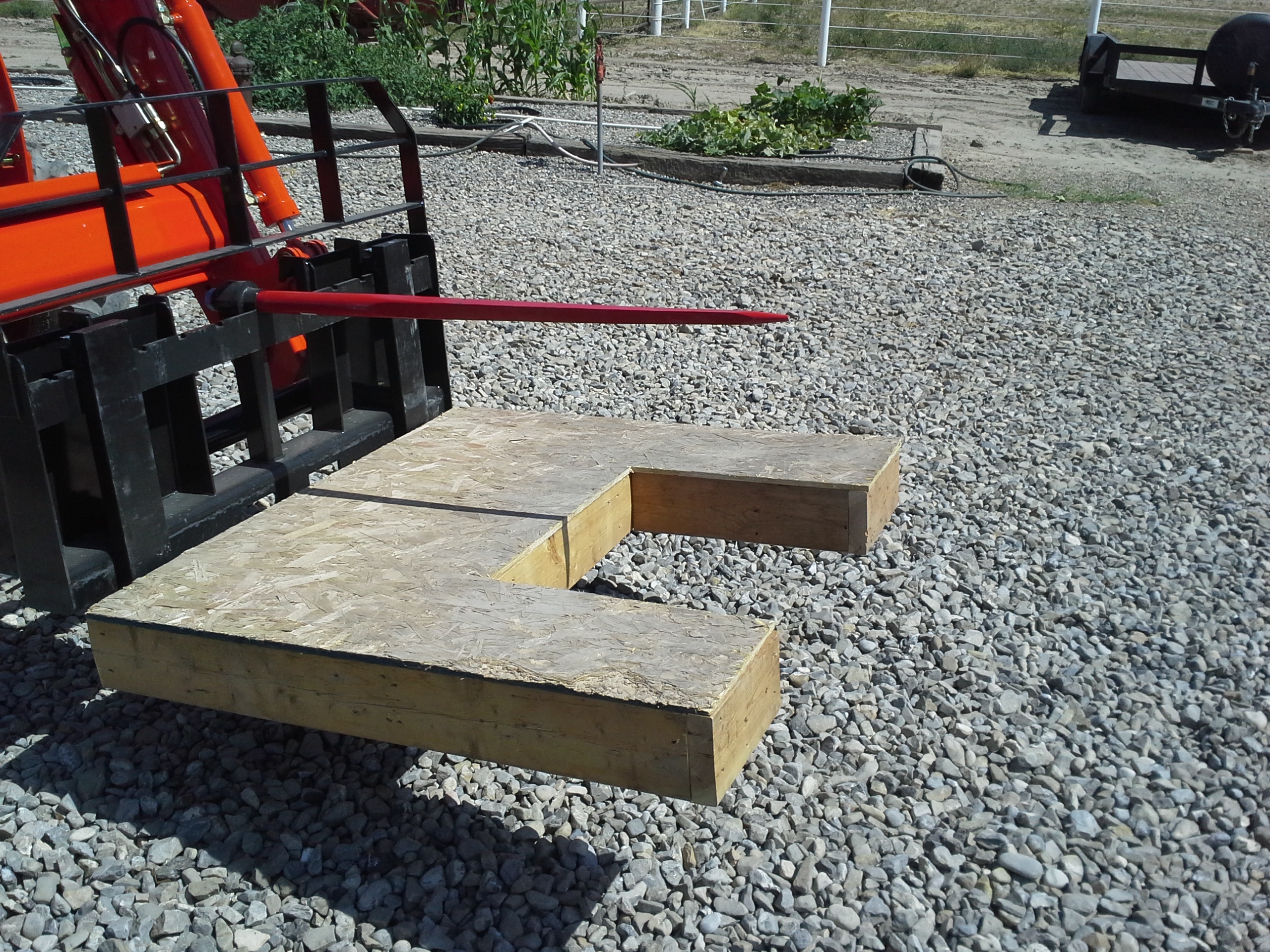

Yes the tractor was running. Most of the time my wife was in control moving the tractor, lifting/lowering me. (I know, very scary) I built that whole barn using the tractor every day. It was a life/time saver. Here is another platform I built for setting post.
This is the main reason I suggest getting pallet forks for the OP they are just to handy not to have.
View attachment 591615View attachment 591616
That's a pretty slick platform for getting a post in place. I'd not seen that before. I could see other purposes for it too.

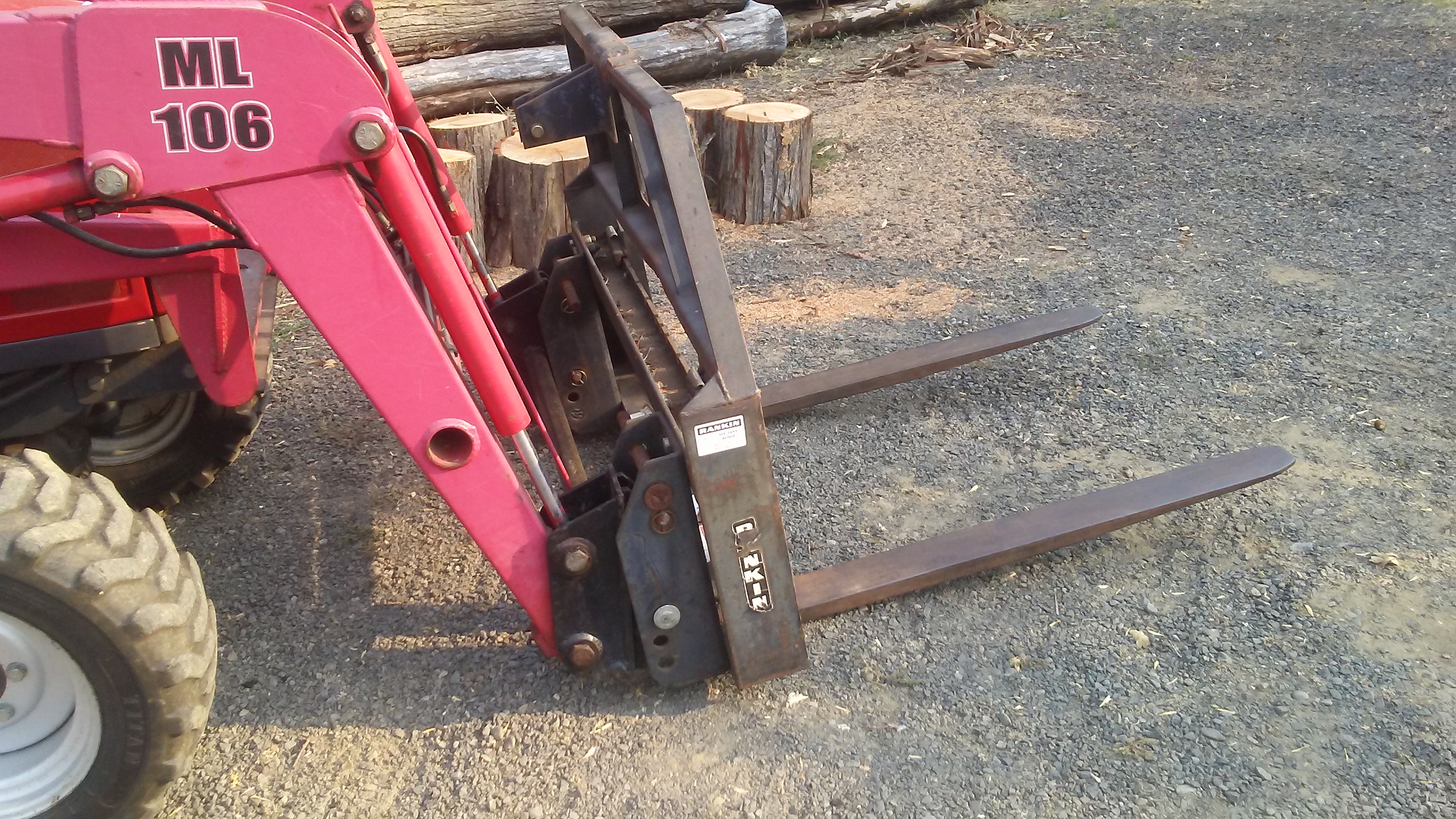

Can I safely adapt normal pallet forks?
Guy in town has several individual forks with just a large hole intended for mounting ... like this:
I have a steel bar I could run through them. Then I'm wondering about a piece of chain over the back and around the bottom of the bucket and hooked to the front edge.

Interesting. You would be relying on the sides and a thinner top than bottom to help support. If your bucket is like mine, the bottom is quite sturdy. I've also added a Piranha ish bar to mine which gives added support. So if you liked the design of the top mount, and it was only light duty- you could. You still are getting pretty far forward there to have much lift capacity. Those style bars -even in light duty would be heavier for the guy installing them than the clamp ons.
set that up with light duty forks.

Those big heavy forks probably weigh 200 pounds each. Your tractor is probably good for 600 pounds on the front of the bucket. That would be a nearly useless setup. You should look into SSQA forks or some other method of fast removal forks that don’t rely on the bucket. Aside from significantly reduced lifting ability you get significantly reduced visibility and run a good chance of bending the bucket.
/ Question on Pallet Forks #51
How did you get onto the platform? Is the tractor running while you are up there? I plan on building a platform for my forks, too. I know I will need to keep my engine running while in the air. Otherwise the cylinders won't hold me up there for very long.
The tractor doesn’t have any feedback or adjustments to the loader. It will leak down regardless if it’s running or not.

Those big heavy forks probably weigh 200 pounds each. Your tractor is probably good for 600 pounds on the front of the bucket. That would be a nearly useless setup.-------------------------------------------
That's the piece I wasn't sure of. I'm not sure if the ones he has are that big and heavy though. Need to find out.
See if he has any Block Forks. These only weigh 80 pounds each:
