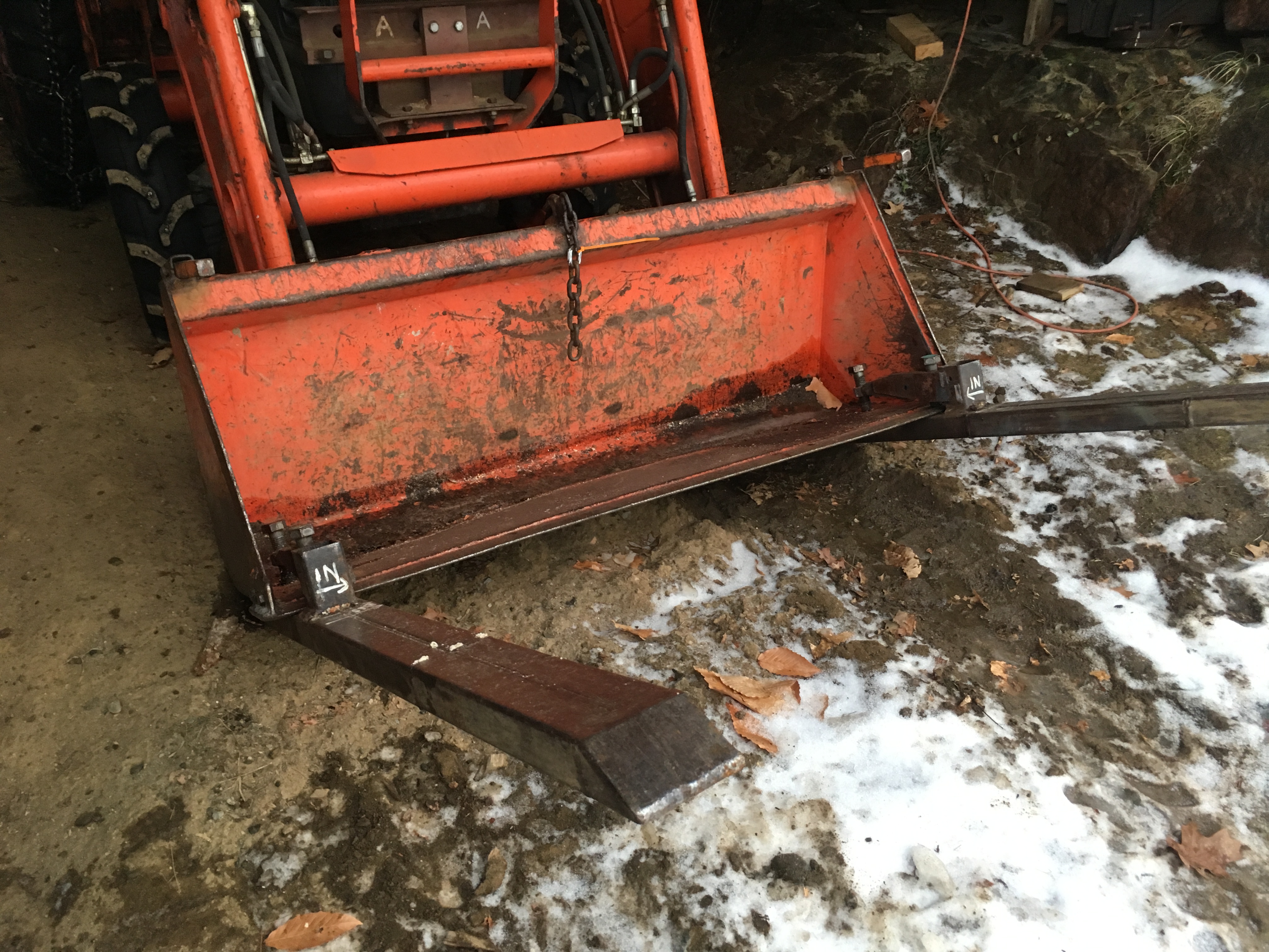

Well I have a set of DIY clamp on forks made from 2 x 3 channel stock that do everything I had planned for.
Many suppliers offer similar products and at fair prices but note that capacities are somewhat limited.
However on a CUT it would be within the limits of most FEL lifting capacities.

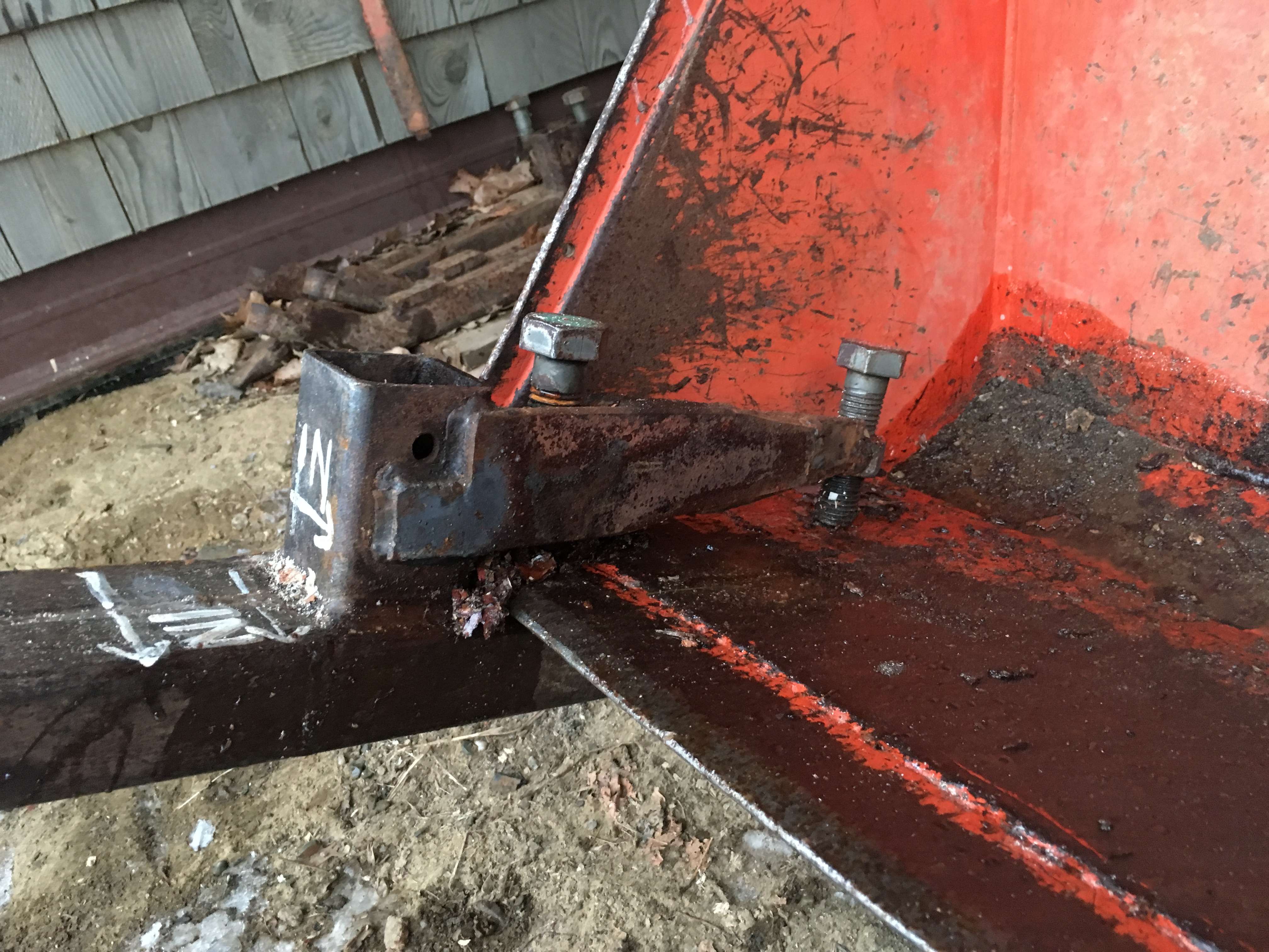

Not saying it hasn't happen but I still haven't seen a pic of bent bucket caused by these clamp on forks..I'm talking on compact tractors.

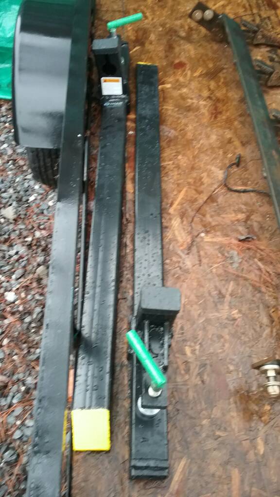

Where could I get the type of clamp screws they use if I needed them? I can use standard bolts and nuts for a prototype.
My first thought would be acme thread. A great hardware will stock the thread stock and nuts. You can I think buy bench vice kits for these wood working vises. Either that or destroy a cheap c clamp and see if the thread is standard to where an acme nut will fit.
I'm starting to believe that some of this talk is like the kid diving in rock quarry and was bitten 100 times by snakes
When I bought my NH the guy showed me how he had to repair (reweld) the bucket from the guy before him using clamp on forks. Pretty sure it is now stronger than ever but can still see indentations on the cutting edge of the bucket.
/ Question on Pallet Forks #26
I think the clamp on forks are an excellent way to bend your bucket cutting edge. Save up and get a regular set of pallet forks. In the long run you'll be happier. :2cents:
I personally have a set of Titan 42", I use them as much as I do the bucket if not more.

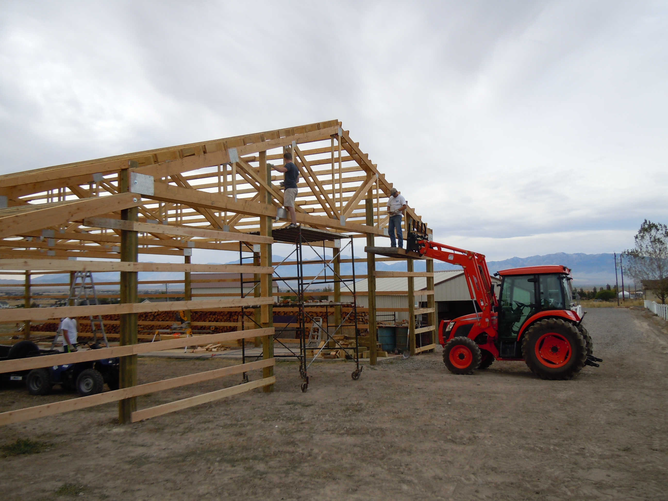

How did you get onto the platform? Is the tractor running while you are up there? I plan on building a platform for my forks, too. I know I will need to keep my engine running while in the air. Otherwise the cylinders won't hold me up there for very long.
Yes the tractor was running. Most of the time my wife was in control moving the tractor, lifting/lowering me. (I know, very scary) I built that whole barn using the tractor every day. It was a life/time saver. Here is another platform I built for setting post.
This is the main reason I suggest getting pallet forks for the OP they are just to handy not to have.

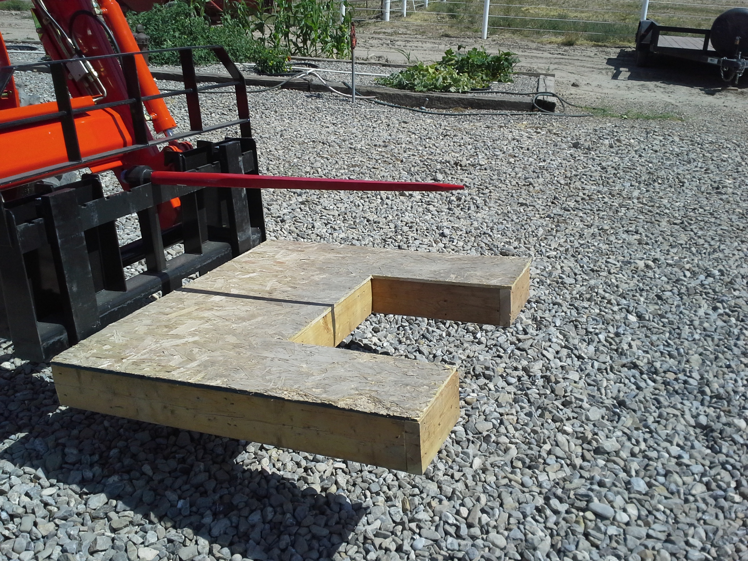

There are a couple of threads talking about using IBC Totes for work platforms. Plastic pallets with metal cages that act as railings with one side cut open as a door. I have one made up and ready to go for various things including trimming some taller hedges. For the time being, I can turn the FEL bucket up and strap the tote on top of it with ratchet straps. It won't lean at all that way. Use a short ladder to climb in once it''s in position.
