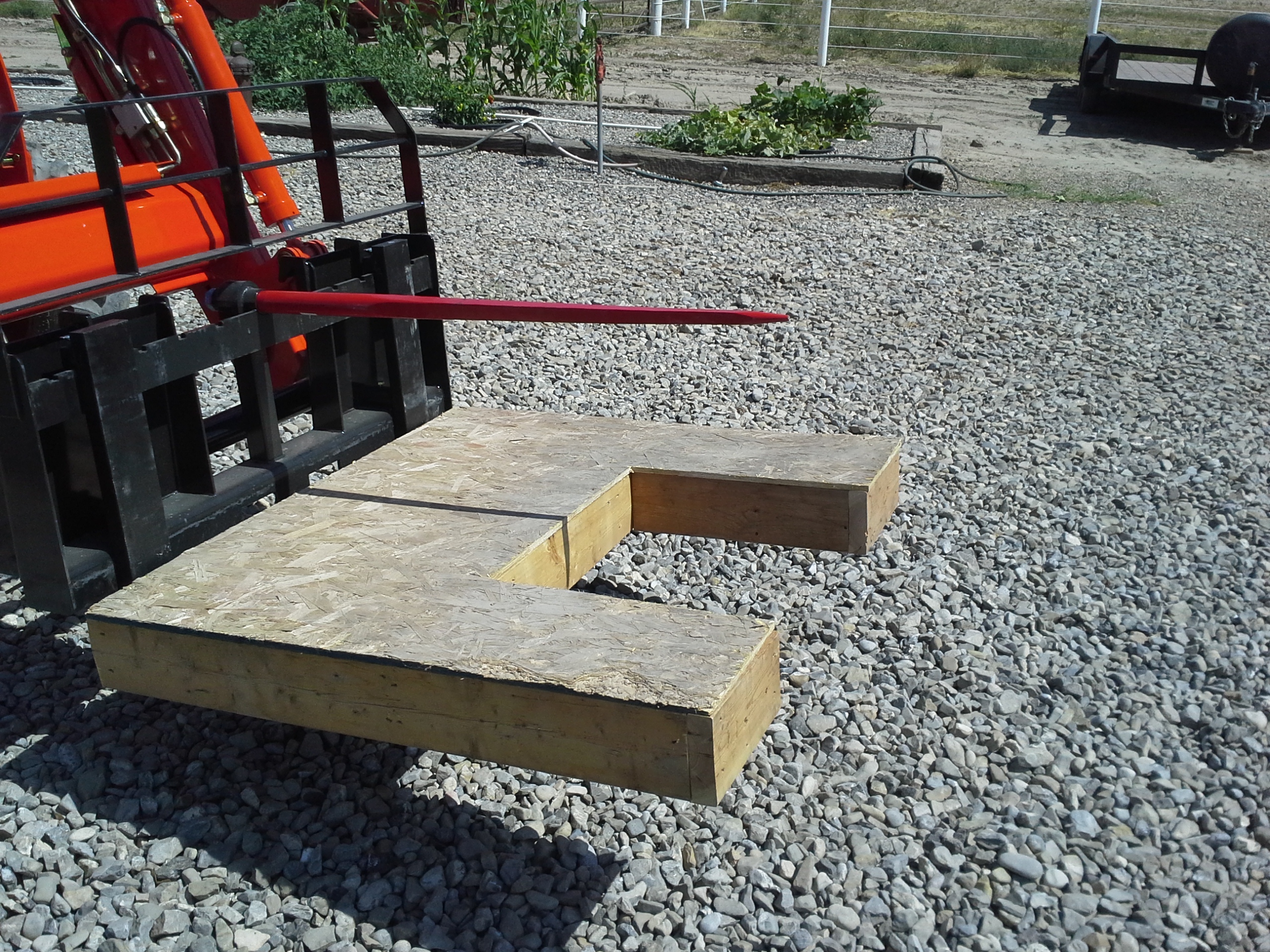

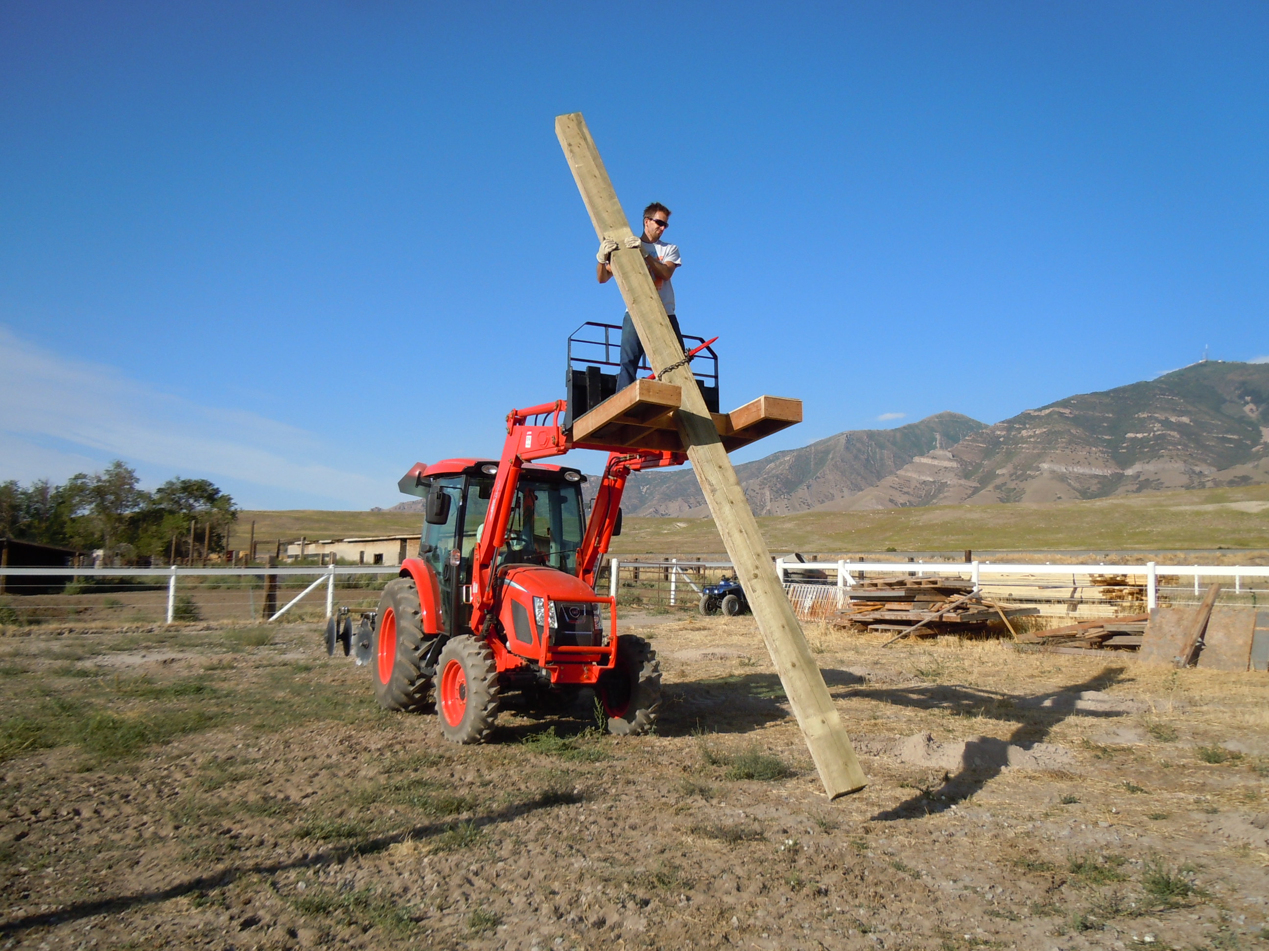

As far as a work platform, I may not use forks for that. I have a way to strap it on top of the fully upturned FEL bucket that seems safe. Also remember I have the BH and outriggers. The plan would be to extend the outriggers and dig the BH bucket into the ground behind me for extra stability.

A thought may be to design a firewood carryall and work backwards from there. Think of like a metal framed wood rack 50" X 18" or so wide which would use short standard forks or maybe even forks that could easily be bracketed to your bucket's sides rather than just the bottom. Mount the lift arms vertically for more strength so you could use a heavier 3" C channel which would slide into a larger rectangular tube on the rack. This would save weight and could very easily be pinned for the hybrid quick attach. Once you have a system penciled out, next could be your lift platform.
In my world I've been just moving wood around in partially filled IBCs, but really would rather bring a rack at a time up by the house and hopefully just make a covered area off the new deck which is going to go up this year.

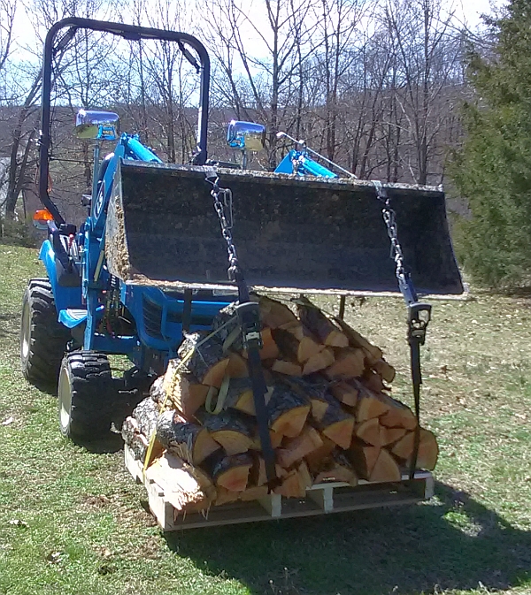

Who needs pallet forks when you can sling'em around? NOT the way I'll be doing it normally, but it works for now to position a few a short distance. Low (just off the ground) and slow. Worked fine. Yea, I know the one strap is in too far, but it was the first one as a test. The other two worked fine also. Under the bucket instead of out in front might be better though.
Pallets are cut in half to make them easier to stack with irregular firewood, so there's a lot less weight to begin with.
Very clever! You could throw a few more in the bucket! :D
Hey, it worked and was pretty clever and center of gravity was kept low and safe.

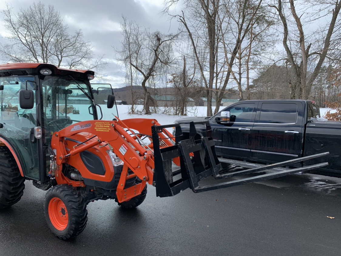

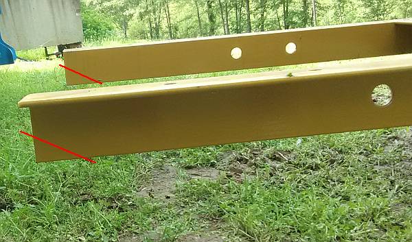

So, I sprung for a carry all, but came up with a couple of new problems. First, the 'forks' are wider than some of the pallets I have. Guess I'll continue to sling those for now.
Other thing is that the front bottom corners catch on the bottom slats of pallets unless you're dead level and square. Only thing that comes to mind is to cut or grind an angle on them (red line in picture). If I do that, it's non-returnable. Anybody have any other ideas?

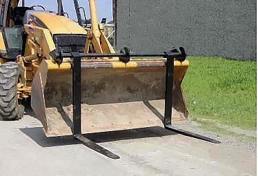

A couple of comments on buying clamp-on forks:
* Get the optional adjustable-length bar that goes across from one fork to the other. It prevents the forks from turning sideways.
* If you have a small bucket, measure the depth of the 'throat' that clamps on the bucket. I got a set of forks with the second YM186D that bumped the back of the bucket before engaging fully. (Sold those forks for what I had paid for a previous set).
* I see forks on Cragslist at second-tier tractor dealers that are priced double what I paid for the same forks listed on Amazon and shipped from the manufacturer. Shop around!
* Three-point forks for the back of the tractor are handy. I built a set after studying the TSC version. I can back into it with the QH, pick it up, and go. I use this far more than putting on the front forks. Photo. Photo2.
A hydraulic top link is almost a necessity for picking up pallets.
Since you don't have QA, I would return it and get an adjustable pallet fork: 3pt adjustable pallet forks - Image Search
