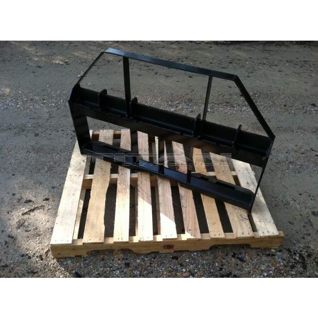

Do what I did, made some pin on forks:

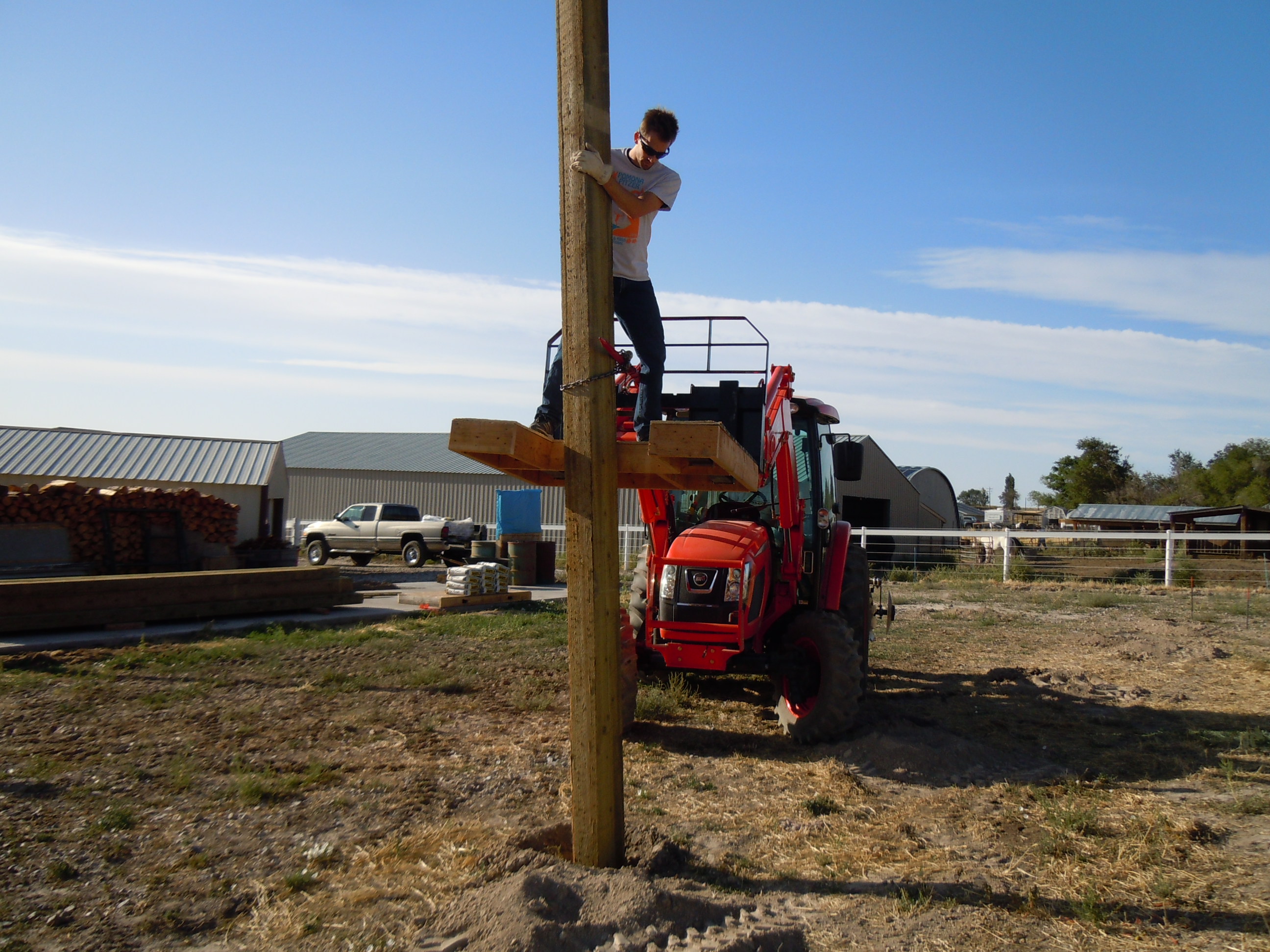

I moved an incredible amount of stuff with my 770 and clamp on forks. In fact, those forks were rated for about 4000lbs and meant for a tractor backhoe or wheel loader, so they were heavy.
The only issues I had were ballast related. The model 70 loader (which is no power house) had enough power to move the pallets to a usable height, but i was constantly fighting tractor instability. Never had any bucket issues but mine was rebuilt by a pro a long time ago.
I moved my father's entire company by using that combo and loading seven 53ft trailers! Full to the ceiling! Took me months of weekend work.
Some things to consider(I'm probably repeating for the million-th time):
- The load will be placed pretty far out. mine was at least 4 inches beyond the cutting edge. Even light weigh will may the tractor very unstable, so be careful.

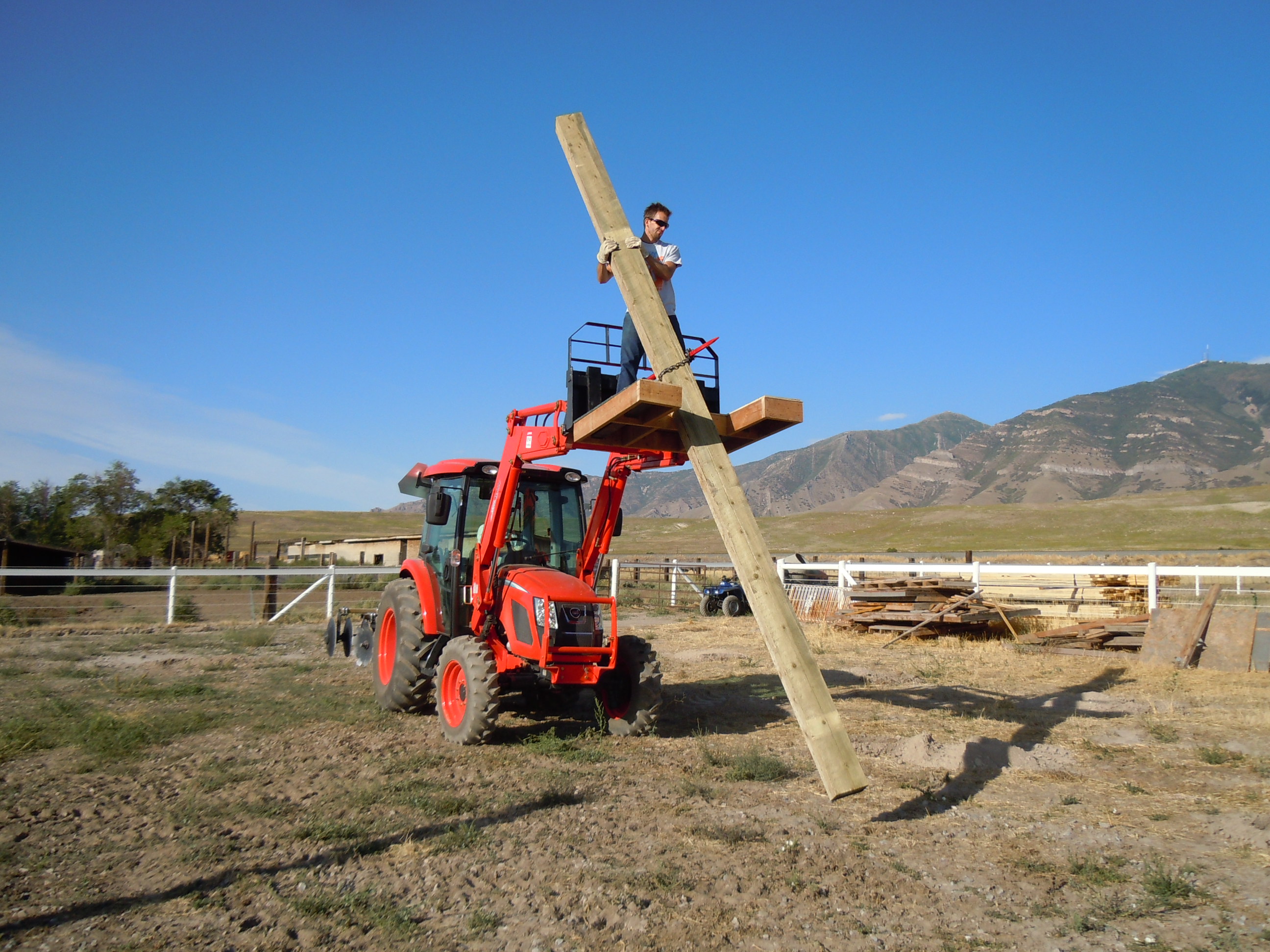

- Don't use this as a work platform! My 770 is a little bigger that your machine. I tried this and nearly flipped the tractor over. I thought I had it well ballasted. Probably was fine front to back. I walked to the far corner, opposite rear tire lifted, pivoted on the front axle... you fill in the blanks. No permanent damage and no injury only due to extreme luck or divine intervention.
- The clamps will hold tight, but the ends always seem to move laterally. Especially when you don't want them too. A bar to hold them would work, but you'll lose adjustability.
- Don't try to poke things with them. Solid folks can (shouldn't) dig a little. These cannot.

Yeah the last thing on earth I would do is put a man lift basket of some kind on a set of clamp on forks. And it might just be the last thing on earth you do. Man that scares me just to think about it.
