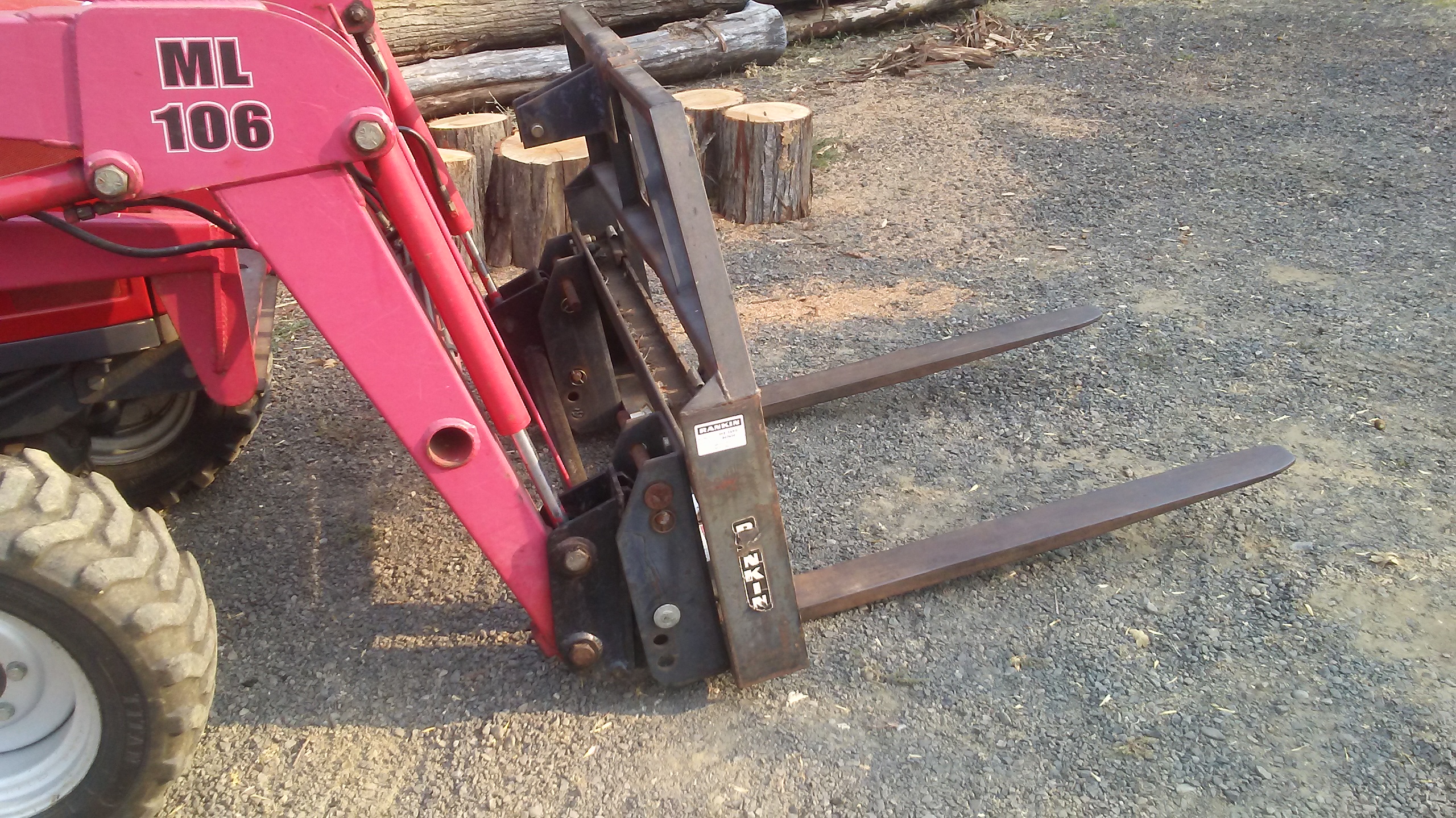

I don't even know if any type of QA gizmo is possible for these littler machines, but even if they are, I'm pretty sure they'd cost more than a set of forks. Kinda wish people would move away from that angle.
Notice the black, pinned on, quick attach adaptor, between my loader and forks. I purchased it in 2010 from my Mahindra dealer for $425.55. It takes 5-10 minutes to change from forks to bucket. It was manufactured by KMW, Kansas Machine Works, part #1304-2043.
I don't know how much it weighs, but I do realize it reduces my lift capacity. I also realize my heavy duty Rankin forks do too. The are rated at 3600 lb. capacity, and are very heavy. More than I needed. But they were the only ones my dealer had, were kind of in his way, and I got a great deal on them, $795.00. In the first photo you can see the modifications I made so I can use them on the 3 point hitch.

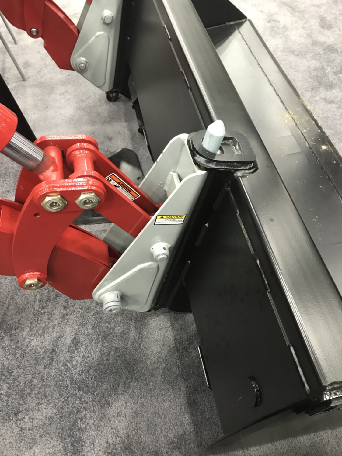

Here’s a mount I saw at the farm show that looks pretty similar. IMG_1468.JPG

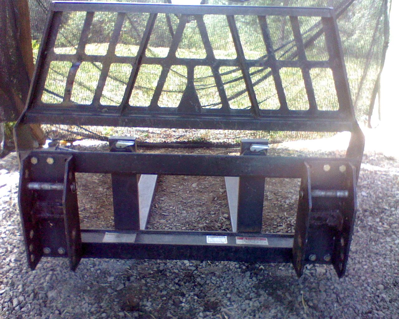

Very interesting. Need more info and pictures of how it latches at the bottom. Did you modify the top of the fork to fit on the Quick Attach?
I will attempt to post pictures when the rain here stops. As for info; these are Class II Forks, 16” channel to channel. Each fork is 7,500 lbs rated. The top channel sits atop of my QA top section and the lower channel sits just inside the opening. I cannot do any pulling or prying, but forks are not designed for that to begin with. The QA is what my RK19 came with from the factory.
   / Question on Pallet Forks #78
I will attempt to post pictures when the rain here stops. As for info; these are Class II Forks, 16 channel to channel. Each fork is 7,500 lbs rated. The top channel sits atop of my QA top section and the lower channel sits just inside the opening. I cannot do any pulling or prying, but forks are not designed for that to begin with. The QA is what my RK19 came with from the factory.
OK that answers my question. They aren't latched, gravity holds them to the QA.
A lot of places sell just the Class II frame that your forks would fit on:
