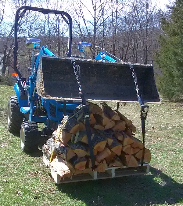

Who needs pallet forks when you can sling'em around? NOT the way I'll be doing it normally, but it works for now to position a few a short distance. Low (just off the ground) and slow. Worked fine. Yea, I know the one strap is in too far, but it was the first one as a test. The other two worked fine also. Under the bucket instead of out in front might be better though.
Pallets are cut in half to make them easier to stack with irregular firewood, so there's a lot less weight to begin with.
Very clever! You could throw a few more in the bucket! :D
Hey, it worked and was pretty clever and center of gravity was kept low and safe.

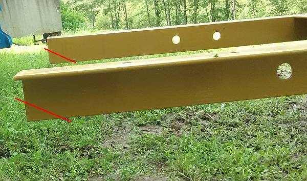

So, I sprung for a carry all, but came up with a couple of new problems. First, the 'forks' are wider than some of the pallets I have. Guess I'll continue to sling those for now.
Other thing is that the front bottom corners catch on the bottom slats of pallets unless you're dead level and square. Only thing that comes to mind is to cut or grind an angle on them (red line in picture). If I do that, it's non-returnable. Anybody have any other ideas?
A hydraulic top link is almost a necessity for picking up pallets.
Since you don't have QA, I would return it and get an adjustable pallet fork: 3pt adjustable pallet forks - Image Search
Are you offering to pay the difference? Lowest cost I can find is $300 and EA wants over $800 (why do people buy their overpriced stuff?)
For $300+, I'll go back to tossing wood chinks in the loader bucket.
