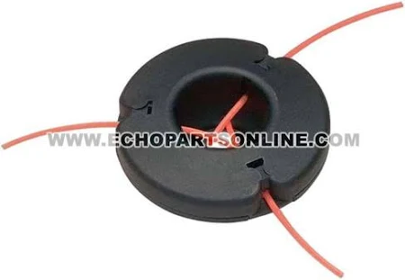

We always had trouble with wind-up spools and ended up with this one for idk the last 15 years:
You cut three pieces of line about 8" long, stick one end in from the outside and use it until it's gone. Then with pliers grab the line from the inside and yank the rest of it (if there's any left) through and then stick another three in.
They also make 2-line version going down to 0.080; the one we use works with 0.155 and likely smaller as well.
In some ways it's not as convenient as an auto feeder, but you don't have to rely on that autofeeding which probably makes it more reliable.

I use the Stihl Tri cut head myself, no trimmer line required. The Tri cut head uses 3 swinging and easily replaceable hard nylon 'blades'. Much less overall expensive and no pesky line to deal with.
The Stihl head fits my Echo just fine btw.
