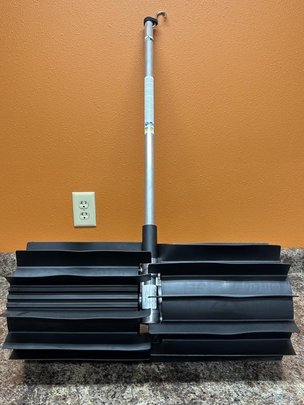

I have been eyeing that paddle.
It's great, takes 90-95% of the gravel off my grass come spring a lot easier than raking. Naturally as long as you haven't walked it in. Gets about 80% of the pine needles as long as the grass isn't super long. Both instances work better if the grass is wet, just after a rain for example or morning dew.
No signs of wear on the actual paddles and I've had it...over 7years. The only place I did put a bit of reinforcement was where the ends of the paddles hit the aluminum shaft as it was starting to lightly groove the shaft slightly. Would it have worn thru? I don't think so but I figured why take a chance.

That's it - it's actually called a "power broom". It works great on sidewalks and driveways if you would rather broom than leaf-blow. Also works good as a power squeegee if you need to get water out of your garage (but it can throw it out the front so don't let anyone stand in front of you unless they want a shower ;)).
We also use them for hardscape installs. After you set concrete pavers you need to sweep sand in the joints before you compact them. We used to do it with good old-fashioned wide push brooms, but these power brooms have made it easier and much more efficient!
