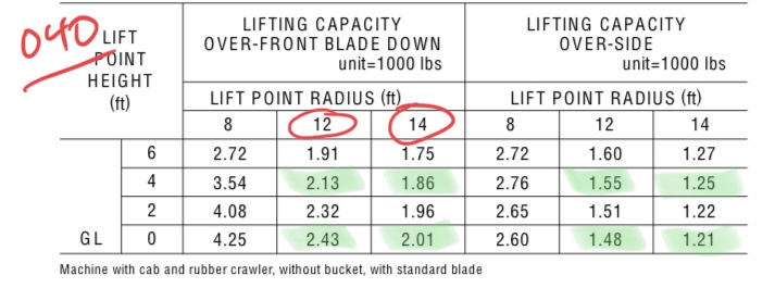

Also the lifting capacity is about 500lb better on the u48 over the 040, and more than a 1400lb better on the tb250. How does Takeuchi achieve this with same weight and hp…

So does the u48, they both weight about 1500lb more.
oh, dumb me. This is over blade. I haven’t tried to lift 5600lb over blade. I assume the boom would lift but rear will come up? Is that your thinking? with my 5’ gravel bucket it will tip wile loading bucket with boom stretched out Blade up, not tried with blade down as I’m usually just grabbing and going.
   / Question about hydraulics performance on different excavators. #28
The 48 doesn’t have any more boom than the 40 does. The 250 and I’d assume the 50 Deere has a little bit bigger boom.
