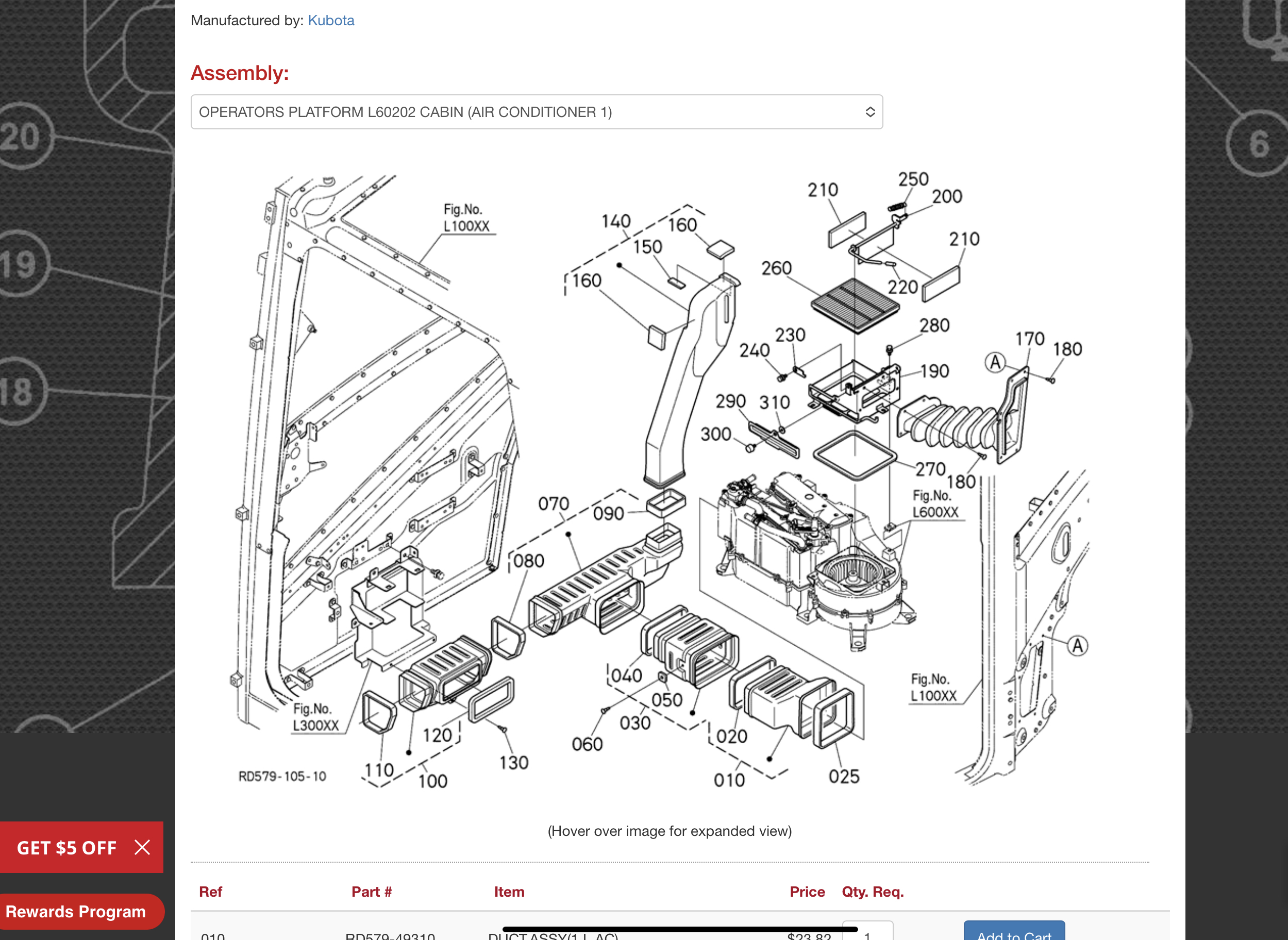

I have looked at deeres. I dislike the cab, didn’t run it. I would gain reach on the 40 and 48 and performance over 40 with Takeuchi but I talked to some footer guys I work around and the hvac intake is at your feet under the seat. Said it sucks dirt in and it’s a $4k repair to have dealer take out and clean or replace because the unit is buried. They actually had external house filters taped up to help keep the dirts out.
Here’s kubotas new hvac design. Notice how it sucks from outside, with a circulate that only adds about 50% of the airflow. The filter is good and heavy, nothing like what’s on your 40. My current 40 uses a svl filter.
I’m quite good with the kubota. It’s a little more than a lateral move and it’s more expensive but its just money. I’m partial to certain brands. I’ve been driving ford diesels exclusively since ‘97. Im on my 10th superduty. I stay with what I know. I’ve had a bunch of kubotas, still do.

Is this new system on 2020 KX-040 cab machines?
