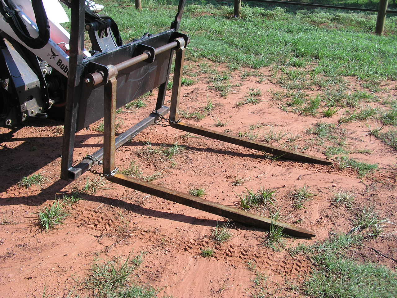

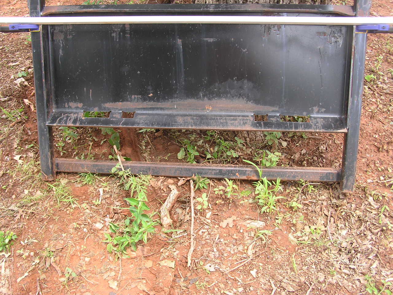

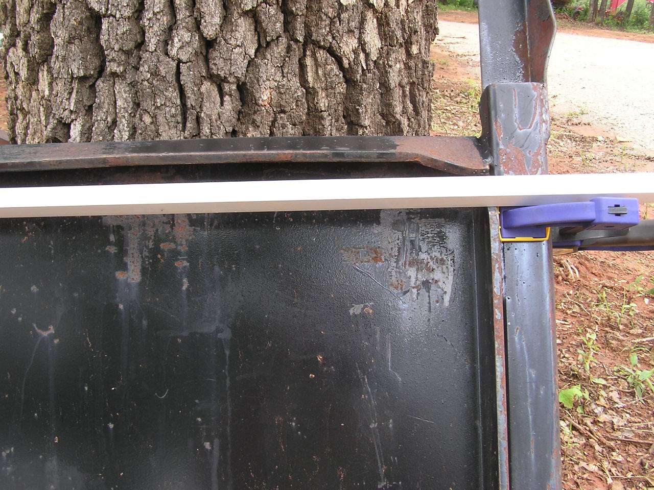

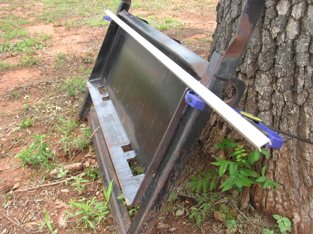

I'm thinking of building a ssqa pallet fork attachment. I'd weld lugs on a qa plate, run a bar through, and get forks from a scrape yard. I noticed the plates on ebay were 1/4", 5/16", 3/8". What thickness should I use, and could anyone recommend an ebay dealer who they dealt with?
The thickness depends on the lifting capacity of your tractor, but since you didn't put that in your profile or tell us in this post, I don't know what to recommend.
I can show you what happens when they are too thin. :thumbdown:
Had too much weight on the forks, the straight edge shows where the 1/4" thick top lip bent up as it popped off of the SSQA.

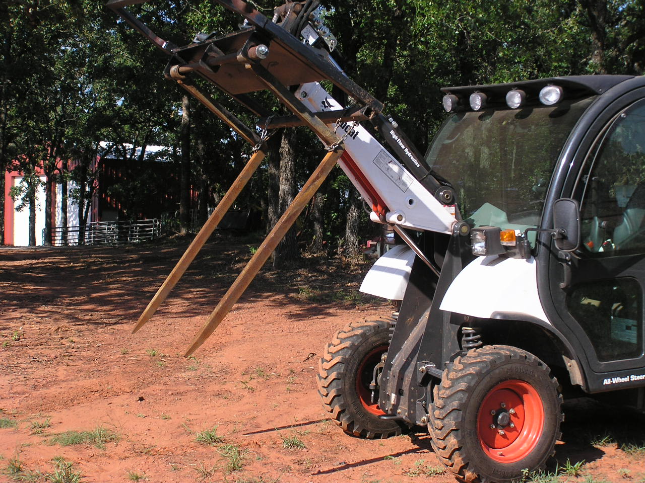

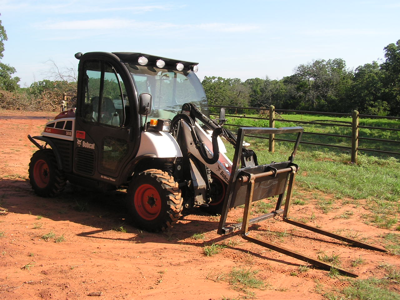

On the Toolcat after getting straightned.
