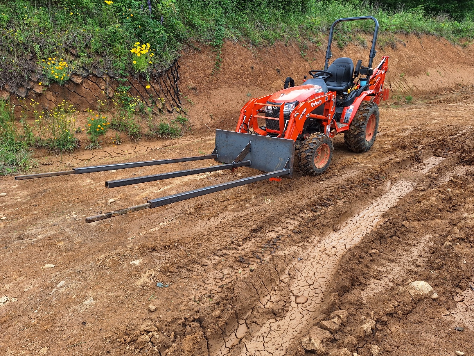

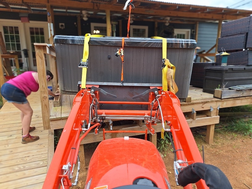

So I had to move the hot tub about 600 ft.

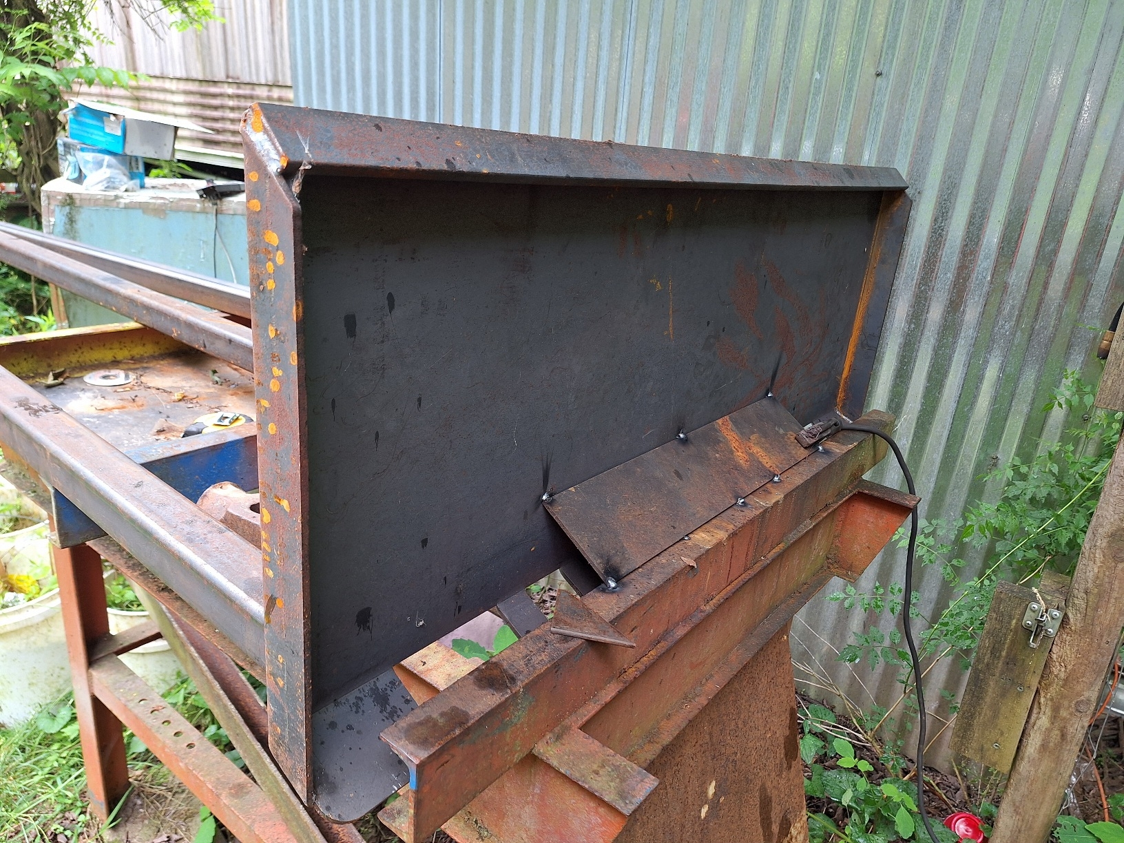

Grabbed the QA plate I made to move the old chicken coop and ground off the angle I had tacked onto it.
I then tacked it to table to use as a fixture

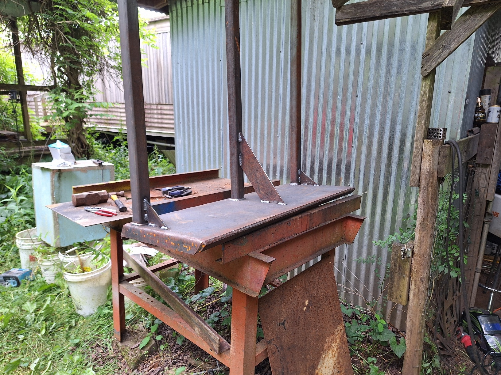

Then added 3 pc of 2'x2'x1/4"x8' wall tubing I had in an old Trooper.
I had to make a taller brace for the middle fork due to flexing of the QA plate, since it had no support
Then I grabbed 2 pcs of 1-1/4x1-1/4x3/16 wall 5 ft long to add "adjustable extensions to forks"
worked great
Worked great, used several strategically placed straps, we have some more big things to move and then I will use it for brush until I build a grapple
You can see how I used the straps to lock everything in tubing to QA plate and then a strap between them two and another one to tension everything tight, it never moved

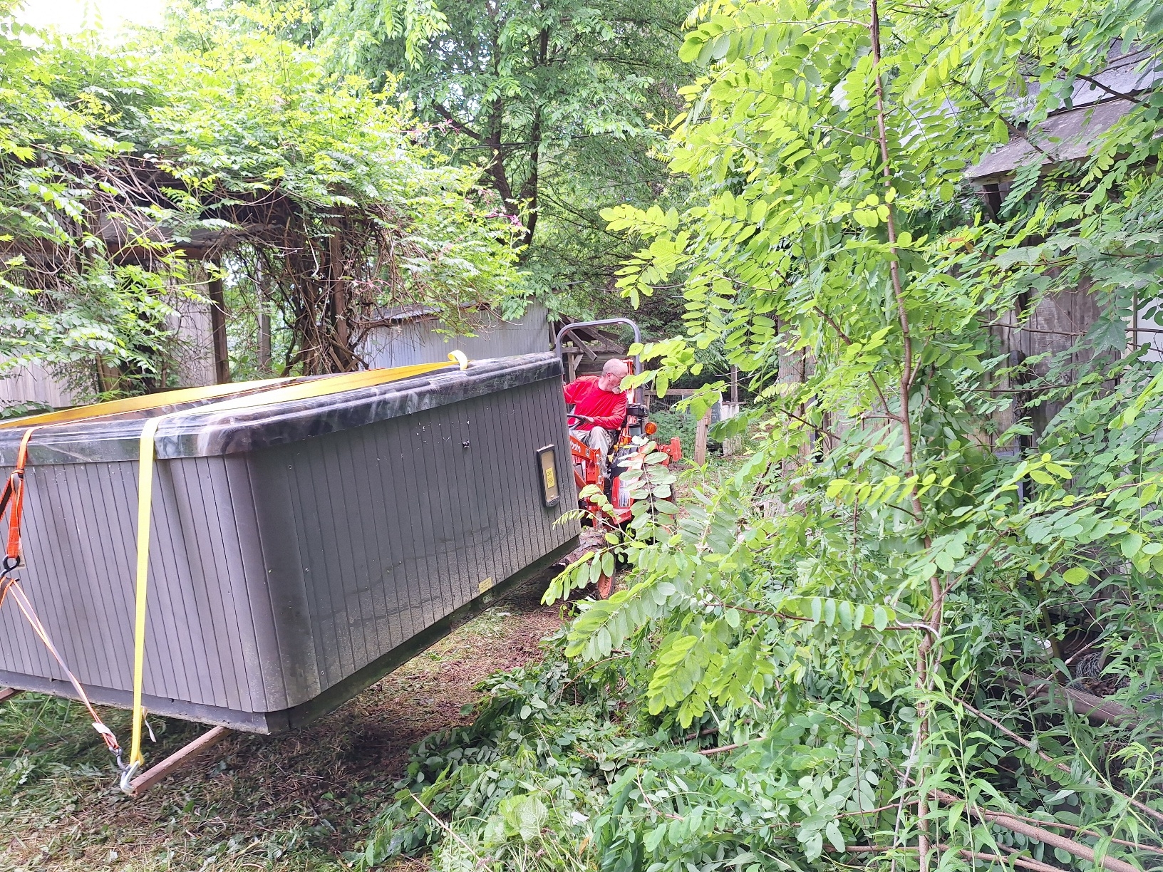

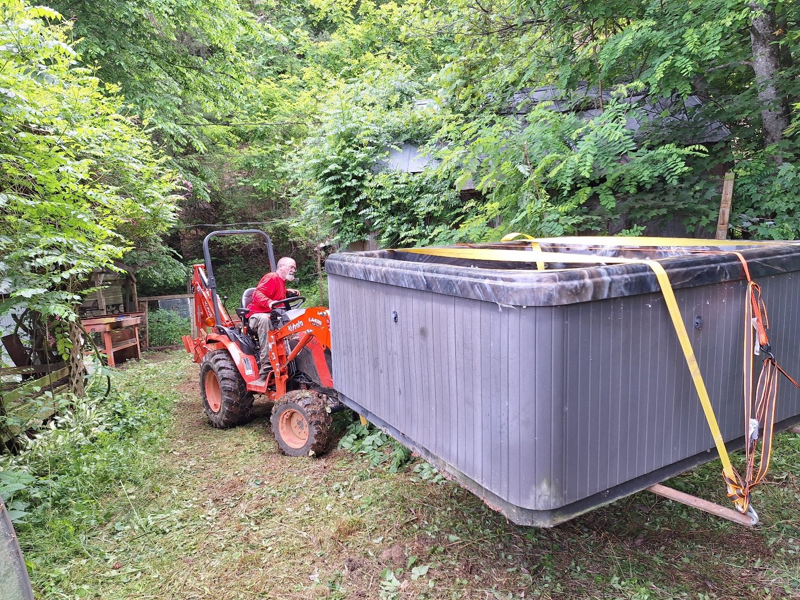

That's impressive. It looks like the tractor should tip forward.
I lifted one end of an 8 person tub last year and pushed it into the final position. No way my 48" forks would have lifted the whole thing.
/ Lets build some QA "ExtendoForks"
There were several times I extended the BH and even had it extended out on the ground to the uphill side when I turned, it never felt unstable
It was supposed to be 684 lbs. empty+ 160 lbs. for left over water = ~850 lbs.
With the bucket + 48" forks + a 8 ft pallet all 30" from pivot point...tractor wouldn't budge it, so I lost the buckets wt. the heavy azz 8x8 pallet and the very heavy2x3x48 forks.
Tractor would only pick the hot tub up parallel with the ground, when we got to the new deck, my friend pulled up on the front strap he said maybe 20#s and I easily lifted it another foot with hydraulics, tilted down and set it on the deck.
