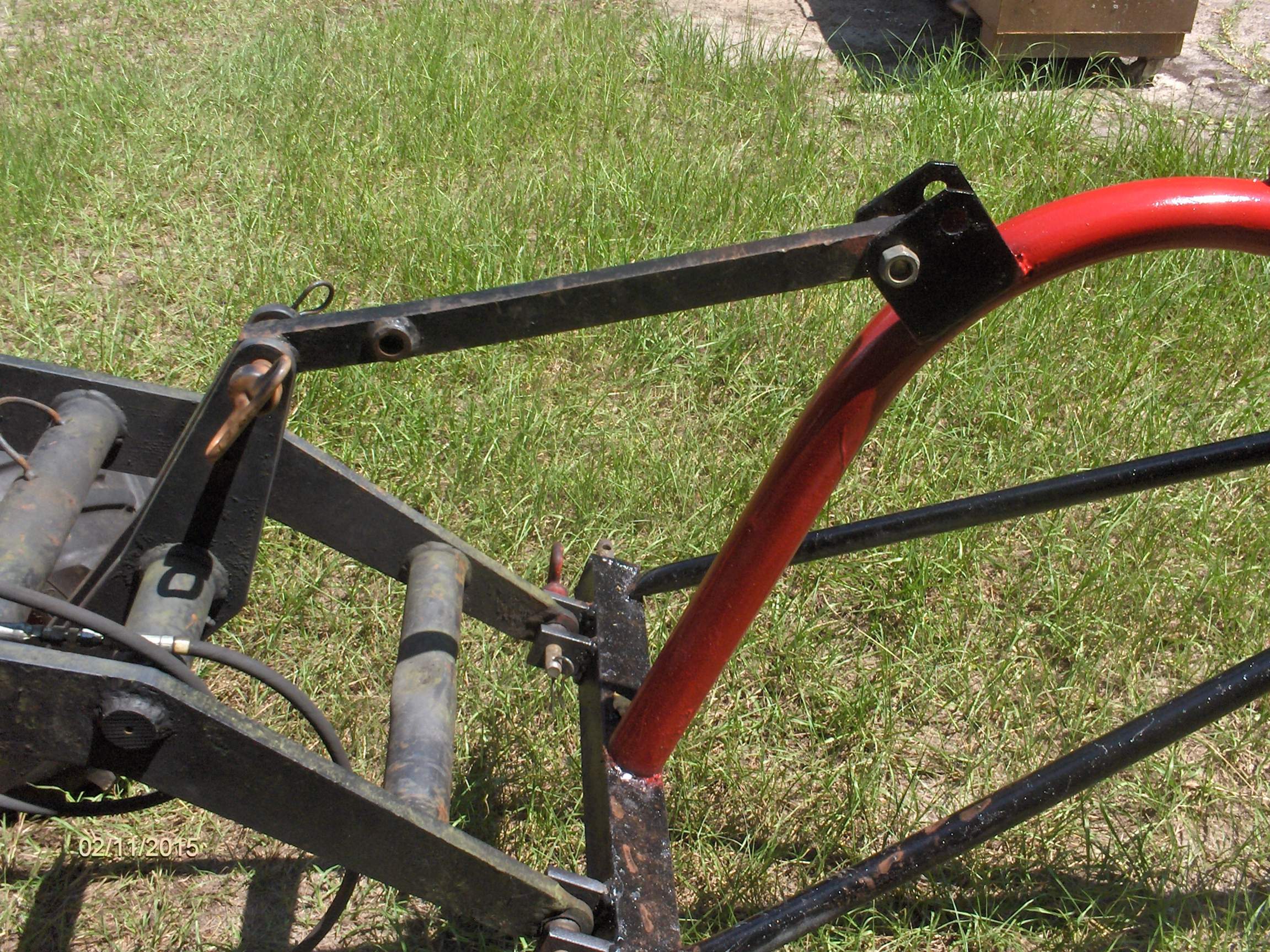

You can also change the rotation angle by shorten or lengthen the link bar from the roll over assembly to the QA plate. My link bar has two settings in it.

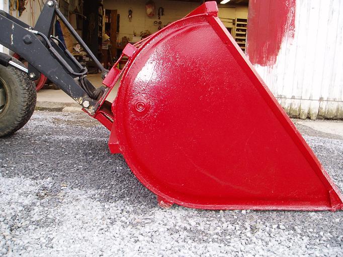

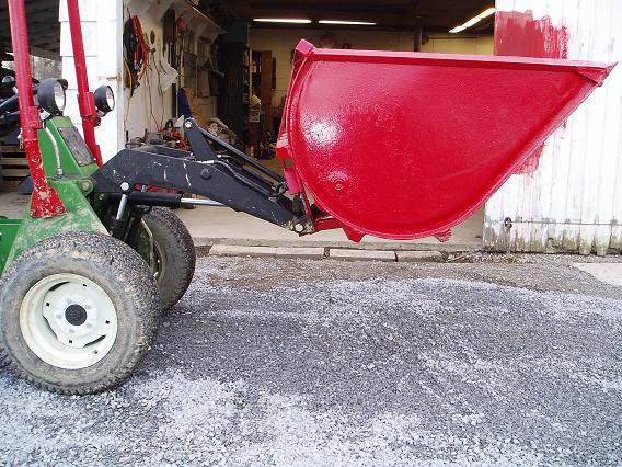

the angles on my large bucket

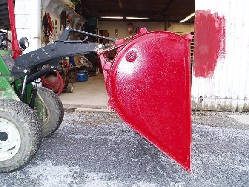

/ QA plate angle #15
Flat on the Ground
  • 580353-Bottom%20level%20on%20ground%20shows%20the%20tilt%20of%20the%20adaptor%20plate.JPG

That LARGE bucket still cracks me up. It is so disproportionate that it looks photo shopped. :laughing:
There are times when I could use something that large. Not too often, but just once in a while. Every time I see an old oil tank I think if it. :thumbsup:
