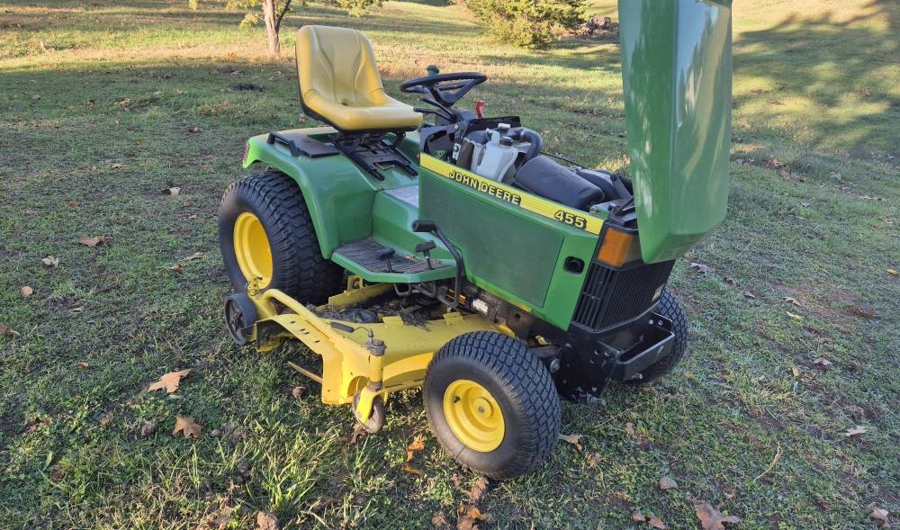

Just yesterday I'm mowing with my JD455...running great, shut it off, then completely dead. I had a screwdriver with me.
Put it on + terminal, whacked it...nothing.
Tried -- terminal which swiveled a bit. Started/ran fine.
Three minute "fix". (I should clean terminal).
Tried -- terminal which swiveled a bit. Started/ran fine.View attachment 4375375
