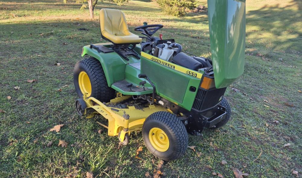

Put in a new Battery, got nothin' - I am not dumb, but maybe I'm not bright?

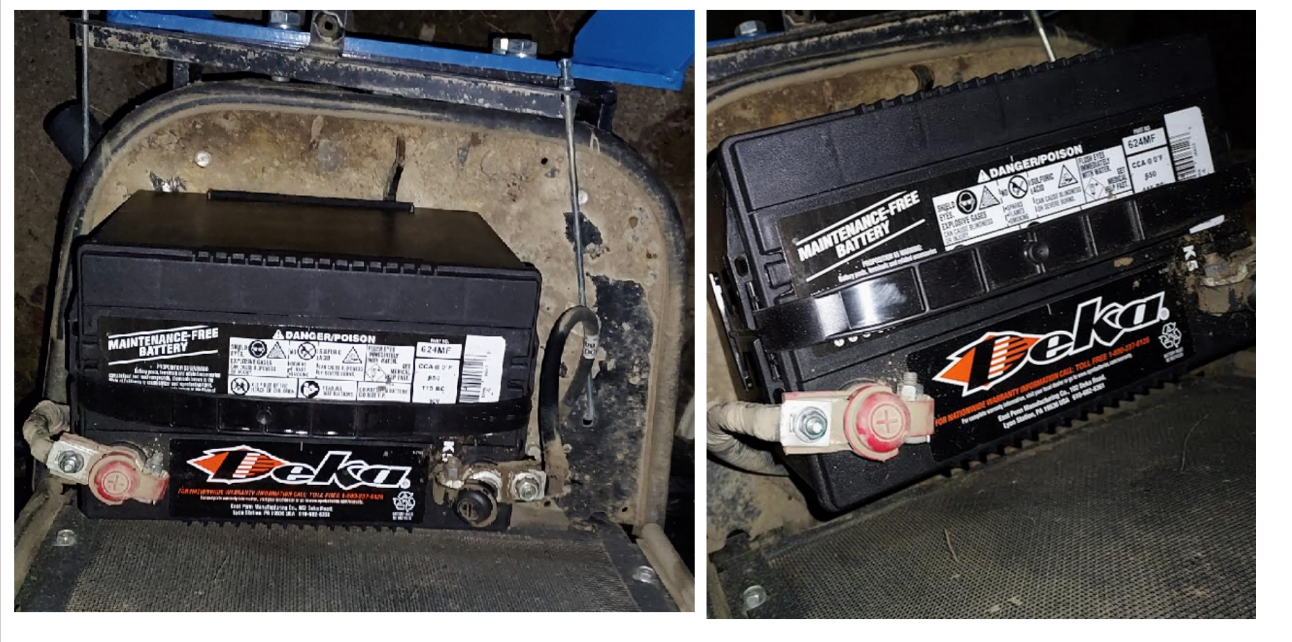

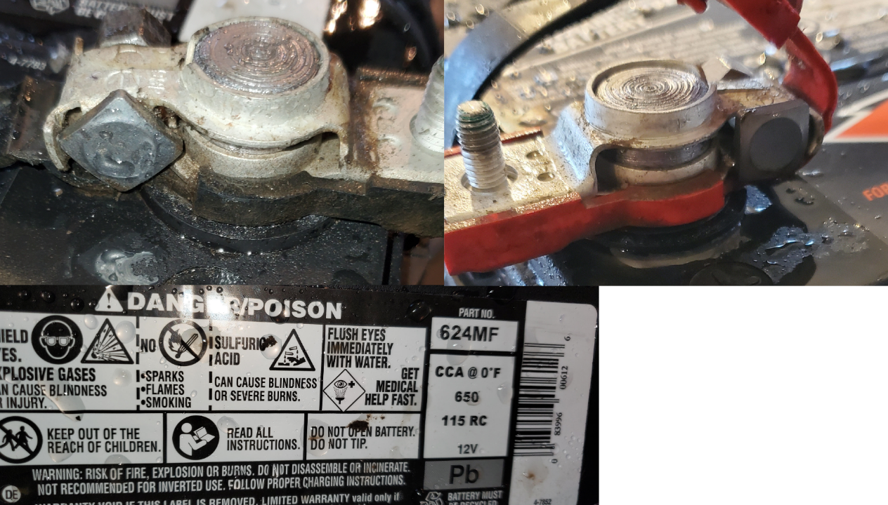

Can you post a picture of the battery in the tractor?
