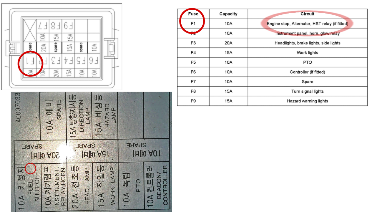

I’d check the fuses, a chance you blew one changing the batter. I’d also check you negative batter cable where it’s grounded.
Thank you, I am about to head back out there to check the fuses. The ground is where LS put it and it makes sense, bottom plate.

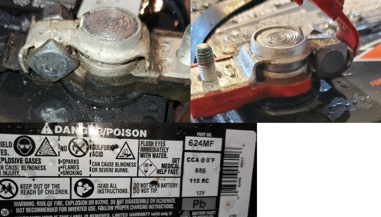

I try to check a new battery with a meter before I even leave the store because I’ve had new bad ones before. Even a test light could be useful here. A meter is better but a test light could let you know if it’s totally dead or not.
Sent the wife to auto zone to pick up one.

How about a pic with those caps pulled back??
Your problem must be something real simple right there at the battery. Hard to believe you have a new battery that's so dead it won't even light up a dash light or make something click -- but it's possible.
Someone asked if you put the battery cable ends OVER the plastic caps that come on a new battery post. Did you check for that? Is the red or black cap still on one or both of the posts?

The Bills are making me so mad I went back out there and wiggled everything - no sign of life yet. Wife still hasnt made it home so I cannot test the battery yet, but I did dig into the fuse box and what I saw versus what the manual says seems to be incongruent unless fuel shut off means engine stop in the translation
