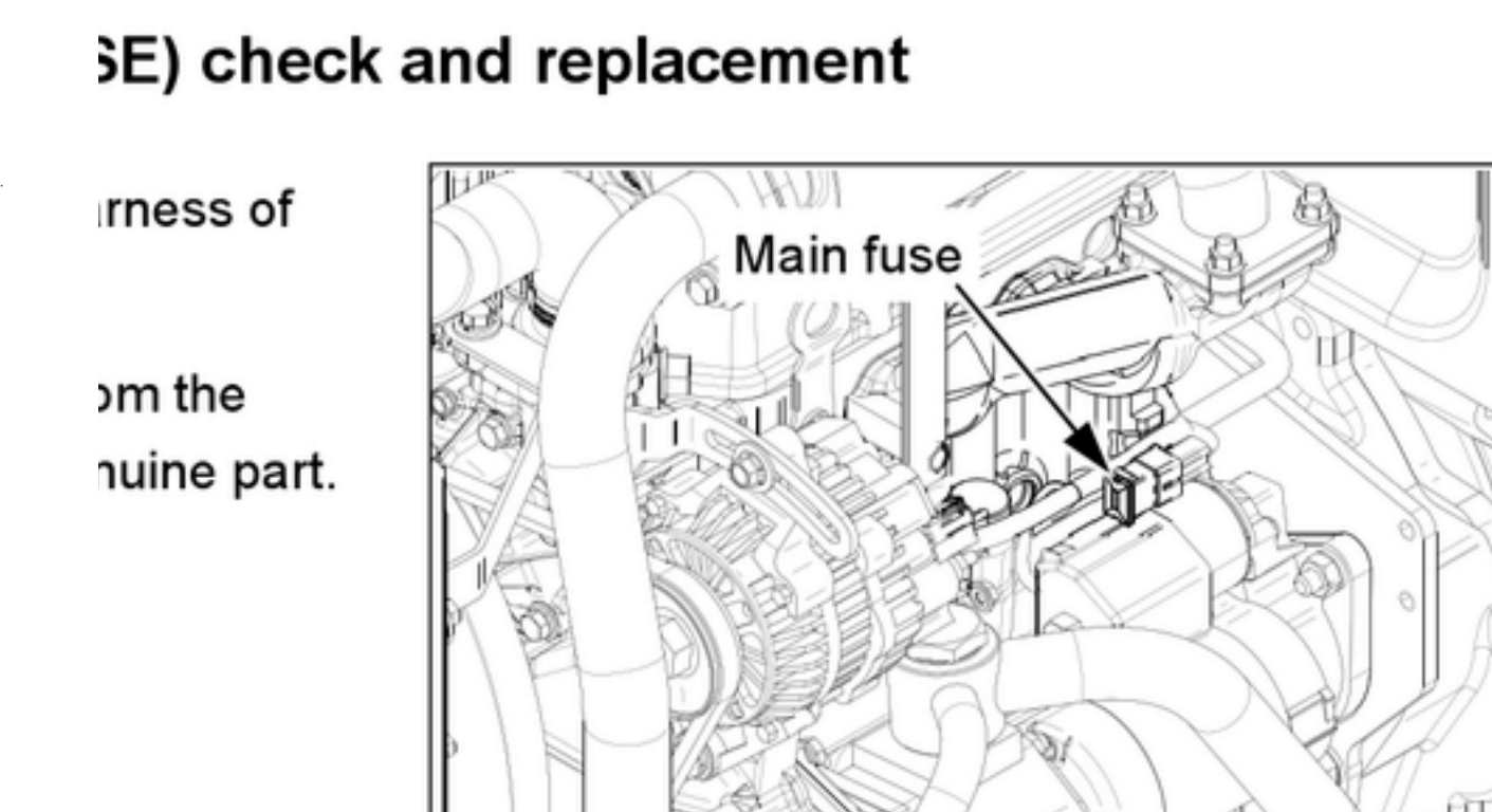

Ok so I read about that here (attached) but maybe it was snowing too hard or whatever but I couldnt find it - I was 100% traveling down this path of thoughtView attachment 4375403
Definitely need to find that fuse and test it with your new meter. Should be right there on the end of a modular plug as shown in the picture behing the alternator.

Considering the tractor was working before I doubt the key switch is broken. I wouldn’t suspect that the battery is the problem either since it did have good voltage. I kinda doubt the battery cables are at fault either since the dash won’t even light. I would turn my attention to a blown fuse at this point in the investigation.

If this does not work, then it is likely a blown fuse. But also consider using a load tester on the battery (a multimeter is great for many different things, but to check the health of a battery, a load tester must be used.)
