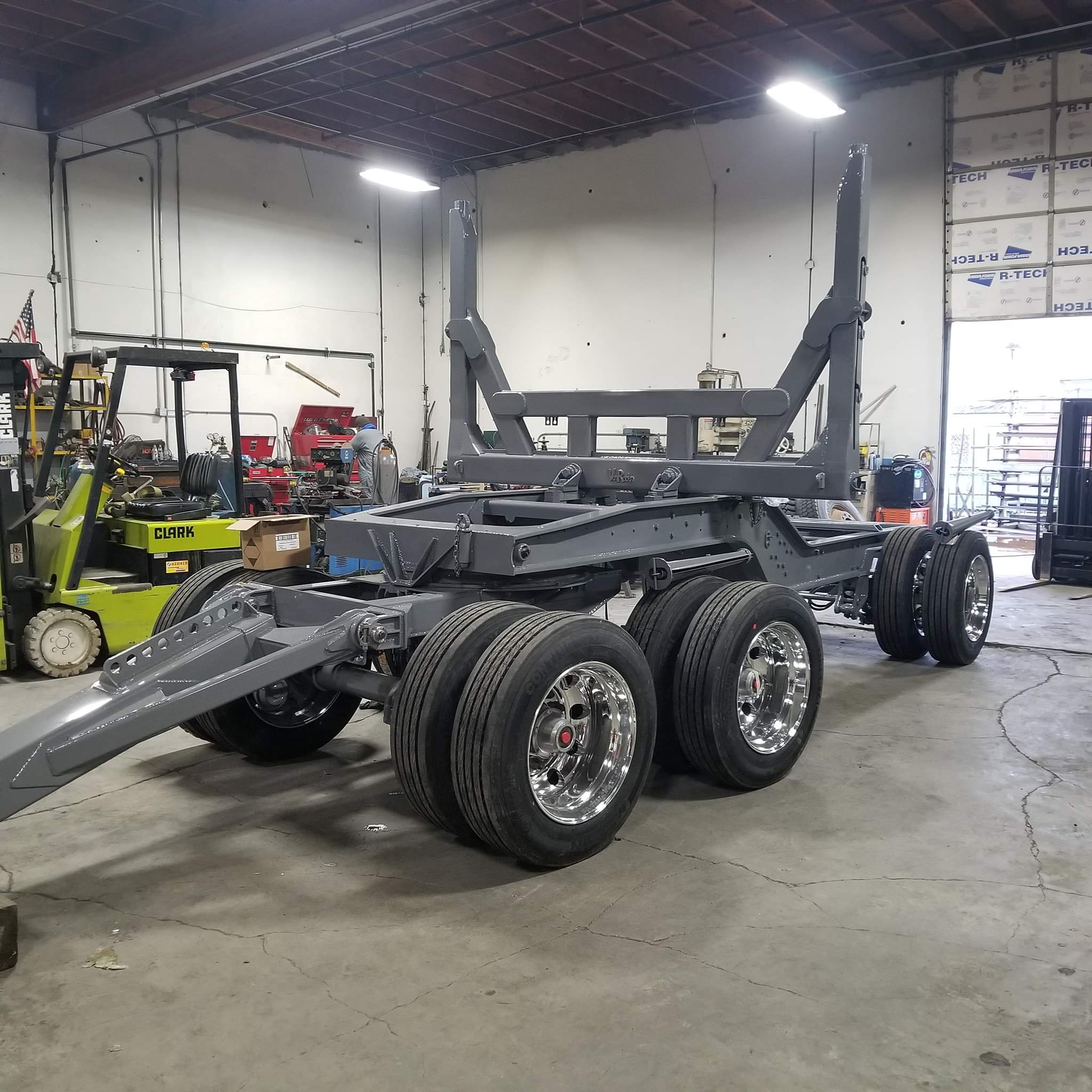

Try a mule train short logger trailer out in the wood a with a mile or two back in with the trailer down that’s why some of the dollies are lockable.
The only pup I ever pulled that had a locking pin is similar to the one in the photo. The gap between the 1st and 2nd axles is to allow the front axle a limited amount of pivot. Mine I would about 30 degrees in either direction before it hit the stop. The short distance between the front axle and the trailing axles plus the length of the reach made it very difficult to back when the pin wouldn't drop,
One of the companies we worked with had a pups with a two axle dolly and a good separation between the front and rear axles sets. They could back the trailer where the wanted it, unlock and back the truck beside the trailer and dump both boxes simultaneously side by side.

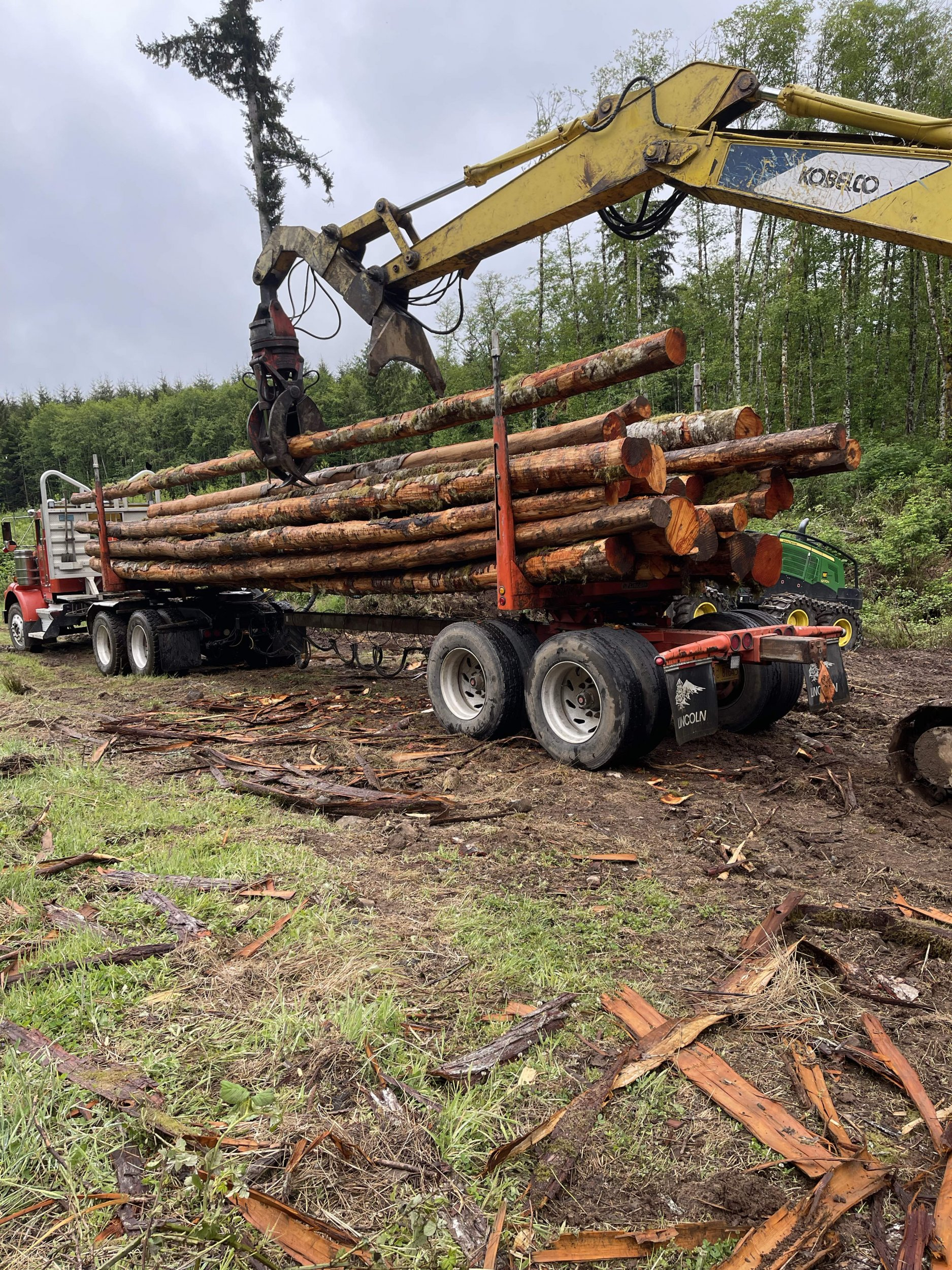

A three axle with a lockable tandem dolly pole for the PNW this company and General are what’s considered the standard for these types of trailers. With the three axle with the dolly up front it allows them to haul longer lengths without having to use a steer axle trailer.
