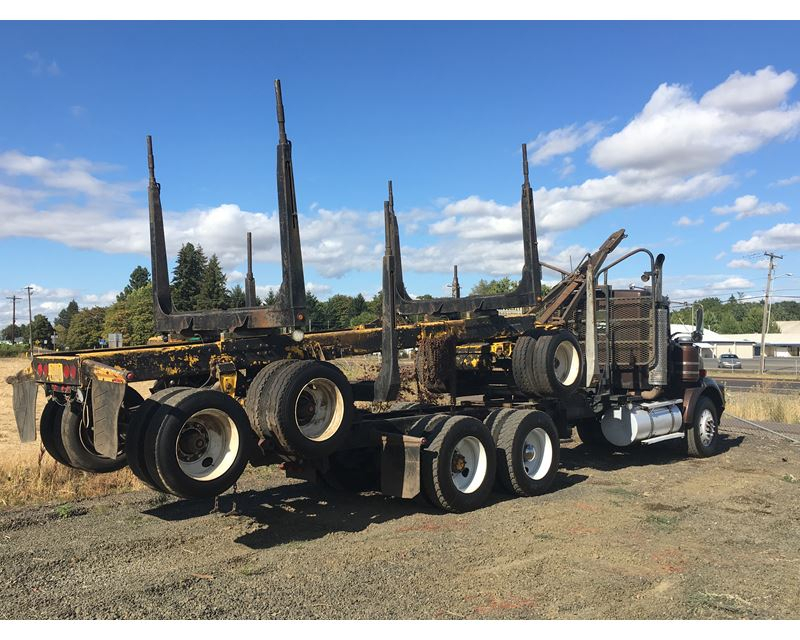

Try a mule train short logger trailer out in the wood a with a mile or two back in with the trailer down that’s why some of the dollies are lockable.
I thought we were discussing pup trailers, not log dollies. Excuse me if i took a wrong turn 😀

It is a pup, a west coast mule train or short logger is a different sort of beast you can run up to 5 axles most are two axle or three lumber pups and mule train pups are where the term wiggle worm comes from. The advantage to the setup in this picture is you can hop up the front axle of the trailer allowing the trailer to be loaded but still be unloaded by small equipment.

It is a pup, a west coast mule train or short logger is a different sort of beast you can run up to 5 axles most are two axle or three lumber pups and mule train pups are where the term wiggle worm comes from. The advantage to the setup in this picture is you can hop up the front axle of the trailer allowing the trailer to be loaded but still be unloaded by small equipment.View attachment 730522
With that relatively long drawbar and single front axle, its not harder to back than the type of combination with which the average European construction company moves their excavators up to 30 ton... And they dont have turntable lock: and if such trailer had turntable lock, it would still need a loaded dumptruck to be able to push 4 axles around the corner.
(Ha! In fact i remember hauling stuff with a 5 ton farm tractor in front, on a wet road: with that tandem under the turntable, even loaded to 1/3 of capacity it would jackknife a farm tractor unless you brake before the corner, and pull flat out through the corner)

Come on out an show us on the logging roads we have out here there’s a reason the trailers are packed in on the truck as much as possible. There’s place we’ve had to back around twists and corner a mile or two there’s just no place for a turn around. That one is setup to hop up on the back of the truck to help you back on those logging roads it also gives you weight on the drive axles to get up the hills that we see out here.

You mean a long logger with a reach? Or log trailer without a reach as in a pole trailer?
This is a long logger with a reach the reach steers the trailer, this is easier to back up then the mule trains are.
