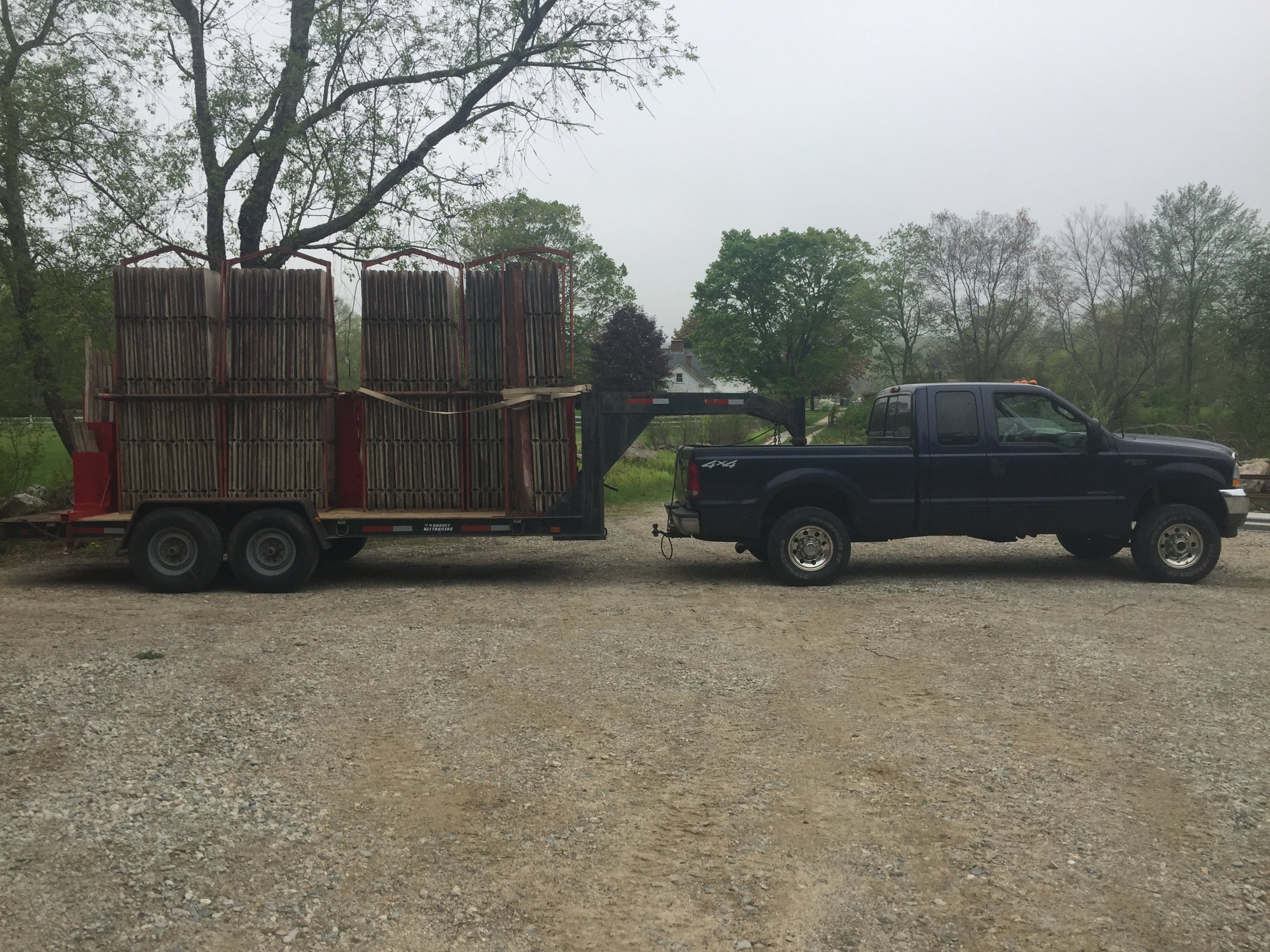

I do concrete foundations and everything I use to do them (footing planks and wall panels) is towed to jobsites on trailers behind my F-350 and Dodge 3500 dually. Some trailers are traditional bumper pull and some are gooseneck.
My 8' tall panels are towed on a gooseneck 12,000lb GVW tandem axle trailer. See picture of trailer below. What I don't like about this setup is you have to climb on to the trailer to grab each and every panel and at the end of the job you have to do it all again (climbing on to the trailer) to put the panels back into their cages. This is a wear point on our bodies and is time consuming.

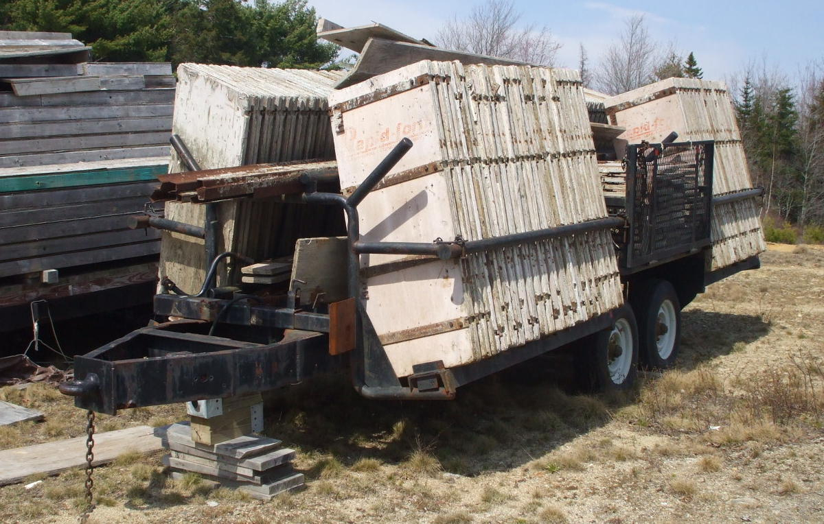

Years ago, my father had this business and used a single axle 26k truck with a custom panel body to haul the panels. The racks were canted in slightly to use gravity to help hold the panels on the truck (there was also an angle iron that slipped over some hooks to keep the panels in place, but the cant did most of the work).
What I'd like to do is make a hybrid of the two systems: stay with a trailer, but go with the style body my dad's truck had with the panels canted in at the top. Here's the stickler, though, I'd like it to be a single axle dually gooseneck with no deck, just the frameworks (12,000lb. GVW).
There doesn't appear to be anything like that in existence. I've looked everywhere online and can't find one. If I could have one built, I'd finish it by fabbing our own body.
This clearly is a rare concept, but I think it would fit my needs perfectly. Anyone ever seen anything like it?

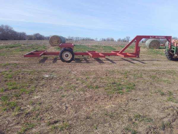

What about goose necks I see for hauling large round hay bales two wide? I have no idea if that’d be a good starting point or not.

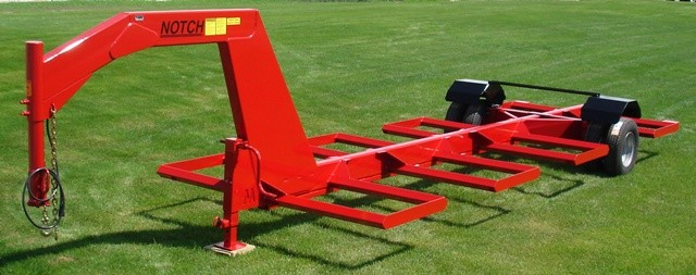

Some round bale GNs from an image search:
From Hay Trailers and Buggies - Gobob Pipe and Steel presents our Hay Trailers on Gobob Pipe.com
