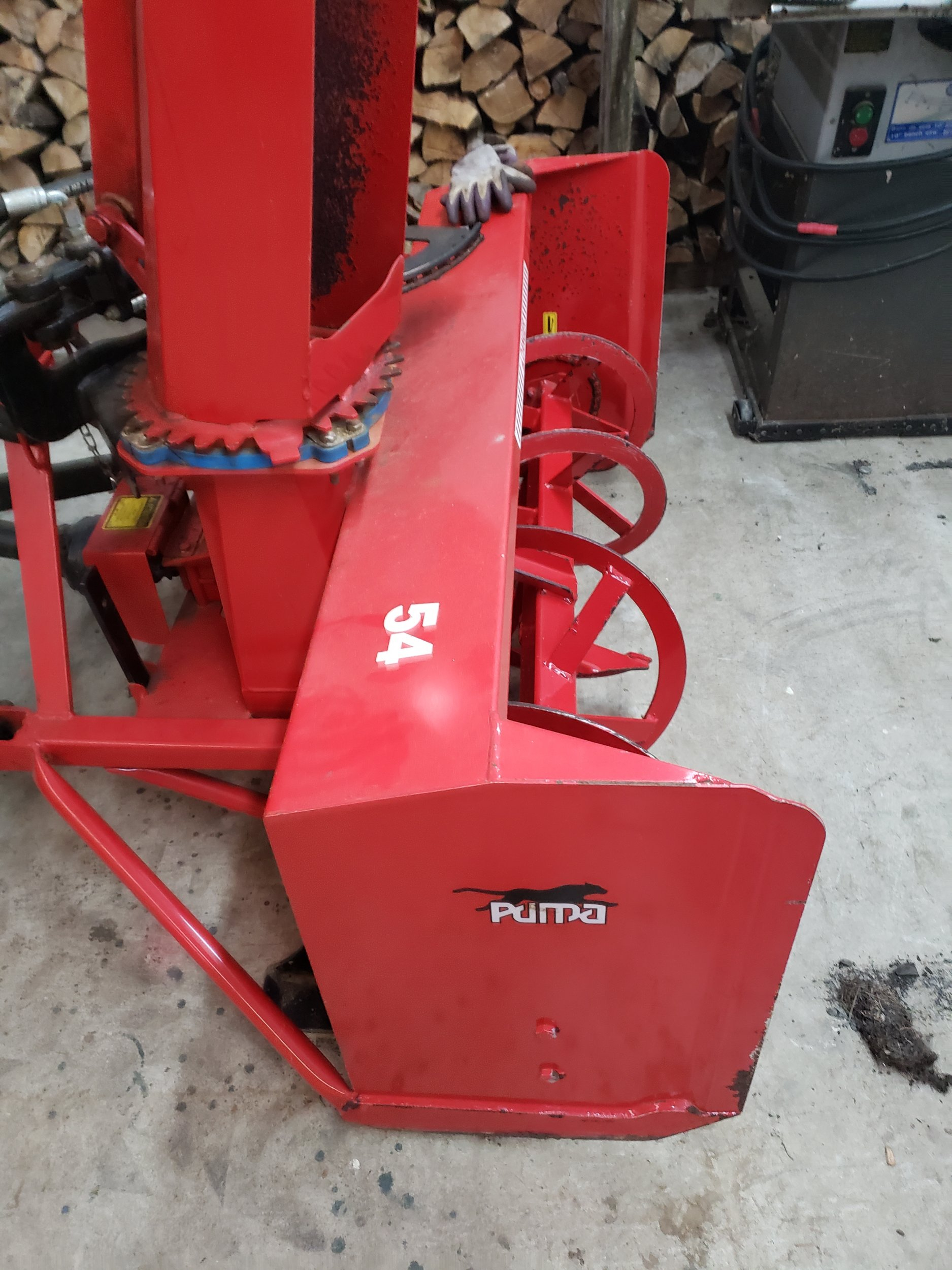

Hi. As it says in the title, I have a TYM 254 tractor running a Puma-254 chain. I believe that the chain has been stretched. That's how I found this web site, searching for info on how to route the chain tensioner. I adjusted the tension sprocket down almost as far as it would go, and got the tension required to keep the chain running smoothly, at least for the time being. Now I'm concerned that the chain may be over stretched and at risk for failure, which I would not want to see happen next time I go to use it. Should I be purchasing a new chain for the blower? I was also thinking of purchasing a chain breaker, and learning how to use one, so that if anything goes wrong I will be somewhat prepared to fix it when the time comes. I'm also wondering if I could just use a chain breaker to remove 1 or 2 links from the existing chain, rather than changing the whole thing? Thanks. As a basic NEWB I would love to get some advice about the right thing to do with the blower chain. Cheers

Chain wears out, faster if not oiled.
Old chain will have a master link with a clip. You can shorten the chain a couple links and put it back on, but keep in mind a well worn chain will eventually ruin the sprockets.
Depending on how long the chain is, two links short might be too much, you might have to use a "half link" to put it back together.
You can buy new chain and cut it to length and be new again. It's likely #50 chain, should be stamped on it. Usually can be bought cheap at parts supply place.
I don't use chain breaker, put in vise, and use angle grinder to take head off of the rivet and pin punch to push it out.
I keep various chain, master links and half links on hand. Broken chain not fun in middle of storm or job and everything closed.

The chain on my blower definitely stretched over time, and I broke it many times when something would get wedged in the auger. After a while you just need to replace it. I compared my old with new and it was quite remarkable how much it has stretched. I always kept a few master links in the tractor so I could get things running again in case of a break. I probably should have replaced the chain much sooner than I did. None of the parts are particulaly expensive, so really no excuse for letting it go so long.

In case anyone else is wondering, the chain doesn't stretch per se, the metal is the metal and does not stretch, but the pins will wear, causing the pitch (length) to expand.
So, as there is the wear in the pins and inner links, it is best to spend the $40 on a new chain, versus taking a link out and still having the wear in the pins and inner links.
