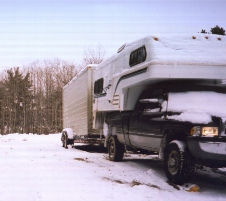

   / PTO Generator #97
Originally Posted by Smokin Diesel
Sure. You're adding a trailer with a bunch of wind resistance and a handful of tires. Pretty much what I said above.
Yea, but I unhook that trailer and take the camper off the truck so shouldn't the Fuel Mileage just go to astronomical levels if it's about HP required.:D
By the way fellows, all those degrees aside, have any of you ever heard of topography relief! :D
   / PTO Generator #98
Yep. For every uphill there's a downhill. For the extra fuel burn on the way up, you'll get that much free energy on the way down. I'll get my best towing mpg when I'm in the mountains, which was a surprise the first time I experienced it. But it does make sense, considering that I'm 10-20 mph slower in the mountains than I am across the plains, and that my net elevation change is zero.
Wanna start another thread about towing mpg in the proper forum and give this guy his thread about generators back?
