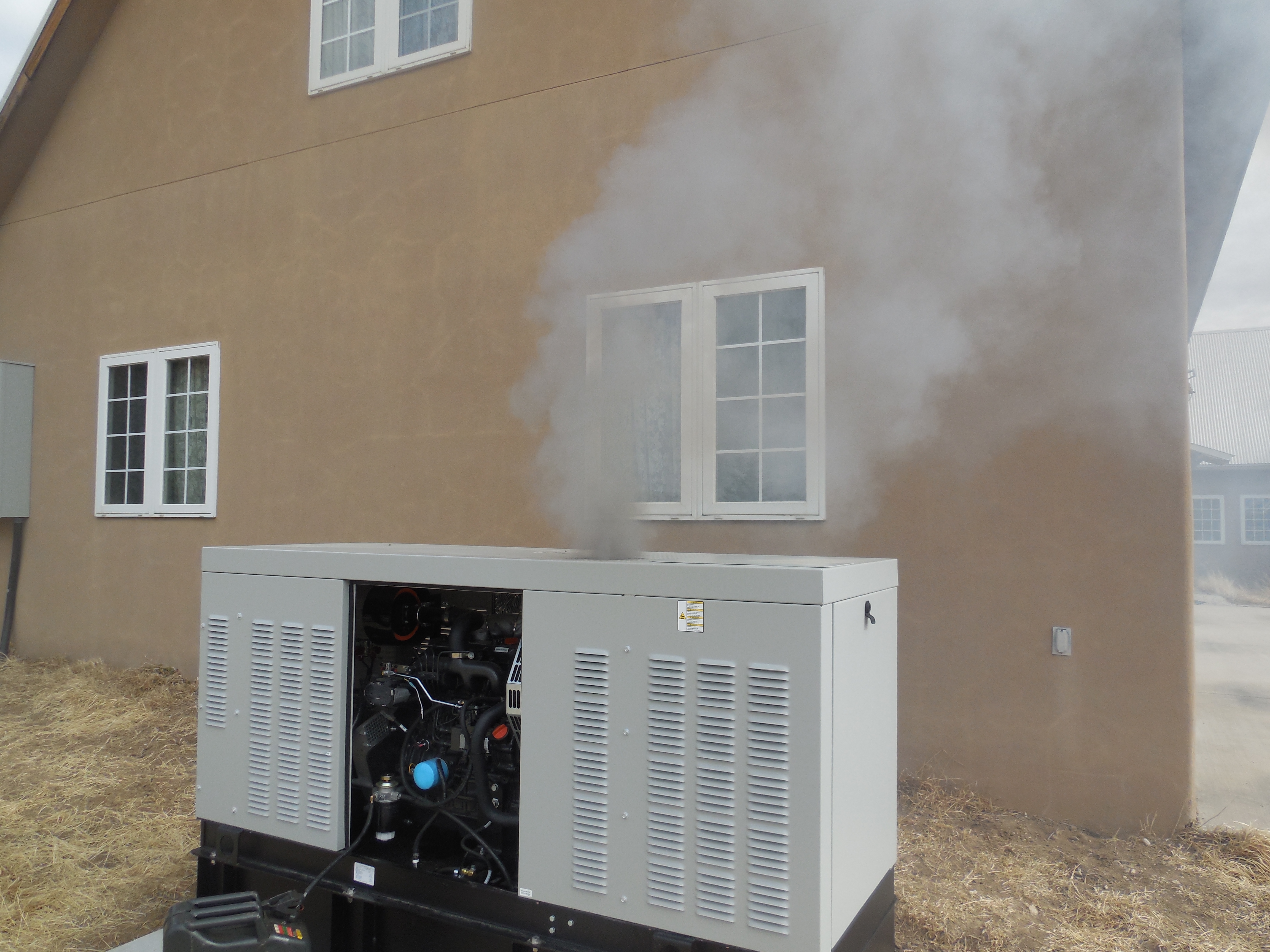

Diesel generators run on constant "low load" may suffer from "wet stacking". It can get messy.
You mean like this?
Well, in this case the cause was that the pump was timed for sea level, maybe even below.
But diesels, like any engine, doesn't like to idle. They're made to work. Supposedly older OTR tractor engines had rings that weren't even meant to seal at idle.
They didn't blow up when truckers left them idling all night, but sure put a lot of fuel in the oil.

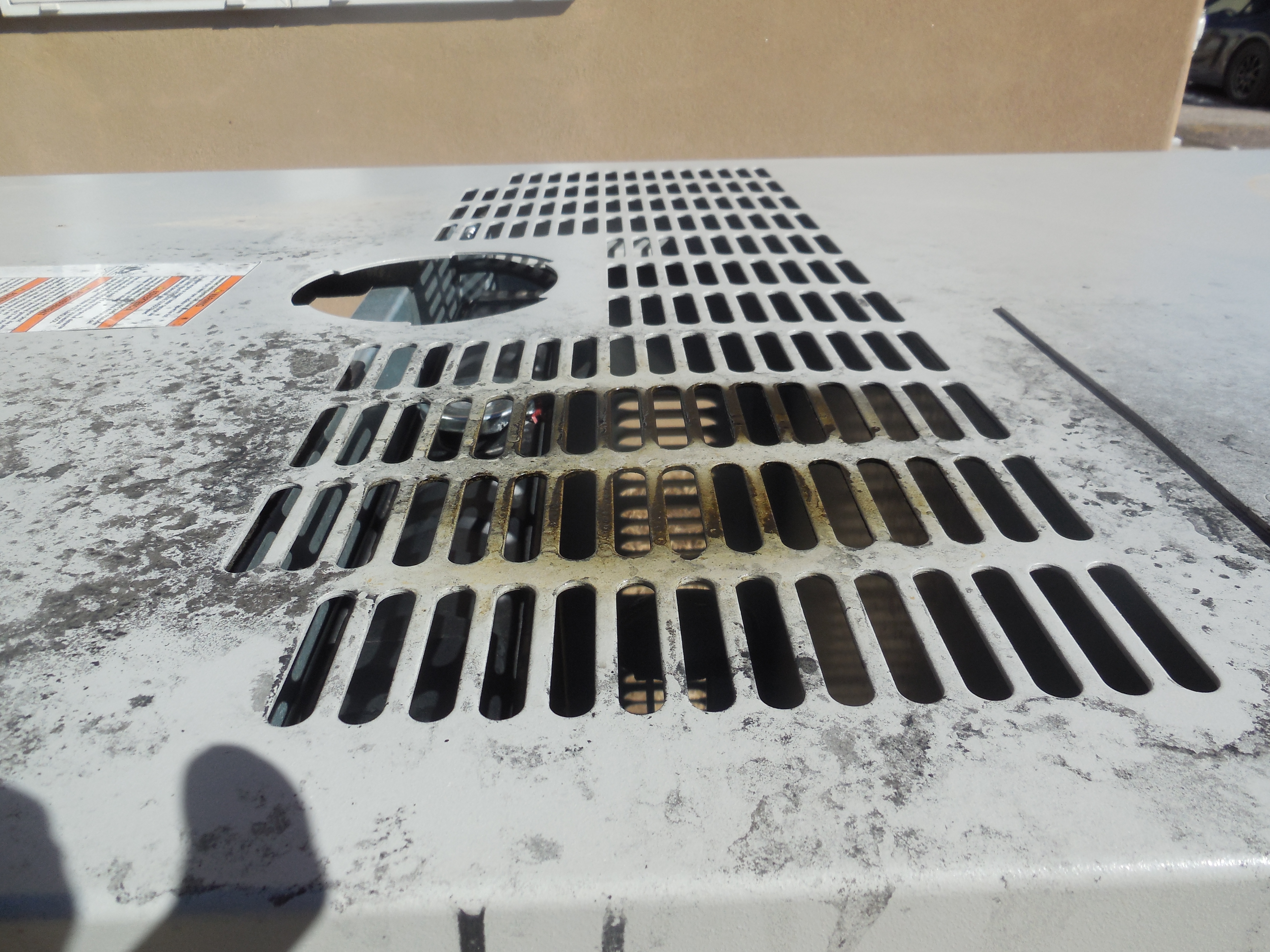

You mean like this?View attachment 1345804View attachment 1345805
I've seen maybe half a dozen or so generators suffering from "wet stacking" and they never smoked like that. It was always a thick black smoke. And some actually "spit" oil out their stack during start up.
   / PTO Generator #66
If I had let it run long enough, or been able to keep it running, the gray smoke from the cold start would probably have changed color.
