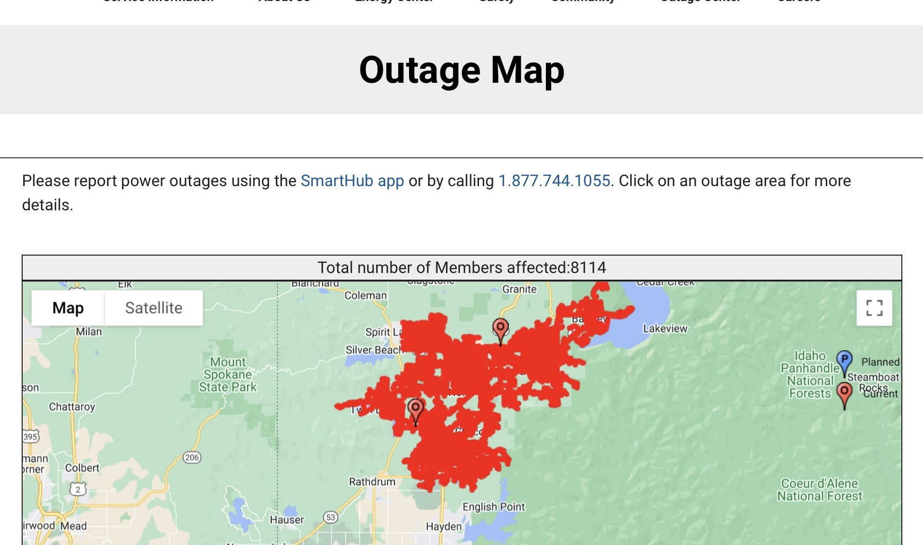

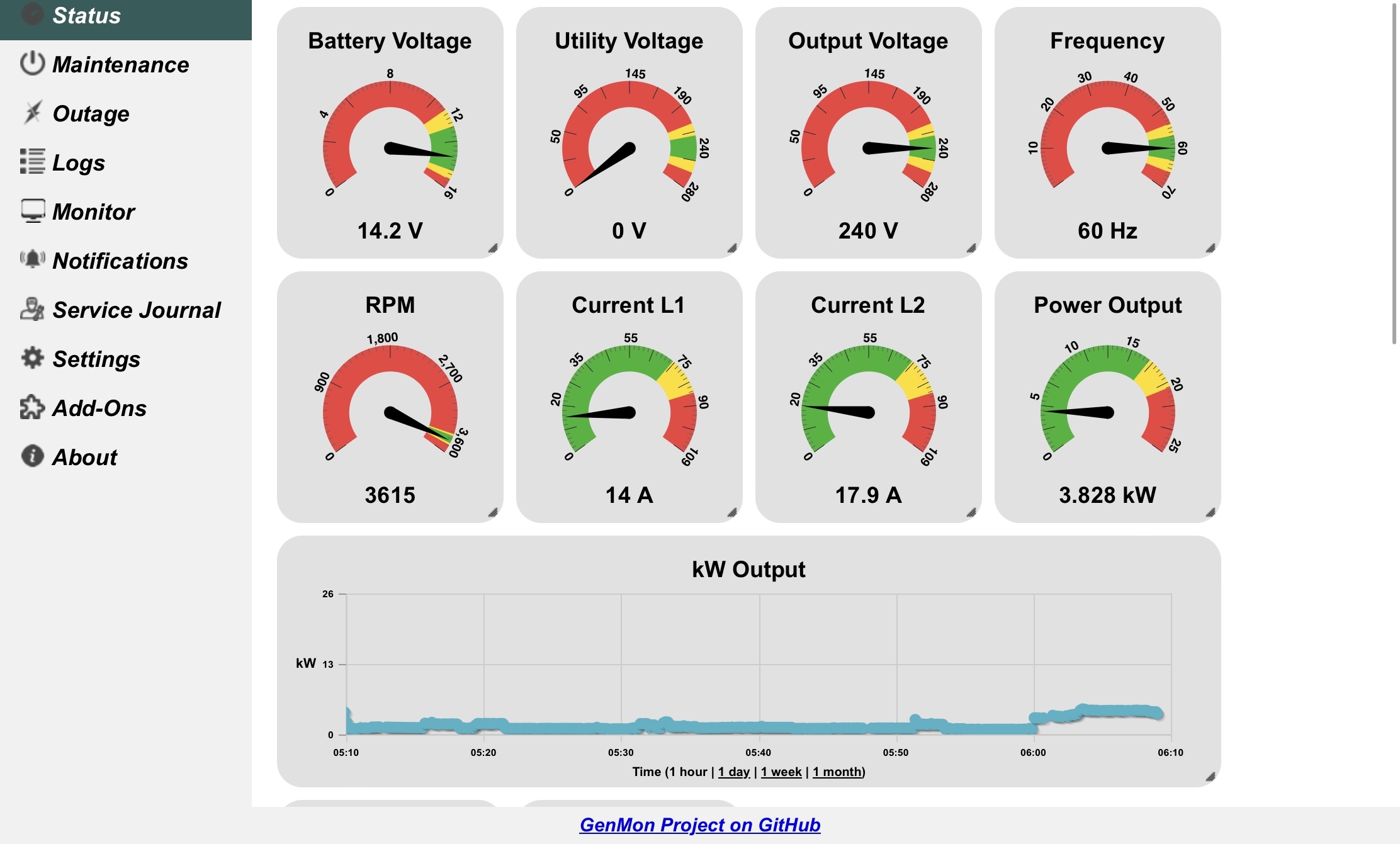

By the way, weve been running on my 22 kw genny for over an hour now. Utility website states 8,100 customers without power.
