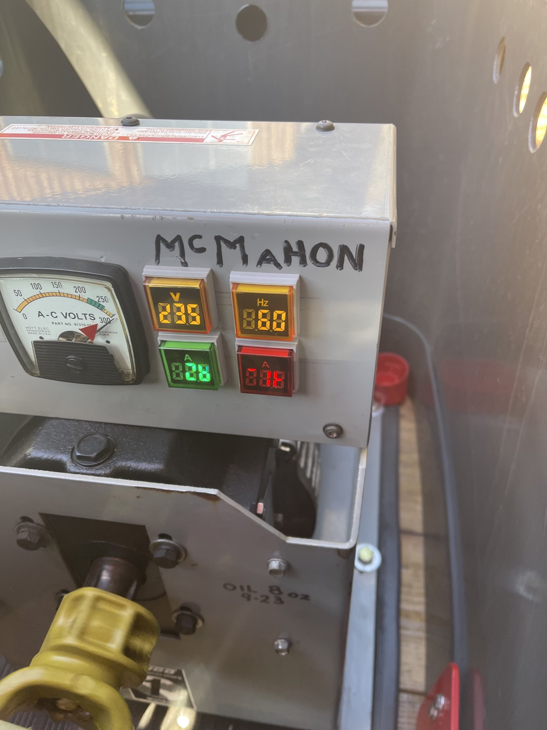

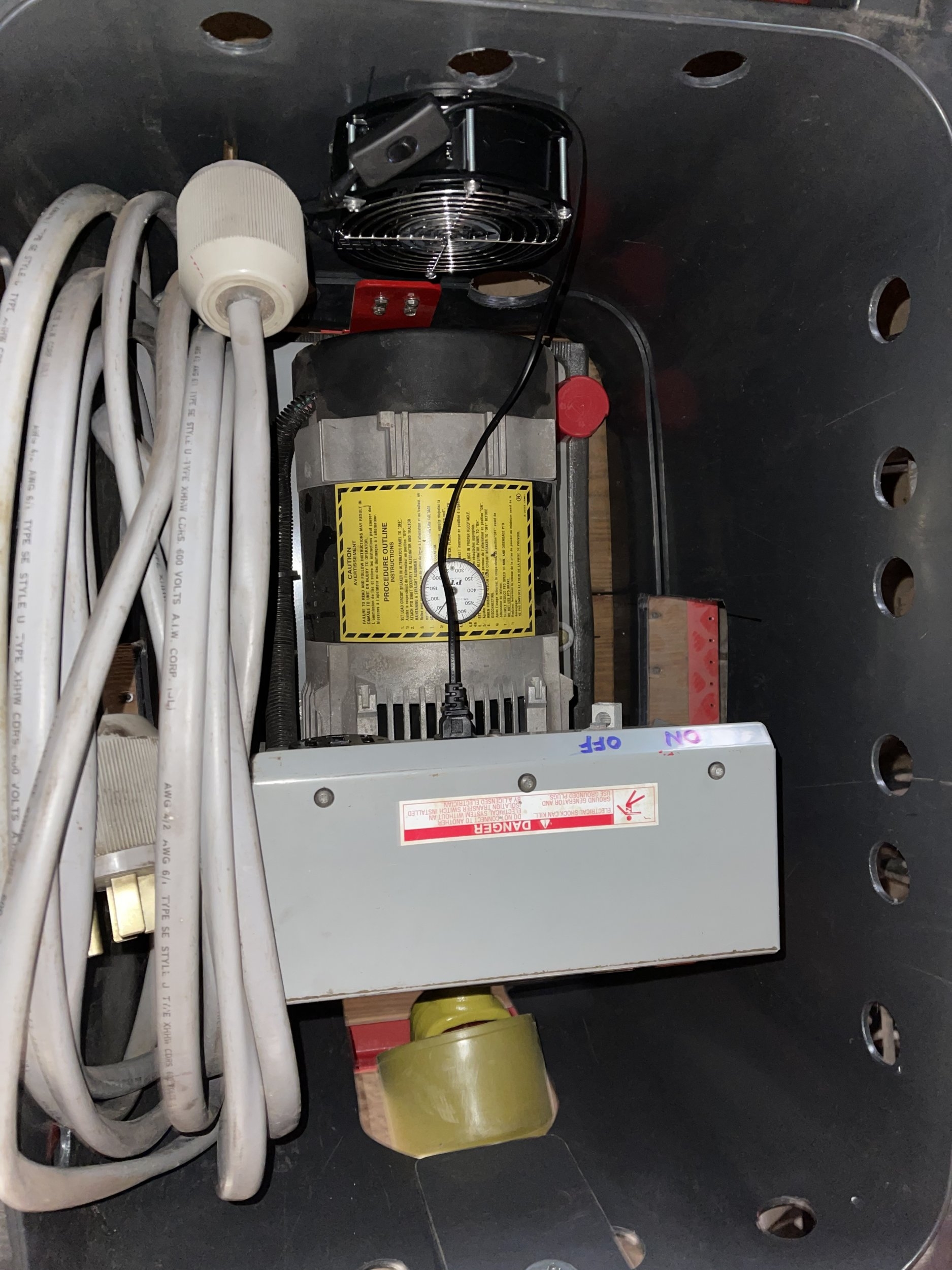

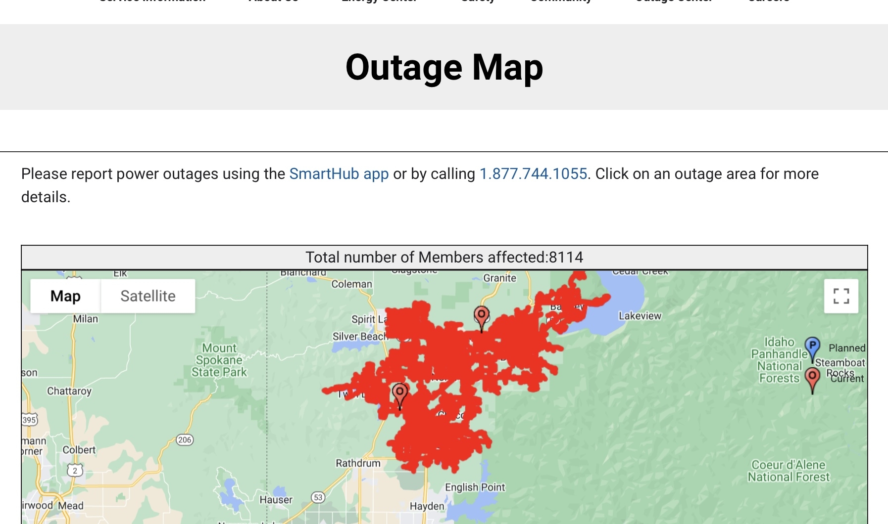

Yup. High tech frequency drive units are especially vulnerable to junky power. A generator capable of producing fairly clean power that can handle clean inrush power draw is very important.

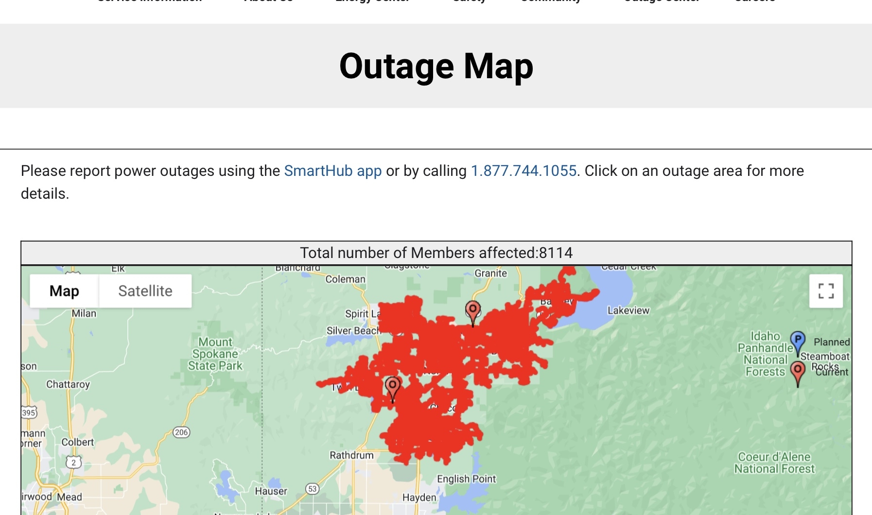

By the way, weve been running on my 22 kw genny for over an hour now. Utility website states 8,100 customers without power.View attachment 864618

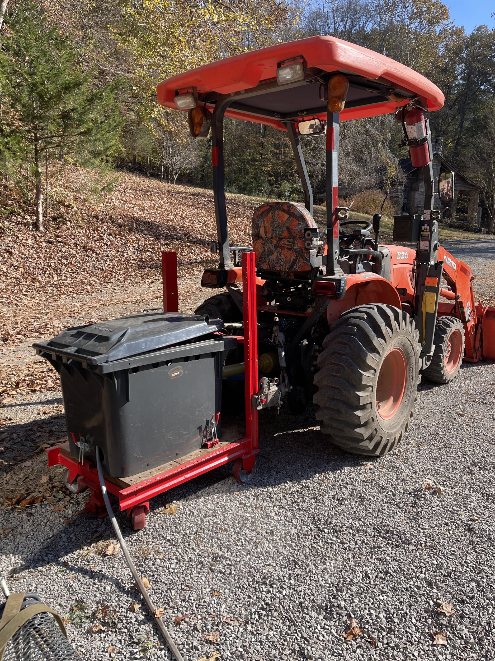

I wouldn’t want to have my expensive tractor tied up to a generator function during storms.
That's a super-important concern. Convenience, ease of access, fueling, etc, all are factors in deciding what kind of backup one gets, if any.

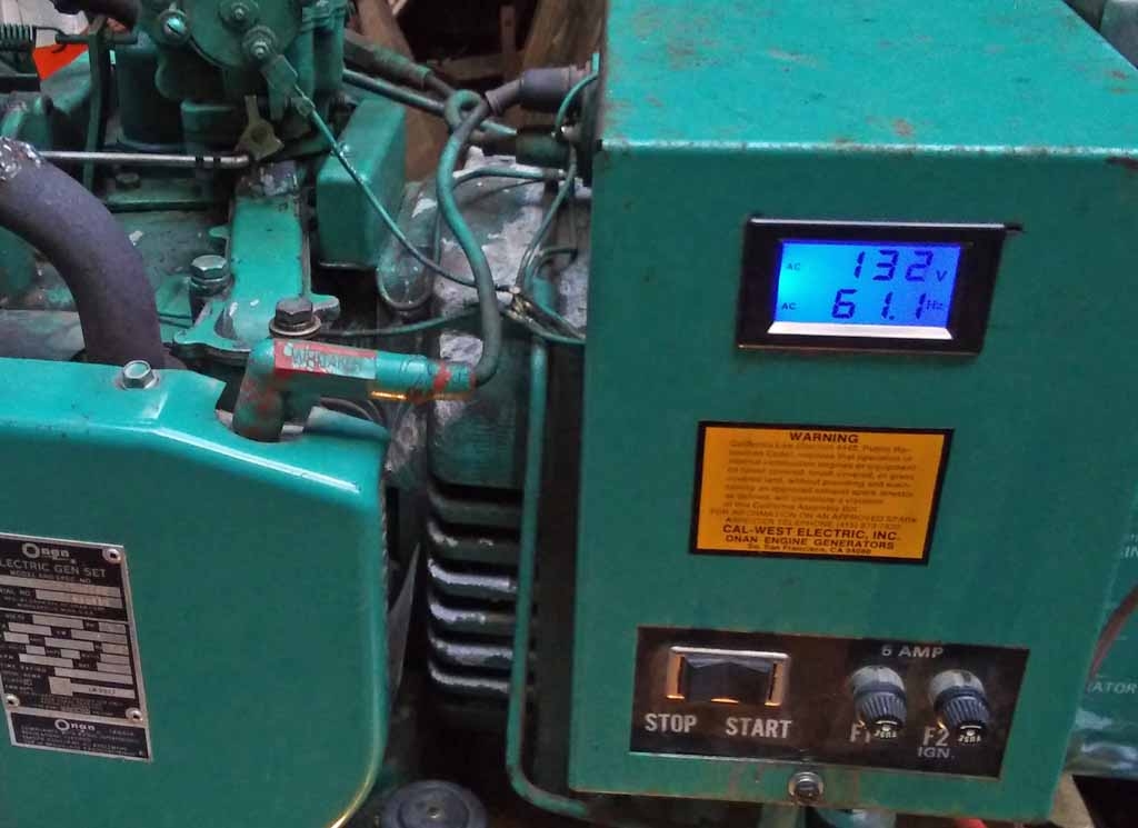

I take a middle road b/u strategy. I run gasoline, but not all day. Just an hour or so at a time when needing refrigerator access. 3-4 times per day. Not too noisy, and easy electric start, I use less than 2gal per day of gas. Manual breaker controls, and no extension cords. I also have a Honda EB3000C as b/u b/u in case the Onan fails. I am fortunate that I have gravity-flow water with a large tank, an excellent wood stove, and a super-insulated concrete house.

Multiple tractors also gives options of backup. Little tractor is great for 10k pto generator, Bigger tractor better for clearing road from snow and trees. Small gas Yamaha inverter has helped for short but increasingly frequent power losses.
