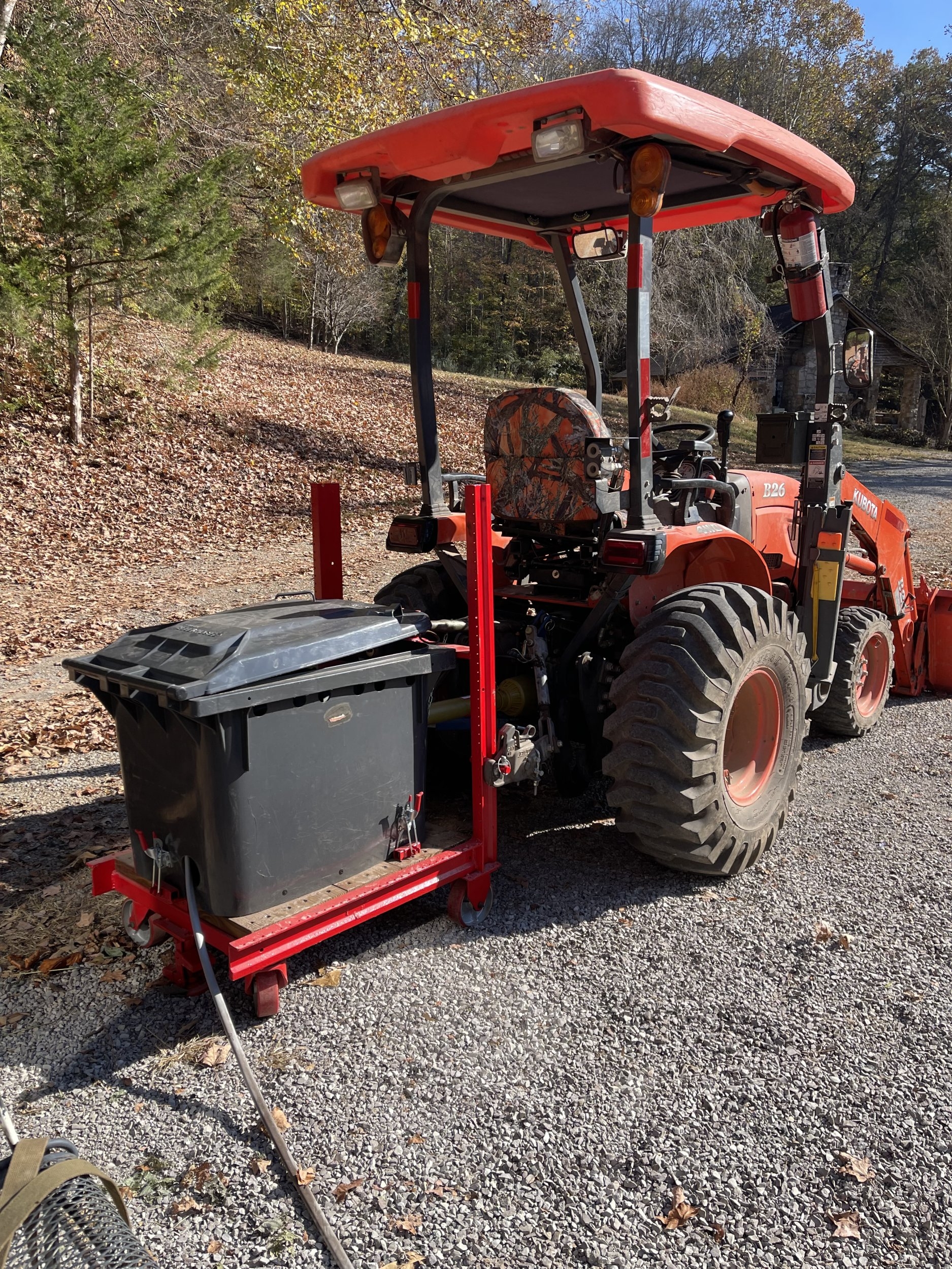

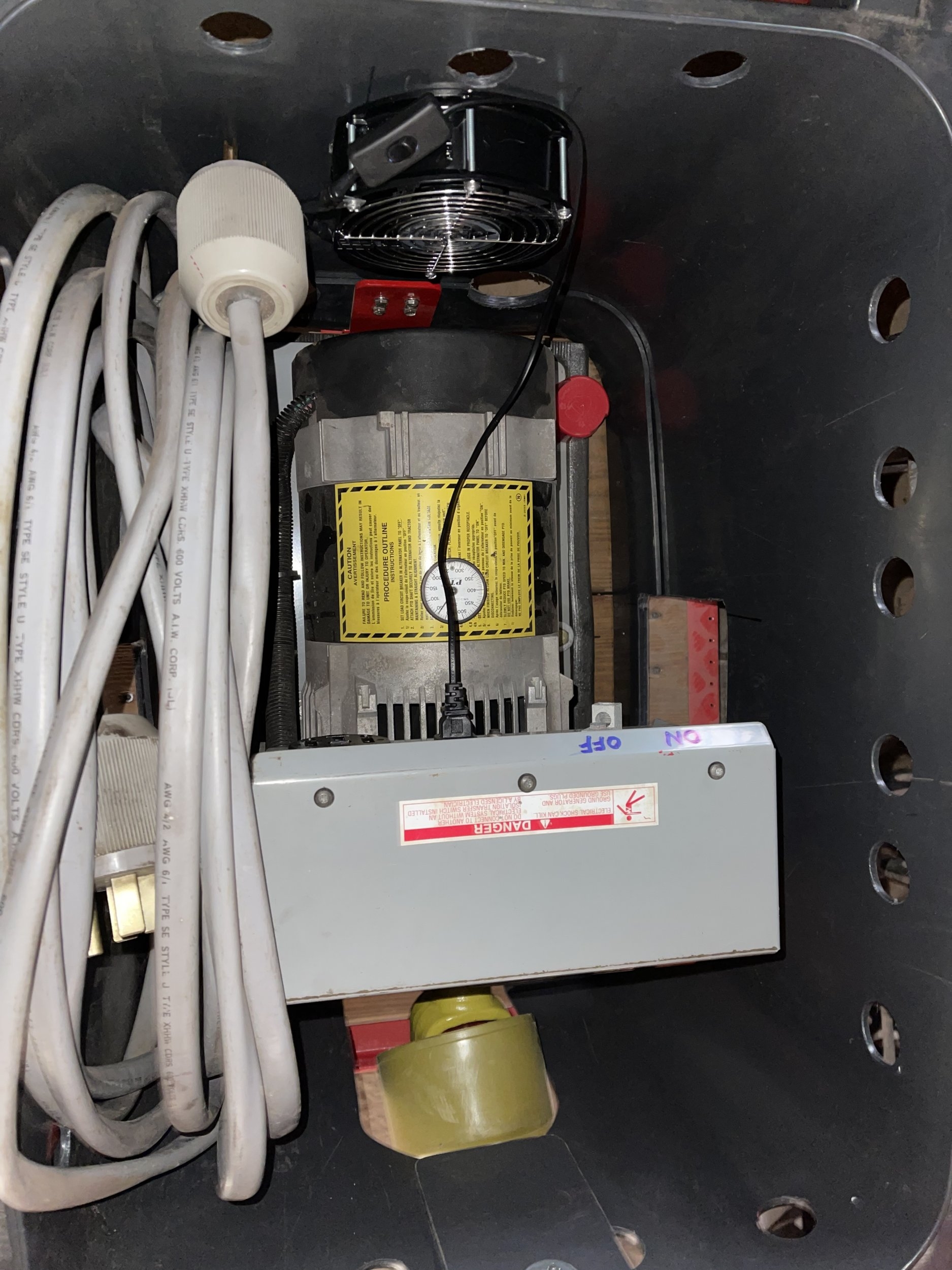

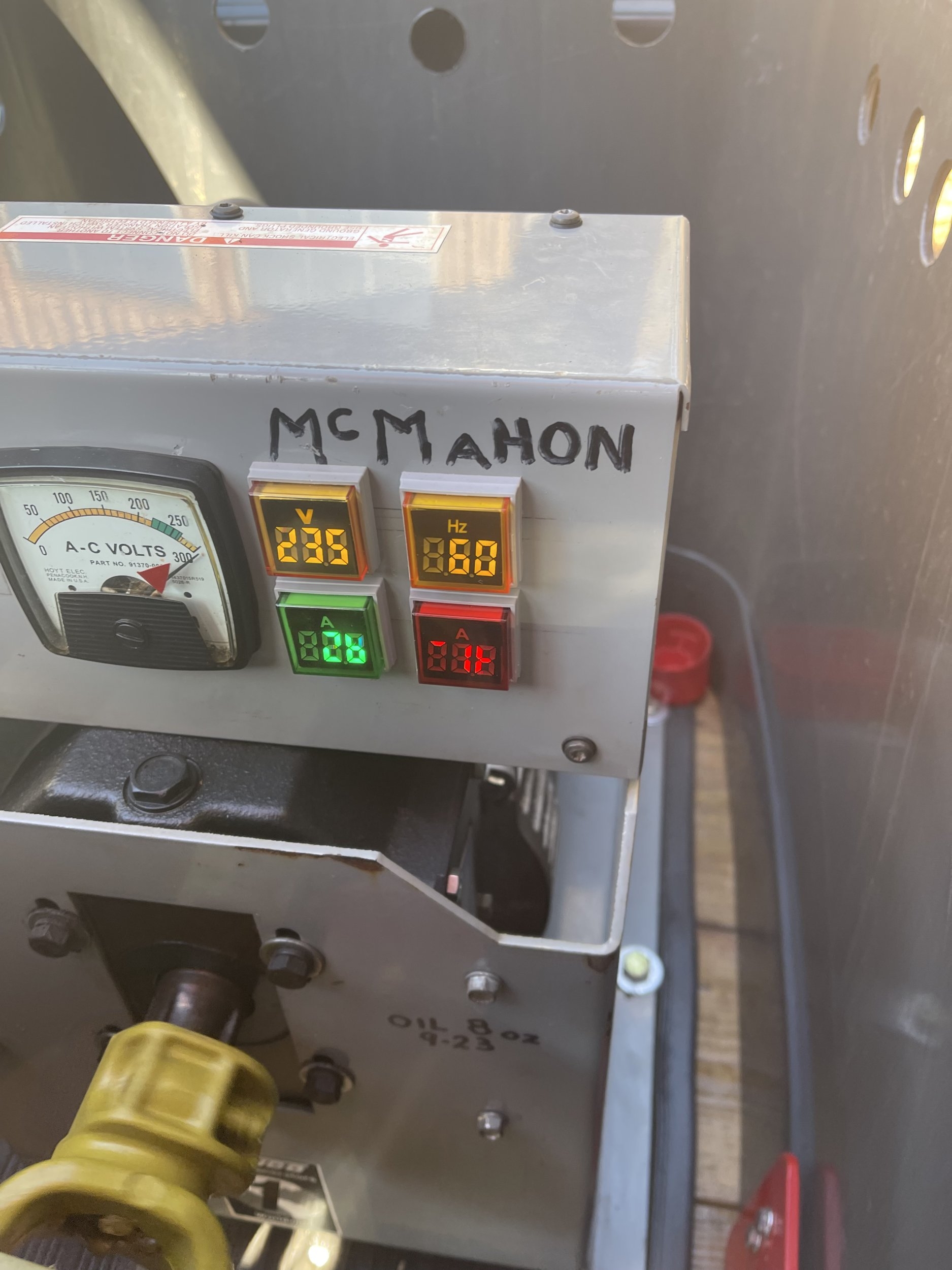

10kW , 515rpm, trash can enclosure. Help keeps it clean stored in the tractor shed. Need way to monitor when running. Have gauges both at the generator and by the TV inside the house. With PTO generators hertz as important as voltage to monitor power.

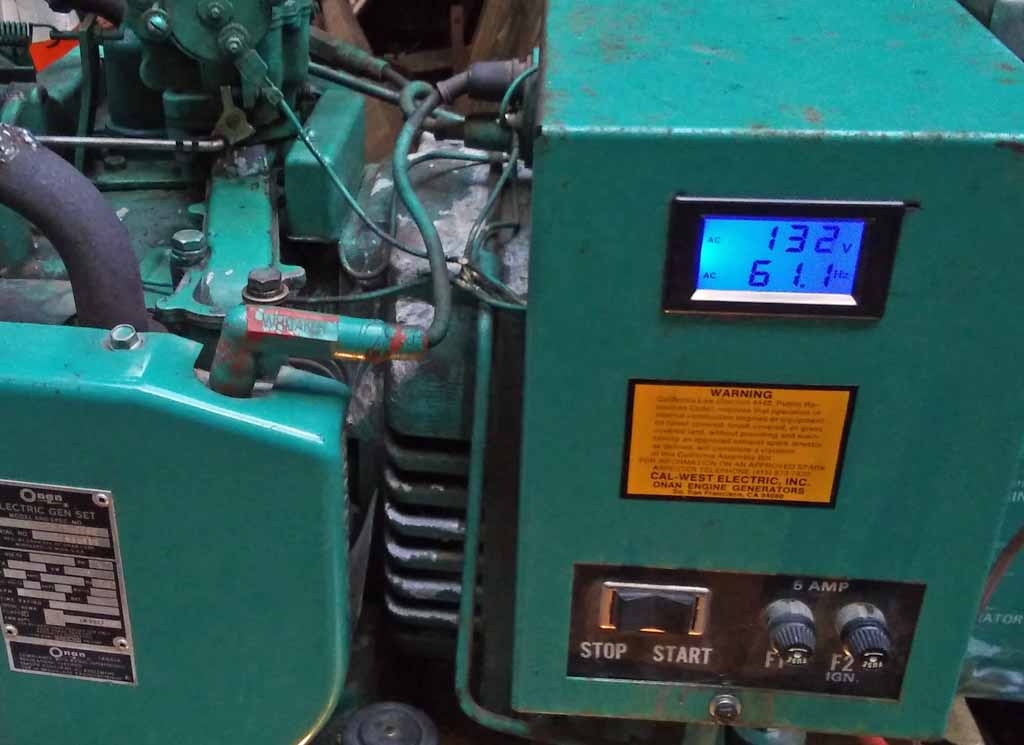

Frequency is very important, yes. I added this cheap gauge to my Onan RV genny that I refurbished. You could install it anywhere. This one is only 4000W, but 1800RPM 2-cyl. 44yo. About 1/2-3/4 gal per hour, gasoline.

Those old Onans are great generators, and seem to last forever. I had an 1800 rpm 4kw Onan in my previous small motorhome.
