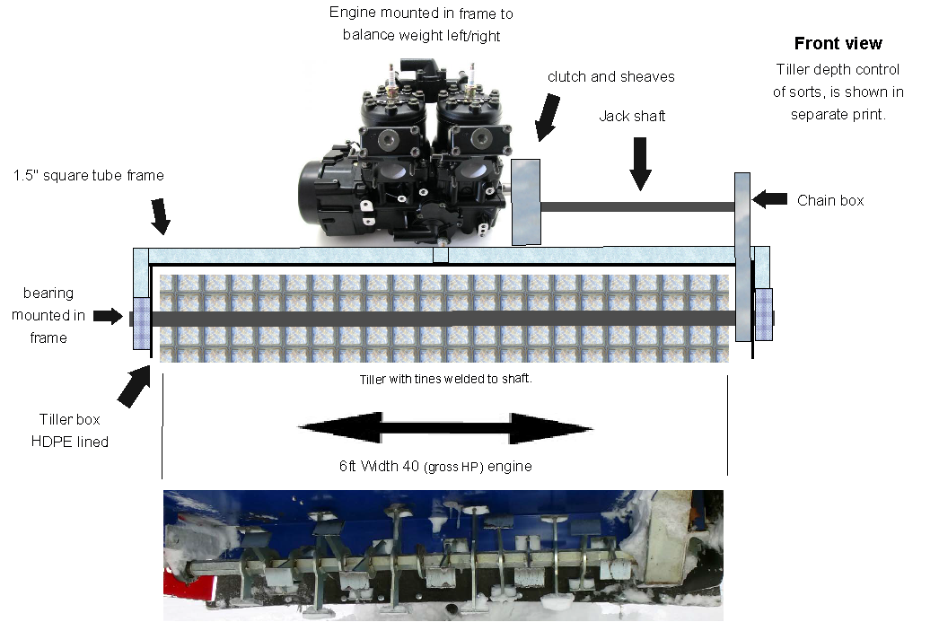

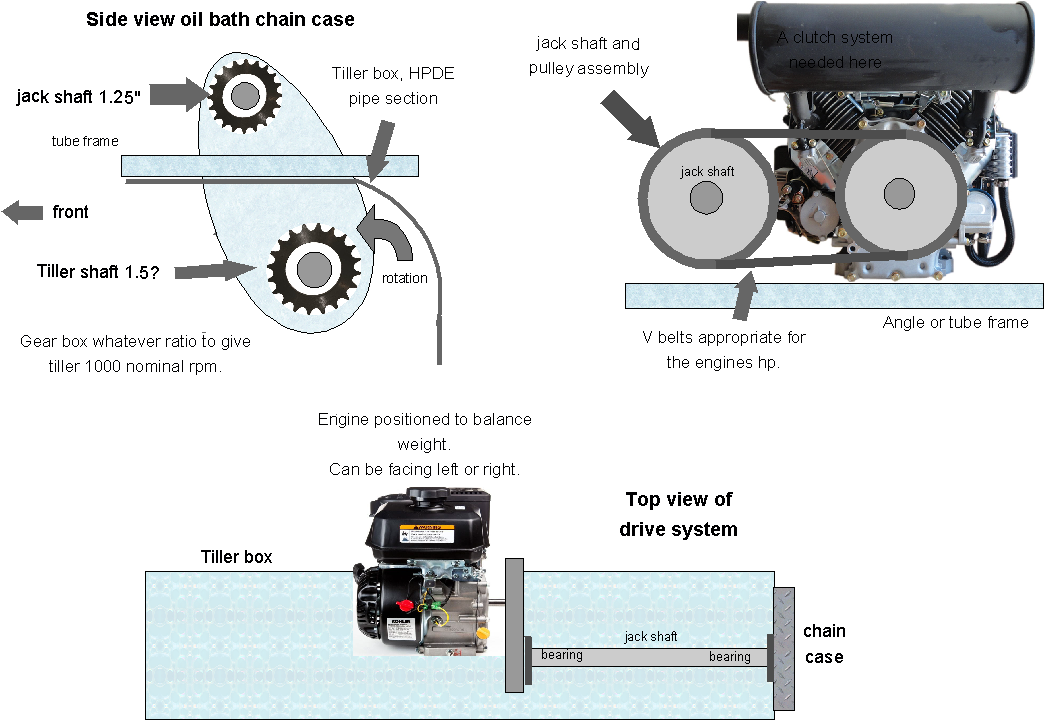

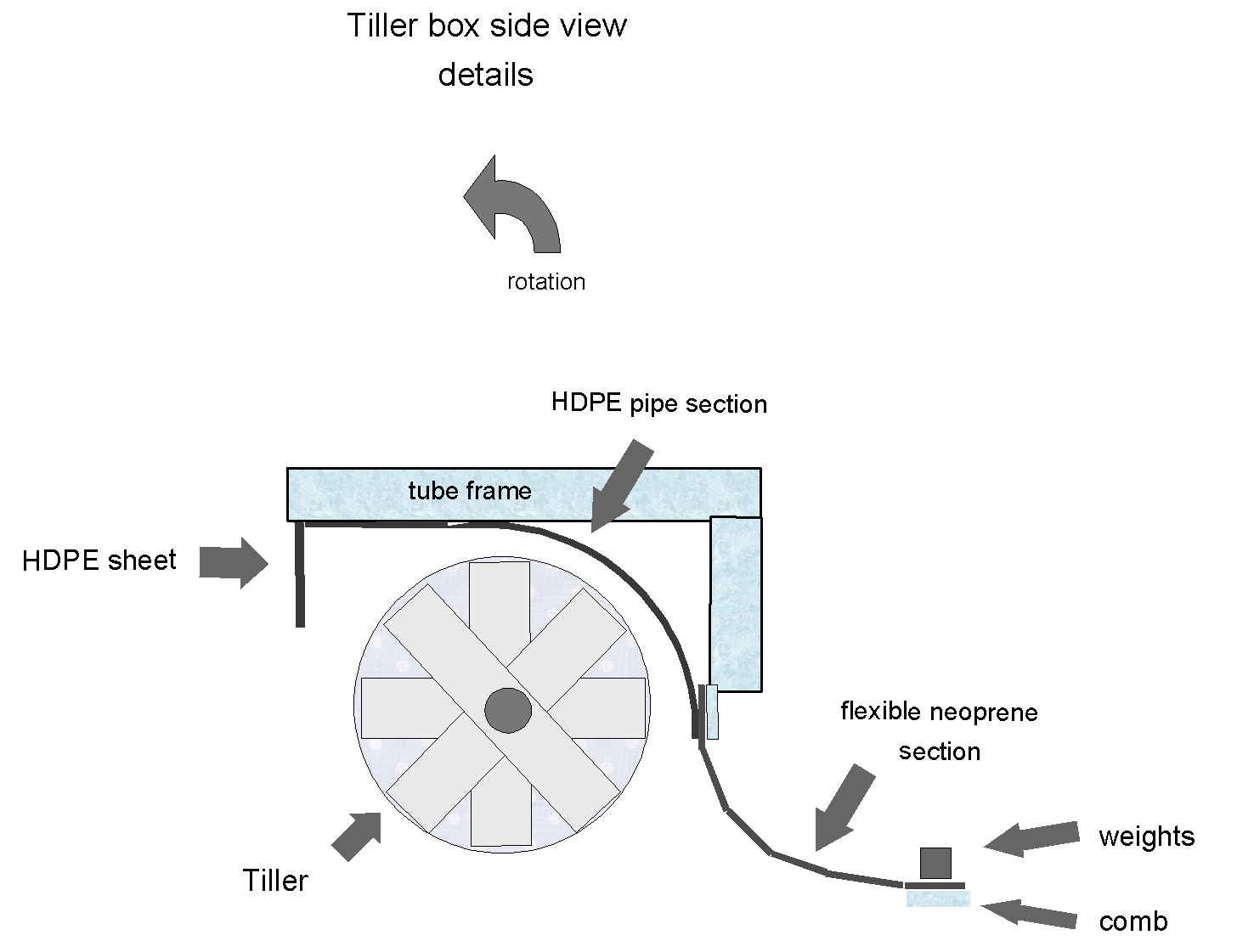

electric PTO clutch and shaft size help!
I'm assembling a mini tiller what is used within the cross country ski industry to chew up hardened snow. There are a few made in the EU, but these do no fill the needs here in North America and are toooooooo narrow or under powered in general. The one I've been asked to assemble with be 6ft wide and be powered by a v-twin engine, putting out 37 or so HP. The HP per foot is already been established by the alpine industry, so I'll stick with those approximate numbers. The engine's we're looked at come either with a 1 and 5/16 or 1 and 1/8 output shafts.
In the below print, you can see a jack shaft that bring the power out to the implements end and connect to chain box that will of course run the tiller. The tiller will need to be ran at 1000 RPM, give or take so will need be a 3 to one reduction. Off the engine, we've like to use a couple of 5vx belts to power the jack shaft off the engine. Here on the jack shaft, we'd like to utilize an electric PTO clutch that can used with dual, 5vx belts. Two questions for you mechanical gurus here are below. :)
Would a 1 and 1/8 size mild steel jack shaft be sufficient if its 2 to 4ft long? Engine will be position so as to balance the implements weight so the jack shafts length is not know at this time.. An where can we find a PTO clutch we can use and has 2 belts and can be used with a 37 HP engine. Obviously it needs to be 12 volt and no brake is needed. Start up will be at idle or low RPM and system inertia is hard for me to describe. I guess it would be like a 6ft wide dirt tiller. Options????

Torque on the clutch will be a limiter. You can put it on the engine side if you can't find one strong enough to handle the torque after the gear reduction. Could you use an operator operated belt tensioner as the clutch, like some riding mowers?
/ PTO electric clutch help! #3
Once you start digging that tiller will act like a vacuum and it will just skip over the surface as you are essentially trying to dig in gravel pavement.
you need to know is that placing the engine in the center with the jack shaft is counter productive and wastes power as the best way to run a tiller is with chain drive using the engine on the end of the tiller over the driven gear to provide the power needed. The belt drive will not work well as it will slip too much.
Before you go too far you need time to you run the purchasing and labor numbers and you will find that purchasing two of those units and having them shipped here in 6 weeks will be simpler and much less costly.
You will be able to make tandem hitch for them with a little overlap and cover almost six feet at a pass so the speed will not be an issue and repairs will be easier to do. Even if yopu add a third unit you will be able to groom a little less than nine feet with a three unit tandem hitch.

I already drew the prints up for an actuator operated idler on the two v belts. That is a very doable design, but if the machine operator "suddenly" finds that hidden stump banging against the tiller, a PTO style electric clutch would be a more of a immediate disconnect of the tiller, from the engine. They do make them for this much torque/hp and they even have them on many compact tractors. I did email Warner asking them what they offer, but no response as of yet...

Warner makes multiple vbelt clutches, you will need to give them the torque and hp numbers you will be imputing before buying one. There is also another company call Extreme that makes quality electric clutches and they are much cheaper than Warner or Ogrua. There clutch pullyes are made out of billet aluminum and I have used them with good results. They also have a one year free replacement warranty. The mention of going with gear and chain drives I am opposed to. Anything that is going to be subjected to shock loads, belts are a lot more forgiving than chains and gears. I wouldnt worry about belts slipping, stump grinders and straw blowers use belts all the time. Better to slip a belt than break a chain.
Thanks Mudd, that was very helpful! I knew that Warner makes PTO clutches large enough and I did send them an email asking for specifics, but sometimes these large companies never respond. To busy for customers? I will now try an email to Extreme with details, and see what they can offer. The belts were added and desired for the very reason you mention. That is to insulate the engine from load shock. I've operated combines with a CVT belt drive which did not slip. Go figure.

I dont know if this number is still good, but Warner 815 389 3771. I talked to them about a electric clutch to pull a large water pump once. They spec'ed it out and it lasted for probably 10 years before it finally burnt out. I think the engineer I talked to was named Dave, but he has probably retired by now. I have the number to extreme somewhere. I found them very helpful and have bought 2 clutches from them. Again, its been a while. I did have a warrenty issue on one clutch, I called them up and they found when I bought the clutch and said it was fully covered and mailed me out a new one, I had it in a few days. still running it on my zero turn.

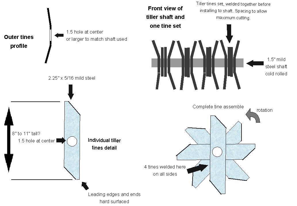

Does anyone have suggestions for shaft sizes??
The jack shaft I was thinking that 1.250 which largely matches the engines output shaft. Could we go smaller? The tiller is much tougher for me to guess. I'll include some photos of a one built in Italy but its a more narrow version, like just 3ft wide. Maybe 1.5 or 1, 5/8 mild steel for this one?

With the tines solid mounted I'd think that bending strength if it hits something would be a concern.
Maybe a larger diameter tube instead of solid rod, for more bending strength without more weight?
Are you using a two stroke engine or was that just a stock pic?
Not a 2 stroke. We'll use either a B&S or Kohler V-twin that's about 37hp which are 4 strokes. Manufacturers of the large tiller do indeed use a structural tubing for the shaft but us simple guys working in a amateur shop, need to keep it simple, stupid. :) I'll attach a photo of a manufactured one.
Seems that a 1.5 shaft could do lots of smacking against rocks n stumps and not stay bent??

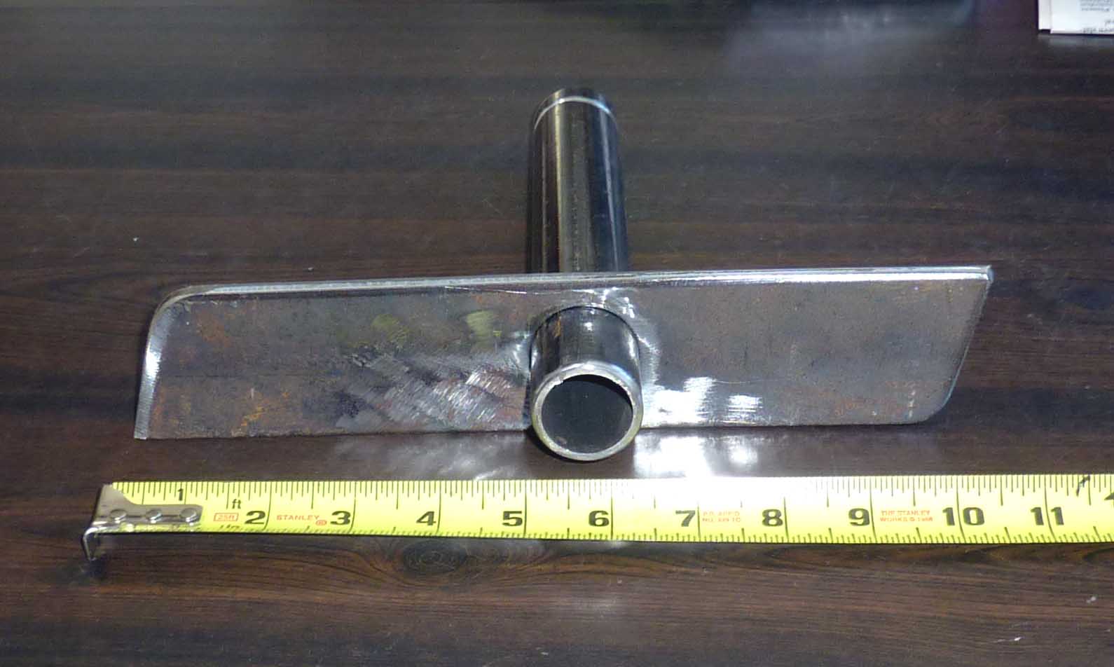

The reason I'd love to use a solid shaft is to simplify the balancing and the tiller tooth cutting. If one used a 1.5 tiller shaft, then 2 or 2.250 flat iron could be used for the tines with a 1.5 punched threw its center. This is part of my KISS design program. Here's a photo of a mock up with a 1.5 OD pipe and 2.25 flat tine.
Can you use tube steel as your photo shows and then stick a 1.5in shaft inside of it. Then use a sheer bolt on each end so if you hit a stump or something, the bolts will sheer and protect the drivetrain.
Can draw a picture of my idea if interested or do not understand

6 foot span of 1.5" rod with tines beating against the ground sounds a bit light to me, but I'm not an ME.
How often do you run across stumps, rocks, etc?

I am also worried that this is too long of a span to not get bent during a marriage with Mr Stump. Flexing would be good but a bent shaft, would be a terrible repair job and that's the reason we're looking at various alternatives.
Yes, we need this durable enough to withstand an occasional impact with something. If you assume you'll never hit a rock or stump, then you will within 24 hours. :confused2:

The pins you speak of must be the same as walk behind snow blowers have in there gathering augers. At least, all the ones I've owned have had shear pins there. We hope not to use shear pins,,, but to address my lame 1.5 shaft strenght, I was contemplating welding a snug fitting pipe 1.5 ID pipe between the tine sets for part of the tillers length. Maybe just for the center half? The center portion would be the weak point and if there are 100% welded on, they would reinforce the shaft. Small minds pondering much....

[/QUOTE]You can weld in parts to try to strengthen something weak but if it has problems, it will be back to the drawing board. With sheer pins, you have protection for that weak part. Just replace 2 bolts and your fine.
On a brush hog you will either have a soup clutch or shear pins as the weakest link in a drivetrain. I would try to mimic that idea if I knew where the weak part is as you do to protect it.

As far as I can tell, there are no shear pins being used across snow tiller industry. I'm not sure why this is, could be the tillers spin in a direction that lifts it when it strikes something. Could be they can do this because they are hydrostaticly driven... If we drilled a 1/4 pin hole in this 1.5 tiller shaft, that would very much create a weak point in it. I"ll add two more photos of manufactured tillers. The 2 belts and electric PTO clutch are added in part, to allow for a soft connection to the engine.

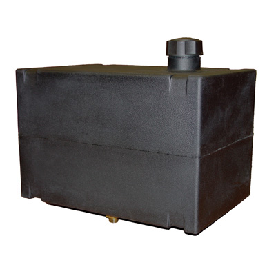

Seems we can get a Vanguard B&S or Kolher engine in the 37 HP size for around $2300 but it will need a battery, pump and fuel tank. Has anyone seem them for less??
So we're also looking for a universal, poly, fuel tank in the 10-+ gallon range with a gauge in its cap and bottom drain. Has anyone seen them? All I've found have a plain cap and do not offer the gauge type..

That sounds like a pretty good price for a new air cooled engine that big. Used is another option, but that size isn't nearly as common as the sub 25 or even 30 hp range, from what I've seen.
A boat fuel tank may work for you. Many have a built in site gauge. If the engine you pick has a fuel pump, it should draw from a top pickup. The fuel tanks on my zero turn draw from the top, with a vacuum powered fuel pump on the Kawasaki engine. The tanks are mounted about the same height as the engine.

Seems that these higher HP 999CC V-twin engines are relatively new and higher in price. The $2300 one did not have a muffler and most have been in the 2400 to 2800 range. All these do need pumped fuel to it which seems is pretty easy to do. That is, have tank draining into a filter, then electrically pumped to the engine (correct PSI of course). So far, I can't locate tank that comes with a gauge and bottom drained. I did email the company who retails this round one like pasted below and they did not sell gauges for them.... How do the people who use them, know how much fuel they have???!!!
