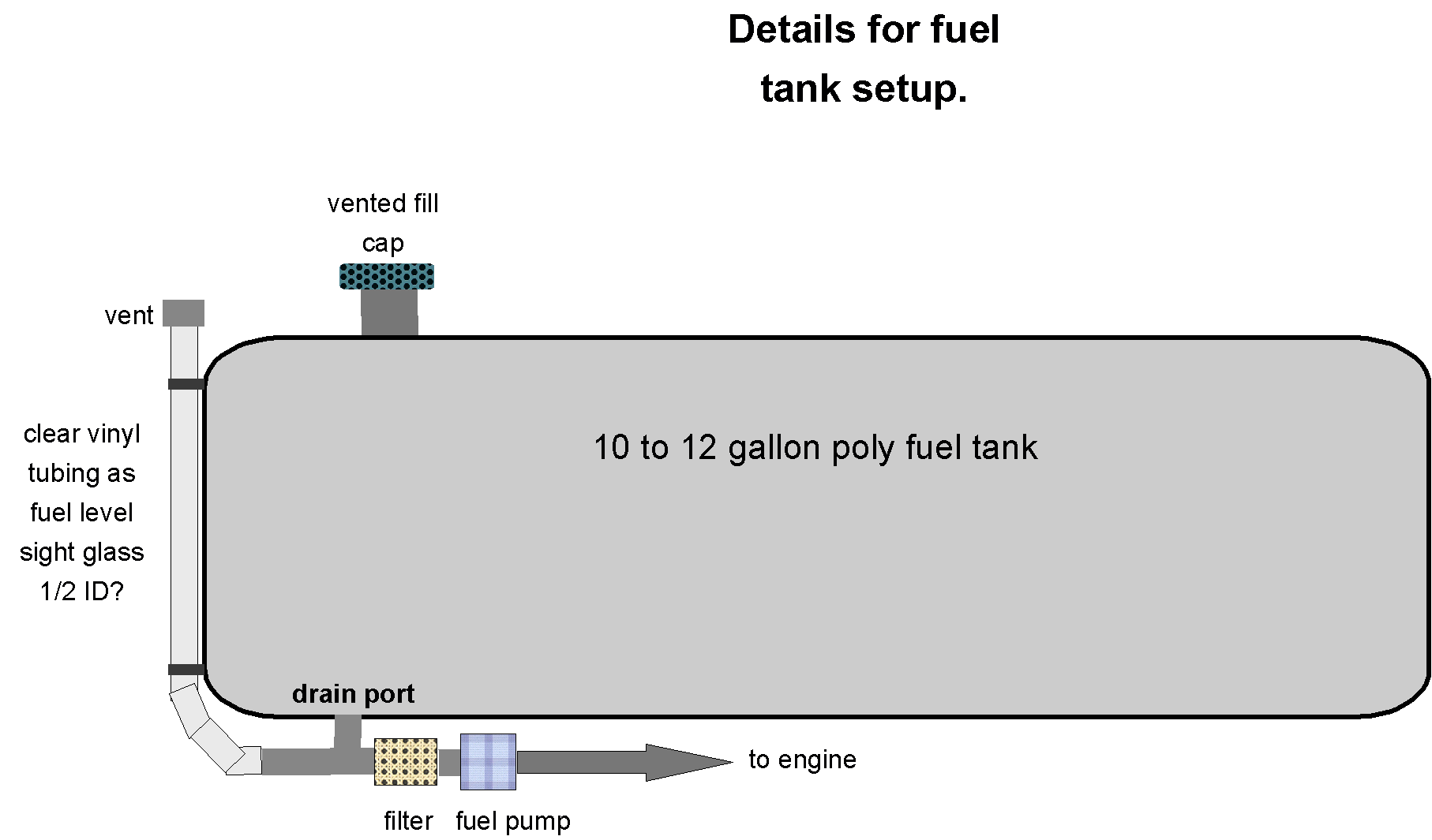

fuel tank setup, help!

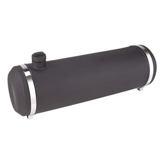

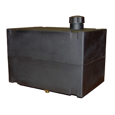

As stated above, we'd like to use a 8 to 12 gallon poly tank that sheds snow. Many of these universal tanks I found have low mounted fill caps, which will allow lots of moisture being added, every time the cap is removed. Also while working in snowy, cold conditions, large caps are a plus! Because we are normally wearing gloves. The print made below is based on the round poly tank as seen in the other photo. I gave up looking for a tank that came with a fuel gauge cap. Any suggestions??

Put the sight tube in the middle of the tank. If it's at the end of the tank and the unit is tilted, gas will leak out the tube's vent.
The filler cap vent will have the same problem when the tank is full. Maybe you could extend the filler and run the sight tube into it? Or tee the top of the sight tube into the filler or top of the tank, run the sight tube higher and have that be the sole vent for the tank.

Most fuel tanks have a fill pipe that extends slighty below the tanks top, thus keeping people from filling them all the way to the top. No idea if the tank I show, has this option or not, but it is reasonable to simple ask people to not fill it all the way.
I have no idea where the drain fitting is located at this tanks bottom, but seems the sight tube should be as near as practical to that, and its height will be X amount above the tanks top. My crude prints just aren't that detailed! :confused3:
