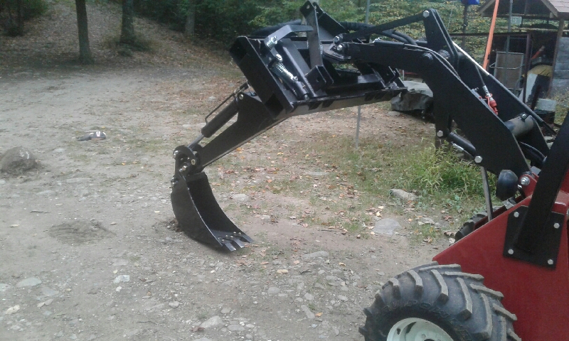

My front hoe pops off the Chineese quick attach if I pull to hard. I think I will cut off the SSQA plate and weld a Power Trac blank plate, this will make the visibility better too. I wasn't sure I would like the front hoe, but it is very useful. It shows me how much better the PT quick attach is designed over SSQA. And I am glade the hoses were long enough for it to reach the ground:thumbdown:

Plus you'll save some significant weight if you remove the SSQA hardware from the hoe and the PT, and just use the PT QA, plus gain some visibility.

I kept it with the SSQA because I was concerned with resale value if I didn't like using it. Now I am just trying to figure out if it would be better to cut/weld the plate at 90 deg angle, which is what PT is doing, or at an angle to get more lift height (like most of the PT attachments). Also do I leave it full length or shorten? One reason I didn't by an original PT mini hoe is they are all the same hoe sold for a small PT422 up to the largest tractors with the only difference being the mounting plate. Keeping it longer doesn't seem to hurt the digging power because that comes from curling the bucket and reversing the tractor, it just reduces the lift capacity which even with the SSQA mount and the SSQA to PT adapter, was very acceptable. So it is on the list to dig out the plasma cutter and a new tip.
I am very disappointed with the adapter. The other day I moved an old stump with a fork lift attachment and went to roll the stump toward the tractor and bang, there was the forks, separated from the tractor.
