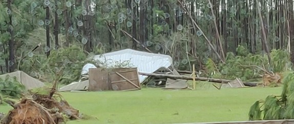

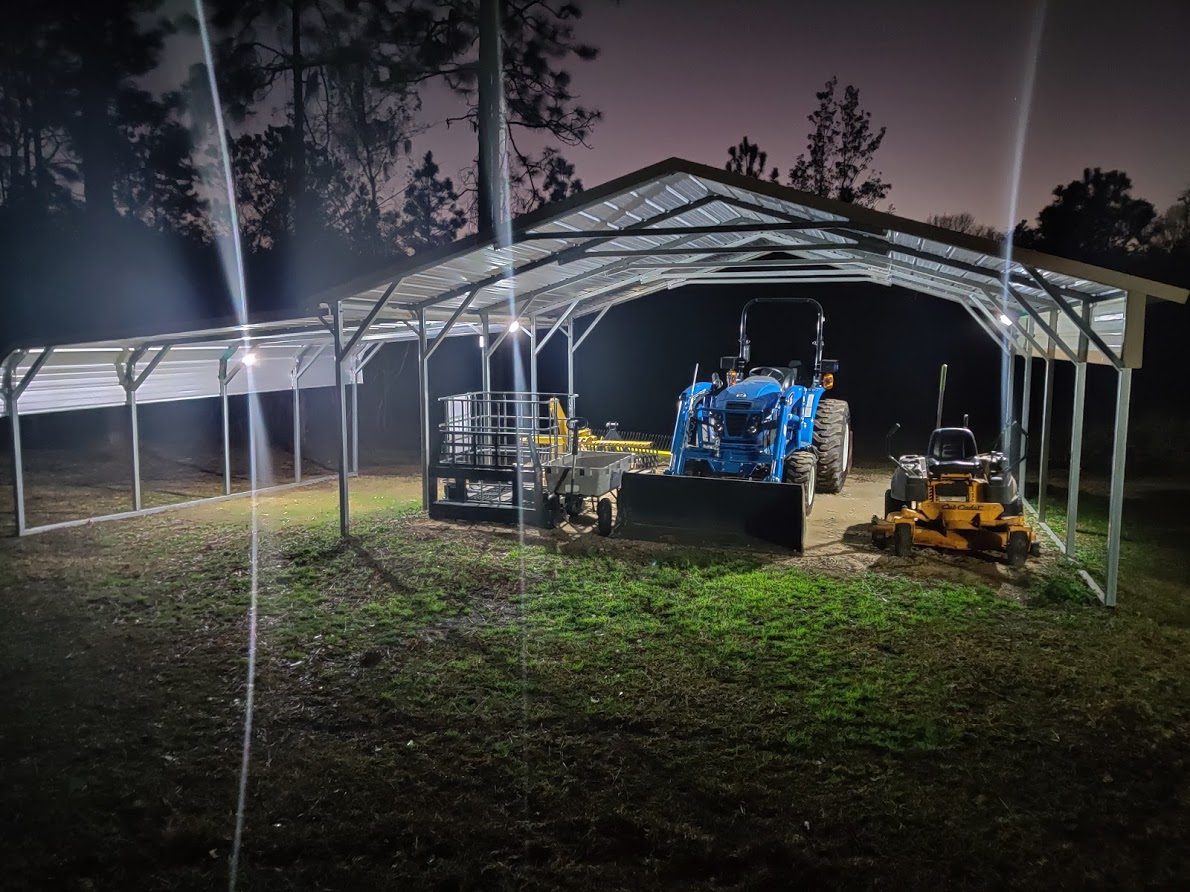

with the cost of wood these days!!!... A metal carport works just fine, can be custom sizes and are relatively inexpensive. My LS MT240 sits under one and survived a direct hit from Hurricane Sally just fine. (ours is certified)
Non-certified metal carports haven稚 earned an engineer rating for snow and wind load. Certified carports are designed by professional engineers to stand up to specific snow and wind loads in a given area. Certified carport covers may be built with additional structural tubing and include superior secure anchoring systems with extra bracing, in addition to tighter screw pattern spacing.
several years ago it was about $600 and it is 23x25ish with 7' legs. Would probably go taller these days, as my last tractor didn't have a ROPS, but the MT240 fits just fine. (The extension to the left is new, it is what was left of a neighbors carport we cut in half after a Hurricane Sally tree landed on it. We had enough scrap for a large lean to, it was completed about 2 weeks ago. I am fully confident in it's hurricane wind rating...a tree not so much.
Tree on top of the lean-to when it was a full carport:

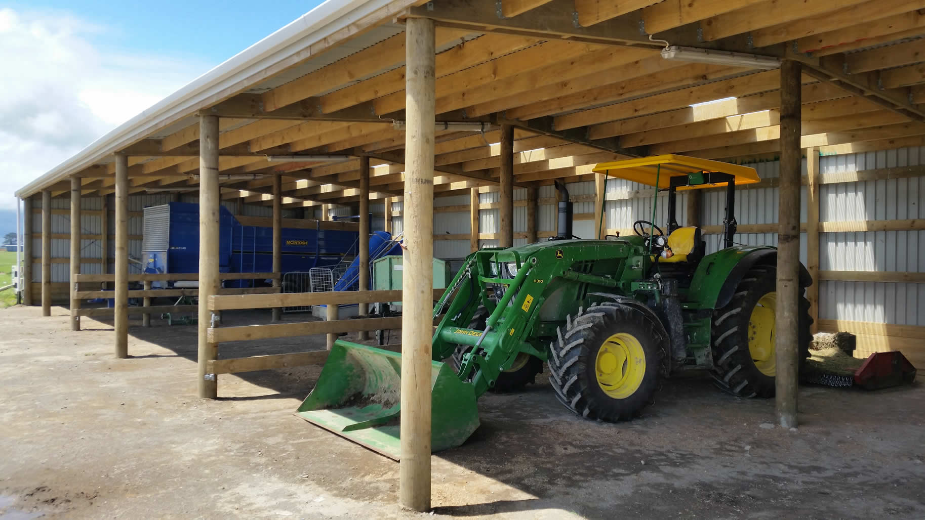

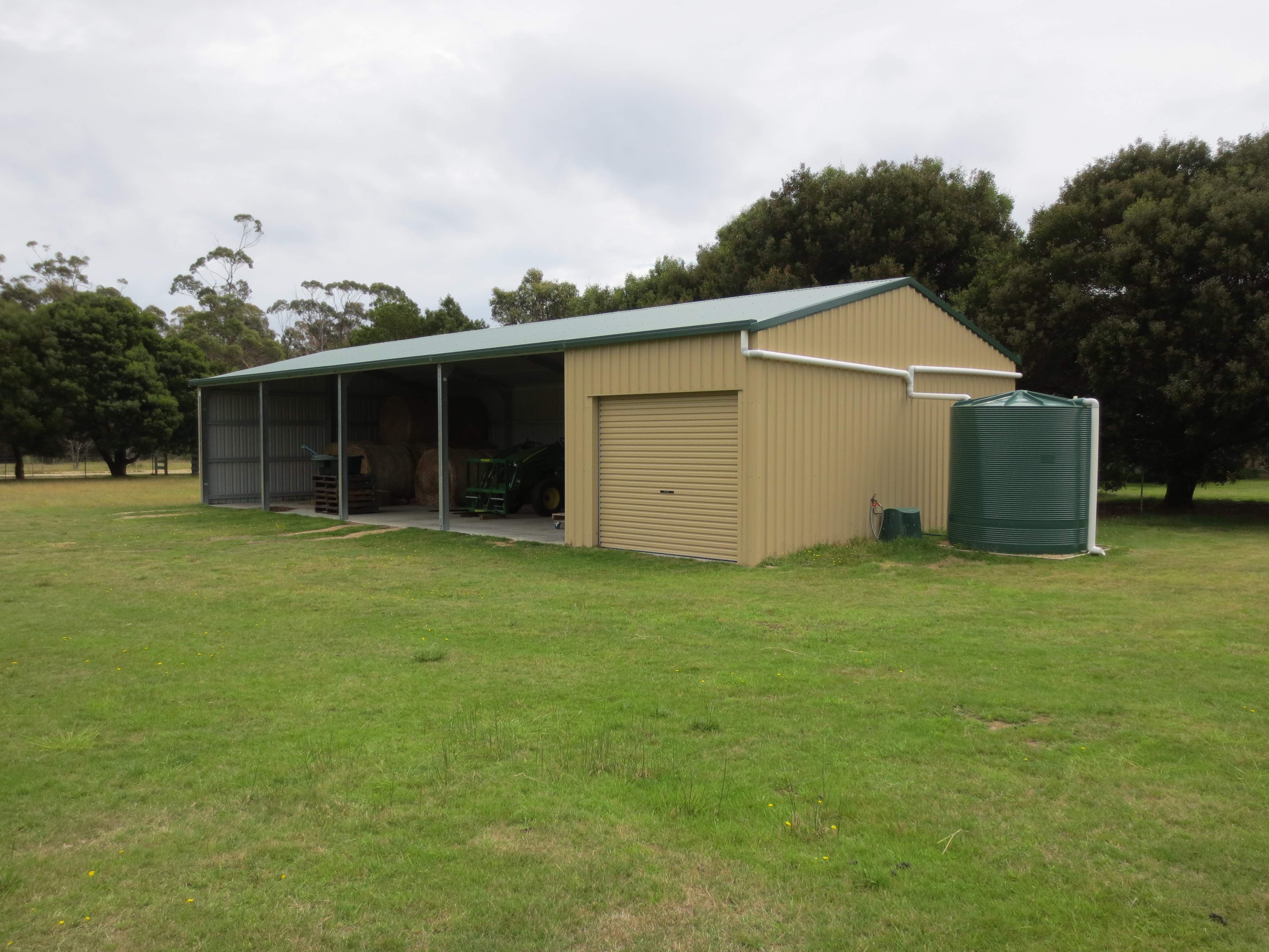

OP, when you say protection from high heat are you referring to temperature or UV (ultra violet) rays. It's the UV rays that really cause colour fading and tyre damage.
If so, I recommend orientating your future open shed facing North.
Tasmania has brutal UV exposure (right now, our Summer, we're getting Level 10 to 11 even with cloud cover). My 5-bay all metal shed, with concrete slab, faces directly South.
