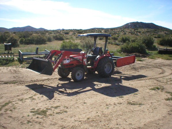

It has been asked before and yes I searched and read through the first two pages before giving in and just posting.
I am thinking about buying a Land Leveler/Grader Attachment.
My tractor HST 4x4 and is 54" wide, do I get the closest to the width, 60", or can the tractor and its 28 hp pull a larger (72") Land Grader ?
My Box Blade is 60", but I thought since there is reduced load (my assumption) on a Land Grader a larger unit would work.

I would think that the lpgs will load your tractor similar to the box blade. With my 60 hp tractor and an 8' heavy lpgs is a load in 4x4. Recognize that both have full length cutting edges and the lpgs has two of them.
I would buy the best and heaviest 54" to 60" model I could find or in my case build it myself.

I think a 60" box blade is too big for a Max 28, but I suppose it pulls OK as long as it never loads up with material. I know my previous smaller Kubota and my neighbor's Max 28 would stop in their tracks when just a 48" box blade fills up. I run a 60" box on my bigger Kubota L3200 now, and it's an ideal size for that tractor, which is much larger than the Max. Could not imagine that size box on a Max.
Generally, go wide enough to cover your tire tracks by an inch or two on each side, and thats it. And by tire tracks, I mean the tread pattern on the ground. I think you'd find that your tread pattern is quite a bit narrower than 54" width on the Max (it sure is on my neighbor's). We both had 48" box blades that measured about 49-50" overall, and that was more than enough to cover the tracks on the ground.
Wider is better for productivity, but only if the tractor can pull it with authority and maneuver OK. If it can't, time for a bigger tractor!
For land plane, I certainly wouldn't go wider than 60" on a Max. Something in the 50-54" range would make sense to me. Remember, it is a subcompact tractor.

Lots of variables, weight of the unit itself, type of material being graded, how you actually use and control the implement.

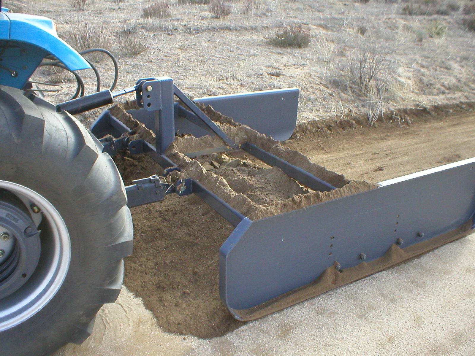

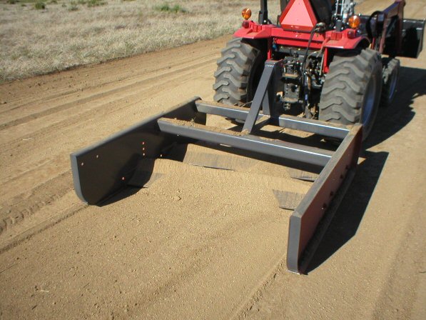

I have an 800lb 60" unit that I use behind my 5000lb 3215 HST Mahindra. While I could probably pull a lighter weight 72" unit, my 60" unit is at times all my tractor wants. As far as no material build up in the box, again that falls into the variable column. I don't have any pictures of my 5' LPGS full of material, but I do of my 7' one. If the moisture content is right, I can have the entire area between sides full if I want. Again it depends on many variables.
I would get a 60" unit for your tractor if it were me. Probably going to be pretty tough to get anything much heavier than something in the 500lb range unless you build it yourself.

1" below sides. Depending on your grading technique if that is a problem or not. If I just put the 3pt lever all the way forward so that the implement can make that full 1" cut no mater what, it usually will end up stopping the tractor. But if I only lower the implement to the ground and use the position control to hold at that level, that seems to work well for me and then I fine tune the cut using the hydraulic top link.
As far as size, I would go with a 6 footer, as heavy as you can afford. I typically like the Grademaster units just not a fan of all the hydraulic add ons. Welded units work just fine.

The Max 28 is 54" wide, so the closes and slightly wider than the tractor Box Blade would be the 60" unit, maybe a lighter weight unit than the 800 lb unit.
Same for the land leveler... 48" is too narrow for the tractor, so a med or light duty 60" unit is called for.
Maybe more depth control is needed too, I will have to watch out for this situation.
The tractor came with a 500 lb 60" Box Blade, so it is going to work one way or another but the new Land Leveler I need to check out.

Was looking locally for a Land Pride GS1560.
Found a shop selling them for around the $1200 mark, delivered.
Land Pride suggest the 60" unit for the Max28 so I am thinking I am in the ball park with the 60" implements.
