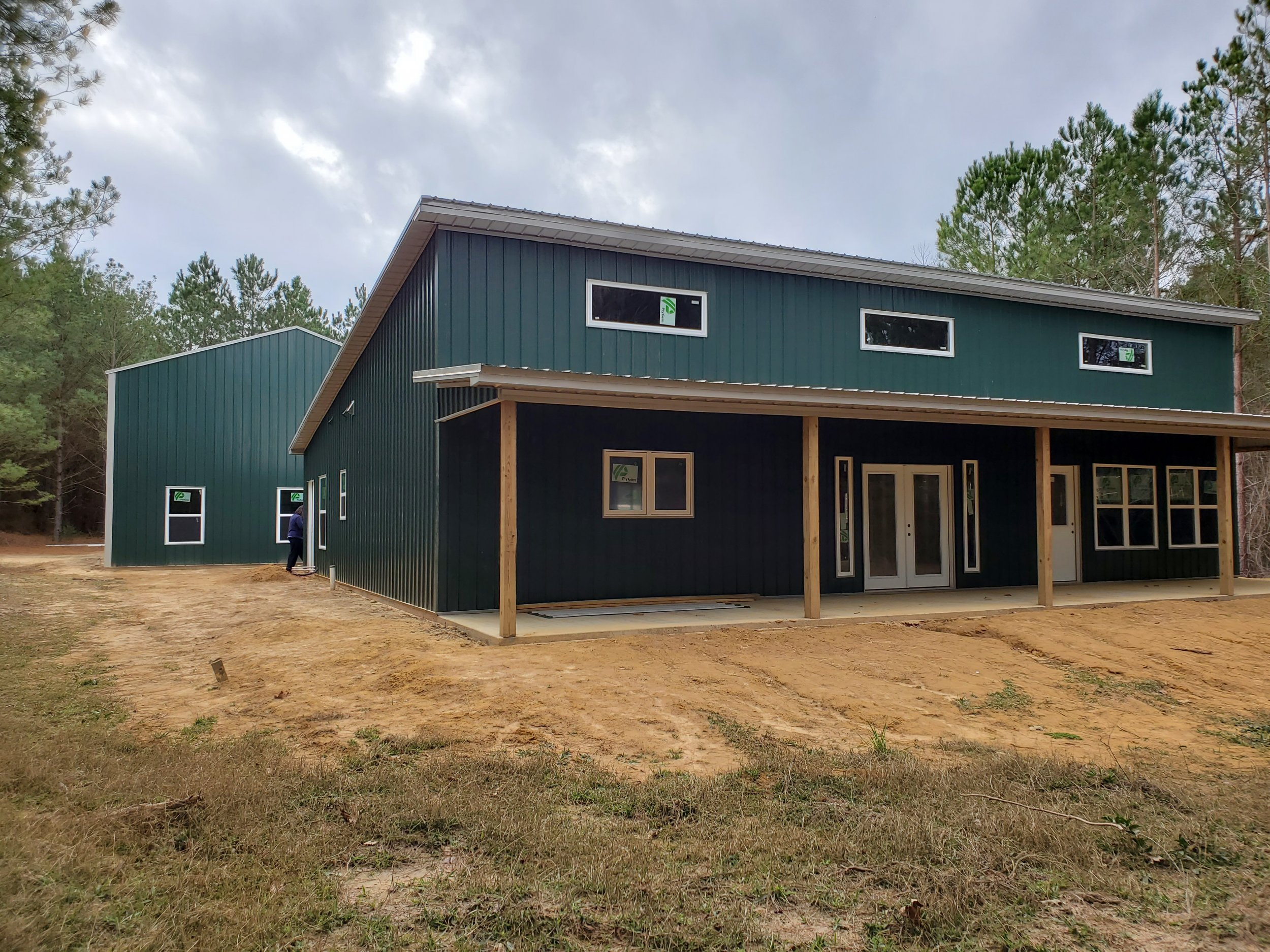

I'm a big propronent of a commssioning report on start up (AKA start up sheet) with a new system because that data can hold valuable information down the road if a problem does arise, and it could point out possible issues with the system from the get go. I'd would guess for all the issues that homeowners have with HVAC systems in their homes with equipment failure, less than 10% are due to actual issues with the build of the equipment and over 90% caused by installation.
As mentioned, for the static pressue and CFM's, all the data you need to compare is in the air handler instruction guide.
For a 2,000 square foot house and the way the dehumidifier is piped in, I'd look at the instruction manual for that unit. Looks to be 4" supply unisulated flex which leaves me scratching my head (only thing I can think of is the installers figured it was a conditioned space). I'm not familar with Santa Fe, but am familiar with another brand, but at the end of the day airflow is airflow no matter what brand.
If a permit was pulled for the build of the house, you do have the rights and the expectations that a job was followed to code. The ONLY thing I really like about an inspections department is if you feel that something was done wrong, you do have the right to file a complaint, and if there is anything the inspections department doesn't like better, it's a complaint about the installation habbits of a business LMAO
Absolute worst case address any concearns with the builder in writing and you better get a response back.
That said, if you're happy with everything, it all comes down to the expectations of the person paying the bill.

On my few residential installs I took the advice of a retired A/C contractor who told me to oversize the return ducting and register and put a 180 in the return path…
For whatever reason they have all been very quiet.
Two stage blowers have also worked well as the maintain temp speed is much lower and enough to keep air
Think about it for a second and you'll see the logic behind his good advice.
All the air in the house has to pass through the return in order to be conditioned.
If the return is undersized, it's constricting the flow of air which makes the blower work harder and is likely a source of noise.
However, if you just have a totally open return, the odds are that you'll hear the blower operating.
Although the 180 does make it harder for the air to flow, it puts a sound baffle between the living space and the blower so the sound is reduced.
Using a larger return helps to make sure the air continues to flow unrestricted and offset the reduction in air flow due to using a baffle.
First hand experience...
If the return air is undersized, you not only risk the chance of noise, you also run the risk of premature motor failure along with the the risk of premature compressor failure, along with the fact that your refrigerant temperatures and pressures can be off, misleading the service tech as to what the actual culprit is if they don't measure static pressure and CFM's becuase they are only looking at the refrigerant charge.
I'm a dummy. One thing I learned is "ABC" from men much smarter than myself is Airflow Before Charge.
If I didn't mention it before, static pressure is kind of no different that your blood pressure. If you have high blood pressure, it's a sign that something is wrong with your body.
Reality is, you can never oversize a ducted return air and have "low blood pressure" when it comes to your HVAC system. The issue is generally a new home build only has so much space for ductwork.

If I were buying the OP's house, first thing I'd look at is static pressure and CFM's for the size of the house and rooms vs the an open return air into the "mechanical room".
I've got a 3,200 square foot square house. My cooling load to the existing equipment was 7.5 tons (with 3 systems, one for each floor). After doing a manual J and manual D on on the home everything was sized correctly (the owner of the HVAC company who installed the equipment in my house has since died, and his son is running the company, and the rather was GOOD). After I looked at everything, EVERYTHING was done right. Keep in mind, I mentioned here before that I came across a non lead home, 3,200 square foot on the first level only, and that load was only 2 ton. With newer homes being built, a load calculation is mandatory IMO and that information to the end user should be readily available.
