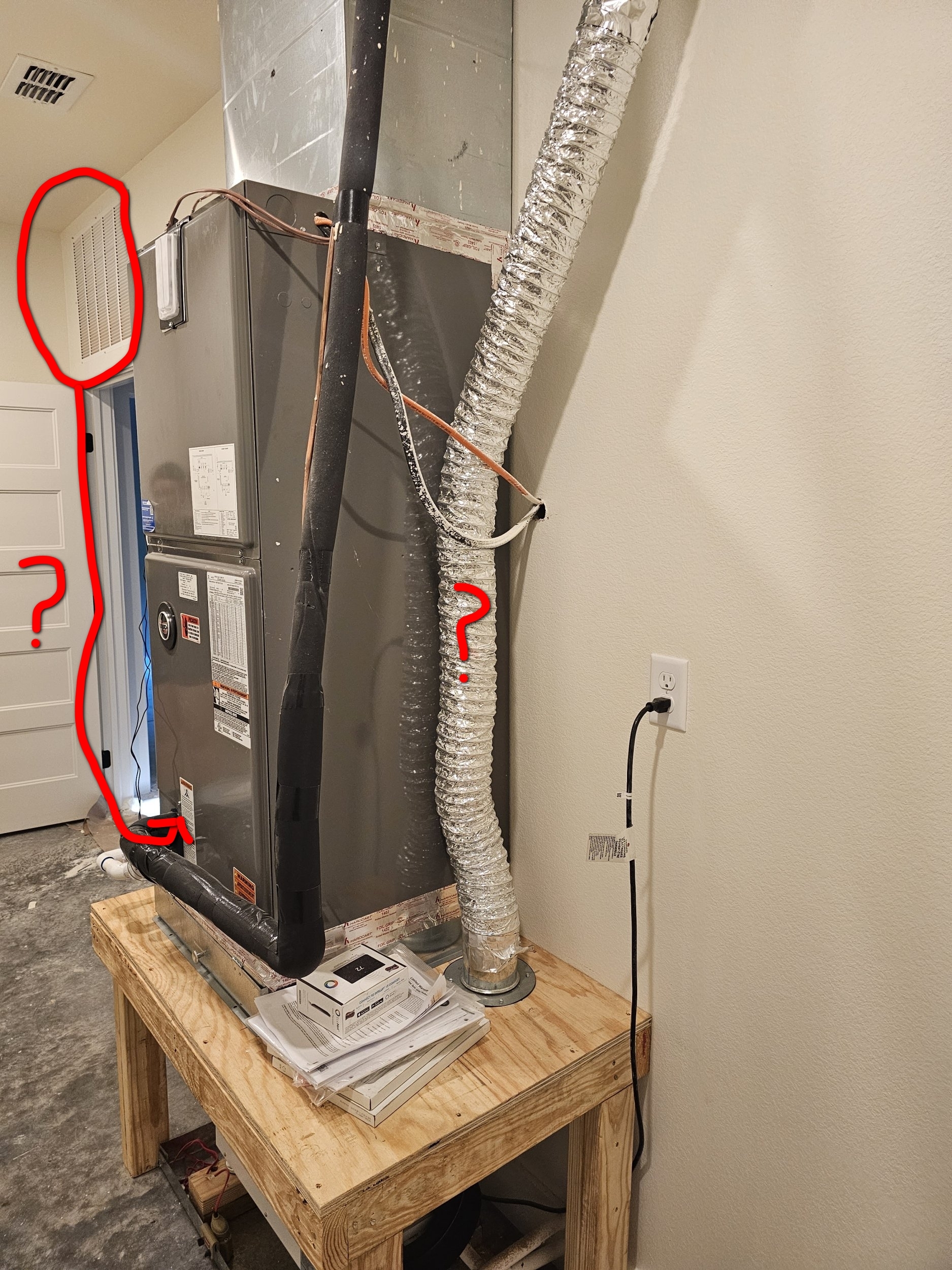

AC update: return is only coming in the above the maintenance door:
The dehumidifier is stand alone, not connected to air handler.
Here is a better shot of the unit:20230809_083013.jpg

Trying to understand what's actually happening.
So they installed a return grill over the maintenance door in case the door gets shut and then the return air is being sucked into bottom of the air handler sitting on the wood platform?
When the door is shut and the air handler is running, are you noticing much noise?
What is the purpose of the metal foil duct to the right of the air handler?
Somehow the dehumidifier is supposed to suck the moisture out of the air flowing past it into the air handler return?
Is the dehumidifier actually doing anything to remove moisture beyond what the a/c system is removing?

I thought it was up and running so they could work on the interior in the cool instead of the heat and humidity?
I haven't dealt with installing a dehumidifier in connection with an air handler. I'm scratching my head wondering why the air handler isn't just going to pull nearly all the air right into the air handler and hardly any is going to flow through the dehumidifier while the air handler is running?
Another thing that concerns me is having the air handler right next to the drywall because that could amplify any noise or vibration if the drywall acts like a sound board.

So the recommended method is to hold the air captive in duct so it can't skate past the dehumidifer like it would in an open return.

Haven't been there enough since it has been running to notice any noise. It seemed quiet enough this morning. I could see water coming out of the pipe outside, so the dehumidifier is doing something. Exterior unit was spinning away. I took a shot of it, but it didn't turn out well. For what it's worth, it is called a "Achiever Plus". Means nothing to me.
Normal operation when we move in will be door closed 99% of the time. My wife wanted the cat box be in there. It sounded like a bad idea to me. I'm working on a 'catio' setup that will keep their mess outside, but allow them access. As is, they are MIA right now, so I have more time to deal with that eventuality.
The idea is to take the conditioned air from the air stream, dehumidify it, and dump it back into the conditioned airstream.
The question becomes if a dehumidifier is worth the extra money vs a multi stage variable speed air handler system that should reduce the humidity level vs a single stage variable speed constant torqure blower motor (AKA "X-13").
Personally from my own experience, I'd just go with a base model minimum SEER HVAC X13 blower system and instead of the money for multi stage variable speed, go with a whole house dehumidifer and duct it into your system.
HOWEVER, a dehumidifier will not save you money on your electric bill. For what it's worth, my wife doesn't care 🤣
In theory, I don't think it matters. The dehumidifier processes the air it hits. The unit is moving air in the room, which is drier than outside or the rest of the house.

What I'm curious about when you move in is turn the dehumidifer off for a week and see what your RH is. Then turn the dehumider on and compare the RH values.
It looks like they are pulling return air from the room into the dehumdifier and then dumping the air from the dehumidifier on a 4" non isulated flex line into the duct system (it wouldn't make any sense any other way).
Not the way I would recommend it, but hey, if it works, it works (y)

On a new home build with you paying good money, I would respectfully tell you I would not take that attitude.
Definately get a static pressure test done on start up.
I could be over reacting as I have no clue how things are done in Texas, but from what I've seen on that system, I would definately be asking questions. That's YOUR right as a buyer.

Generally, you want to see an air handler and return done in a way that baffles the air flow and any operation noise from the air handler so it's not bothersome in your living space. If you are standing right in front of it in your equipment room, you're going to hear it directly. What you don't want is to be in your living space and hear it like you were standing in front of it because it isn't effectively isolated.
I'd want to see it and hear it up and running before paying or at least having a holdback to protect you.
Once a sub gets paid, leverage over them to get them to correct or change something gets to be harder.
Do you have power to run the system now to check to see if it operates like you want? I'm assuming there is electrical service outside...is there some way to get power to check the system operation?

It is running now. The bright side, assuming it is noisy, is that it is on the opposite corner from the MBR.

On my few residential installs I took the advice of a retired A/C contractor who told me to oversize the return ducting and register and put a 180 in the return path…
For whatever reason they have all been very quiet.
Two stage blowers have also worked well as the maintain temp speed is much lower and enough to keep air circulating.
