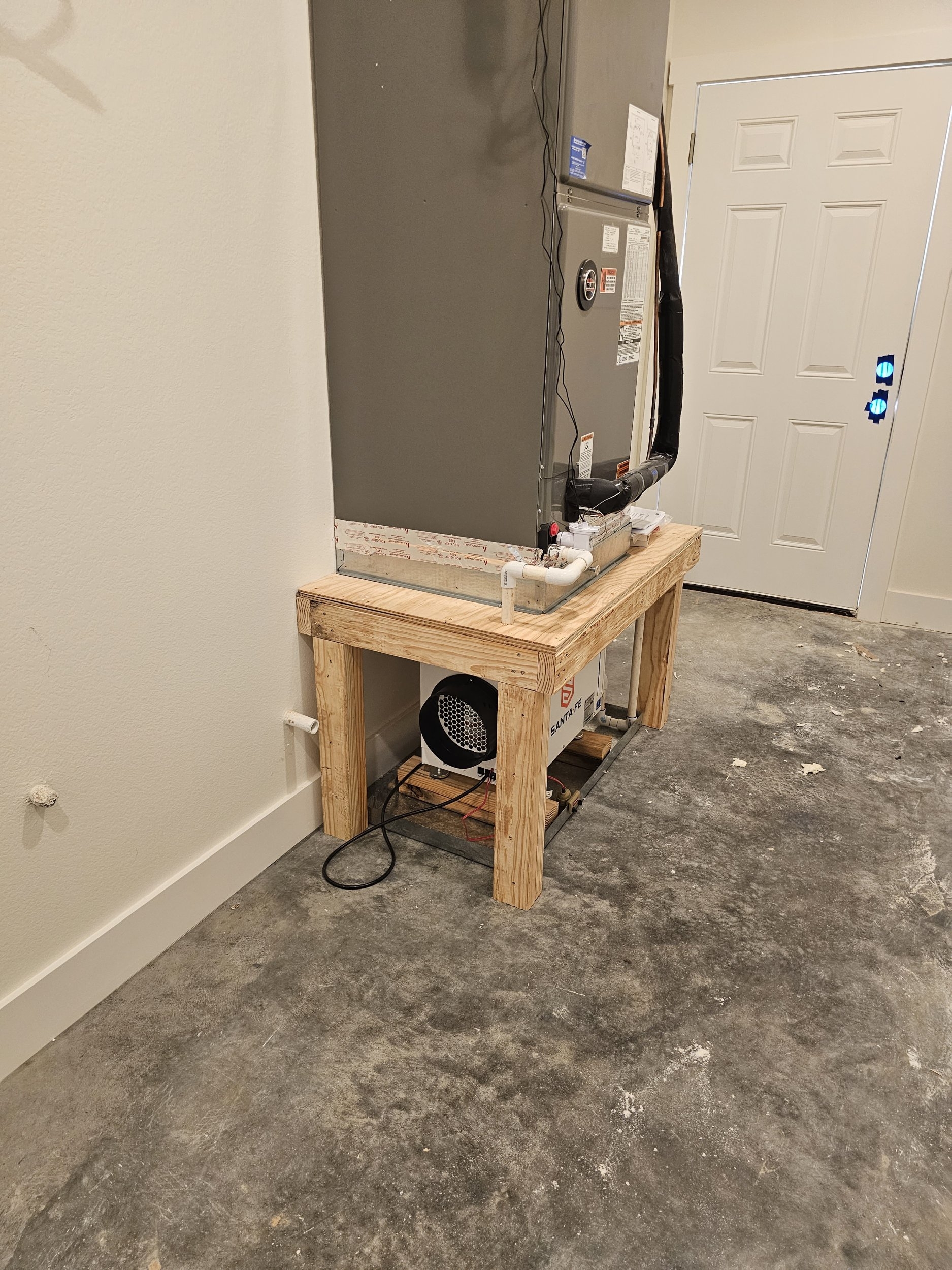

Label does say Ruud! I didn't look that close, just snapped the picture.
The quote was for Amana...now I have another bone to pick with the builder...A/C is one thing I will spe d on for good quality. I really wish I could have my Trane. Literally has saved me hundreds of dollars a month and at more comfortable Temps than its predecessor.

This is what the builder's guy installed. I think maybe it is Amana. Limited choices. We had a really nice variable speed Trane in the old house.
Was it a HVAC company who installed that air handler?
No nothing about Santa Fe dehumidifiers, but they are going to tie it into the ductwork aren't they?
I could look like an idiot for asking, but where is the return air at and did they taped the drain pan to the air handler?

It was supposed to be the HVAC guys. I wasn't there to make sure, but they sub to a local place. I don't think it is complete yet. It has been 100+ and I think they needed to get things cooler so others could work.
The return (I believe) is over the door I am standing in when I took the picture. It looked to be maybe 2'×3'. The door you can see is to the outside. I had to push a bit when we negotiated to have handler in this room rather than in attic. Attic in TX in summer is dangerous. I also didn't want to have to climb to do basic maintenance.

I see my first mistake. What I thought was a drain pan under the air handler looks to be a filter rack for a air filter, which leads me to believe that they cut a hole out in the wood stand the air handler is on, which means the return on the air handler is standing directly over the dehumidifier?
They are running an open return into the room with the air handler for the entire house with no return ductwork?

FYI Ruud is Rheem. Personally, I'd take one of those over American Standard (which is Trane). Generally however, the install accounts for 90% of being problem free or nothing but problems.

At the end of the day, it's not the brand that works best, it's the installation procedures by the company installing the equipment that works the best. EVERY manufucaturer has issues from time to time, that's a given.
When the house was designed, there were no plans to run both supply and return ductwork in each room of the house?
Just do yourself a favor, when the system is started up, ensure that you have them measure your static pressure along with CFM's. You'll find the blower data and the correct parimeters for SP from the manufacturer with the air handler instructions.
Honestly, if they are only running a "open" bottom air return off the air handler that is placed directly over the dehumidifier, I'm kind of scratching my head.

If you look at the image the OP gave on his air handler, at this point in time there is no ducted return. I'm assuming the supply duct is coming off the top of the air handler, and it may not be in the picture. That said, that definately looks like a sheet metal filter rack under the air handler (which I originally thought was a drain pan) which tells me they are running the return air directly under the air handler (why they would put the air filter there). If they are going to run any type of return duct to the air handler, it's going to be impossible with the dehumidifier directly under the return air of the air handler.
In NC, it's code for anything over 1,600 sq ft to have two return ducts.

Manual J (load calculation)
Manual D (duct calculation)
Manual S (equipment selection per Manual J)
Manual ZR (zoning calculation)
For new construction, a Manual J and Manual D should be done and followed at a minimum.
In NC, a Manual J must be done by law per new contruction, and the only time it is required to be produced is if there is an issue from the end user.
Per the state you reside in,
I'm not a big permit kind of guy (another can of worms depending on who you deal with), but as a paying end user, your expectation is you assume the guy doing the work for you knows what he is doing and you won't have any issues.
This is not always the case.
I've seen a newly built 3,200 square foot single level home only need 2 ton of AC in NC (non LEED certified). New construction along with higher insulation values do not go by the old school rule of thumb per square footage anymore for heating and cooling loads.
I'm a dummy. Don't trust anything I say, but talk to people more smarter than myself in your local area per this topic.
That said, when your HVAC system is started up, I'd highly suggest you get a basic start up sheet that the HVAC company should do for their own records which they should supply to you per your request. You should have static pressure given as well as CFM's produced by the air handler (as well as your charge on refrigerant). Honestly, for a new home build, I'd also have the contractor verify how many CFM's are being produced at each and every register when the system is running full tilt.
You're spending good money on this build, and if people are making money on this job, their expectation should be that you are satisfied IMO.
A man much smarter than myself once told me that you can't verify results if you don't record the data at hand at that point in time. Keep a record of those verifications in writing so if you have an issue down the road, you can verifty the results vs a previous "good" test. This will help you narrow down the possible issues if one arises in the future.
You may never have an issue, and open returns may cause no problem (although technically any open return by code in NC needs to be "plenum rated" which raises other concearns if there is a problem), but if your HVAC company is pulling return air for the air handler in a a single room for a 2,000 sqare foot house, I would have concearns about it myself. That said, I'm a dummy and don't know what I'm talking about, but... if they (the installing HVAC company) has a whole house dehumidifer installed with the air handler, for the money being spent, standard good practice is to tie in the dehumidifiers supply and return into the supply and return ductwork for your HVAC system. The way it looks per your pic, there is no return to tie the dehumidifier into and an "open space" return is being used. I could be totally wrong about that because the work isn't finished yet.
That said, if an open return is being used from the room the equipment is in, your basic start up sheet will catch any potiential problems with static pressure and CFM's.
