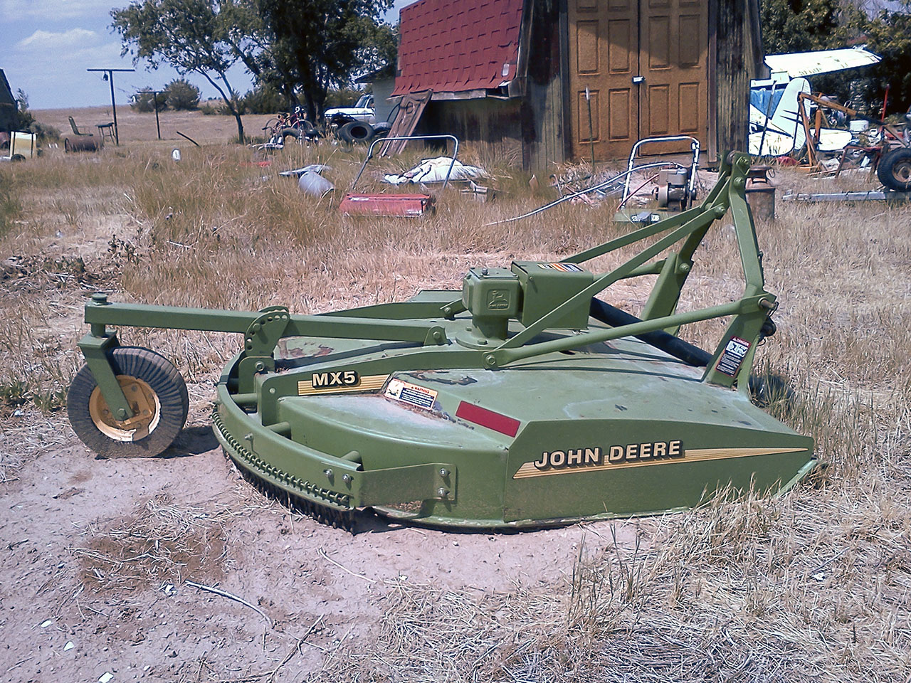

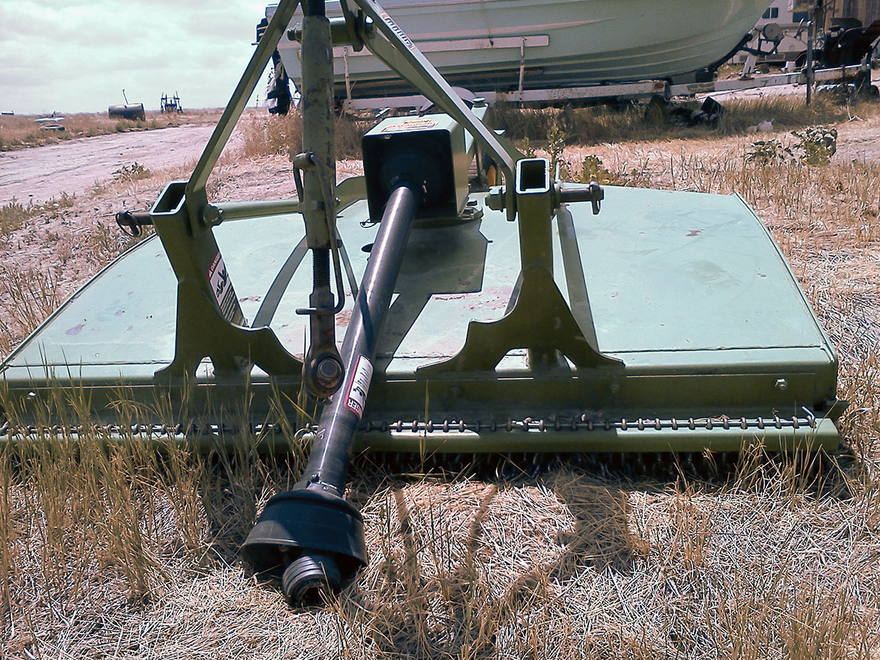

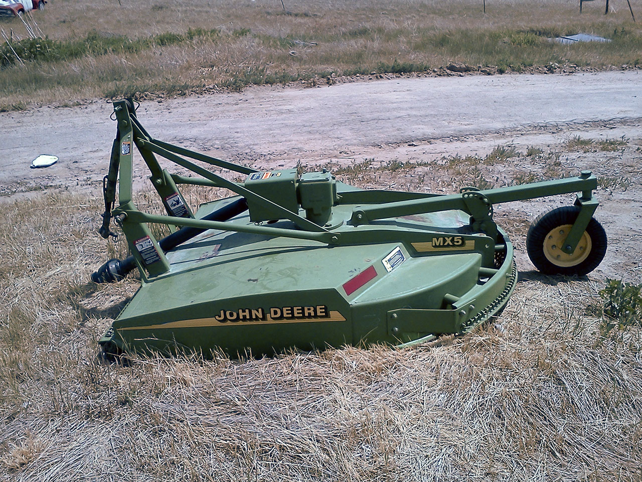

Well I did it, I was going to purchase a new landpride and came across a deal on a JD MX5. I was amazed at the condition when I went to look at it, not heavily used. It has the advantages of chains front/rear and a slip clutch. He was asking $1200 and I got it for $900, including a top llink, PTO shaft and linch pins.
Now I have a question, what size socket do I need to remove the blades for sharpening? I have a 1 5/16" and it is too small?
View attachment 274445View attachment 274446View attachment 274447
1 11/16” is the standard size for blade nuts on the light to medium duty models
