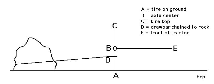

No rolling action on the part of the tire is going to cause the front to lift. If your tractor rares up because the tires are frozen to the ground, you would have to be backing up. Otherwise the torque pushes the front into the ground resulting in the tractor moving forwards. The triangle illustration given earlier is backwards.
Maybe I'm misreading the above? It seems you are saying that attempting to drive forward causes your front tires to be pressed to the ground by the torque. And that that torque pressing your front tires into the ground is what results in the tractor moving forward.
I hope I'm misreading it. Otherwise your whole understanding of physics is screwed up. Explain why a drag racing car does a wheelie. A tractor driving forward has the same forces. If you tie the bumper of a drag car to a post with a chain, it's going to wheelie even worse.
xtn
/ Preventing tractor back flip #87
The hitch geometry provides leverage to help prevent roll over, not a guarantee.
When you are hooked to an immovable object with both of your rear drive tires firmly stuck to the gound, it is actually the engine torque that is being apllied to the now stationary ring gear in the differential that causes the front end to pitch upward.
If the torque and momentum of the rising front end is sufficient to overcome the geometry of the hitch and lever arm created by your front end, you are going to roll over. The tractor will indeed appear to move backward as it continues its pivot around the hitch point on its way to being upside down.
Of course this is all assuming you haven't installed some long wheelie bars hanging off the back of the tractor to increase the lever arm that the engine would need to overcome in order to perform this acrobatic.:D

If confused draw a force vector diagram around the centre of the rear axle.
If that doesn't work block the rear wheels so they can't move and apply the power. Don't even need a load on the back end.:thumbsup:

/ Preventing tractor back flip #100
Yes of course you're right. Depending upon the height of the draw bar, how far back it is from the rear wheel center line, and the angle the chain is at when pulled tight, there is some point at which an equilibrium must be reached. So technically the tractor won't flip over on it's back completely.
That is... unless you start figuring in momentum and materials elasticity. I mean what happens if the equilibrium point is reached while 2000 lbs of tractor front end is rotating up with some speed?
xtn
How far back it is doesn't matter, how long it is and the arc its end describes as the front of the tractor rises DOES matter.
I may have made the "mistake" of assuming that the O/P would use an appropriate draw bar for the tractor in question, i.e. one that would get down to ground level WAY before the tractor gets the front wheels too far off the ground.
Sure, I can pretend that the draw bar is about as stiff as a loaf of bread and that the chain is in fact a bungie cord.
With a jerk ... ? maybe you can get the answer you WANT, but I think it depends where you run out of slack.
For as long as you have slack the chain is essentially NOT THERE, i.e. that is a different experiment, One might as well ask "can tractors wheelie ?" the answer to which is "YES".
As posed by the O/P the draw bar can be assumed to have unlimited bend resistance and the chain just doesn't "give".
This is close to reality, draw bars can be bent, but not from straight pulling - at least I've never seen it happen from JUST pulling.
