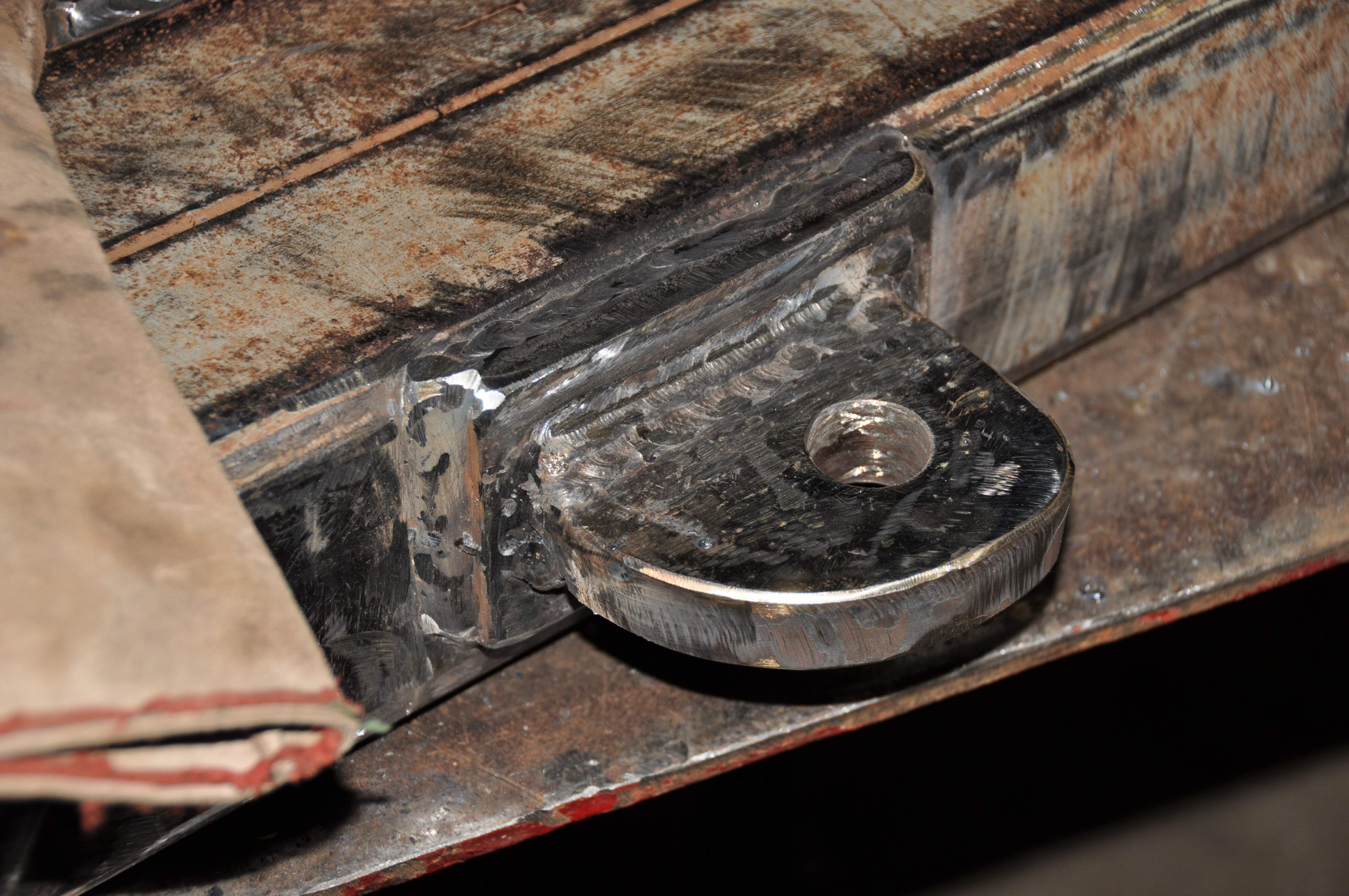

Here are a couple of pictures.
Cam

Little low in spots, but looks like you have plenty of volume of weld. Doubler plates are always a good idea! :thumbsup:

I think you are expecting too much of a little mig machine. 1" to 1/2" I would be beveling both sides of the 1" down to a 1/8" land and run 1/8 6010 root and fill out with 5/32 7014. At least 160-180 Amps. Preheat would be of no value. Warping of the 1/2" plate is your biggest problem with the heat generated by the stick welding. If you ask I have a solution to the warping. Show us a cross section of how you plan to weld this with your mig.
Ron
/ Preheating question #25
7014 for a hyd. cylinder mount? It wouldn't have to be beveled at all as long as it had a 1/2" fillet weld around it. Fillet welds are nice because they are really easy to size. As long as the leg is the same as the thickness of the thinner plate, you will have the strength of the thinner plate, thus a 1/2" fillet weld would suffice. Making it bigger gives an over estimation of strength and is a waste of time and money. If there was no room to put a 1/2" fillet weld, then beveling would be used.
