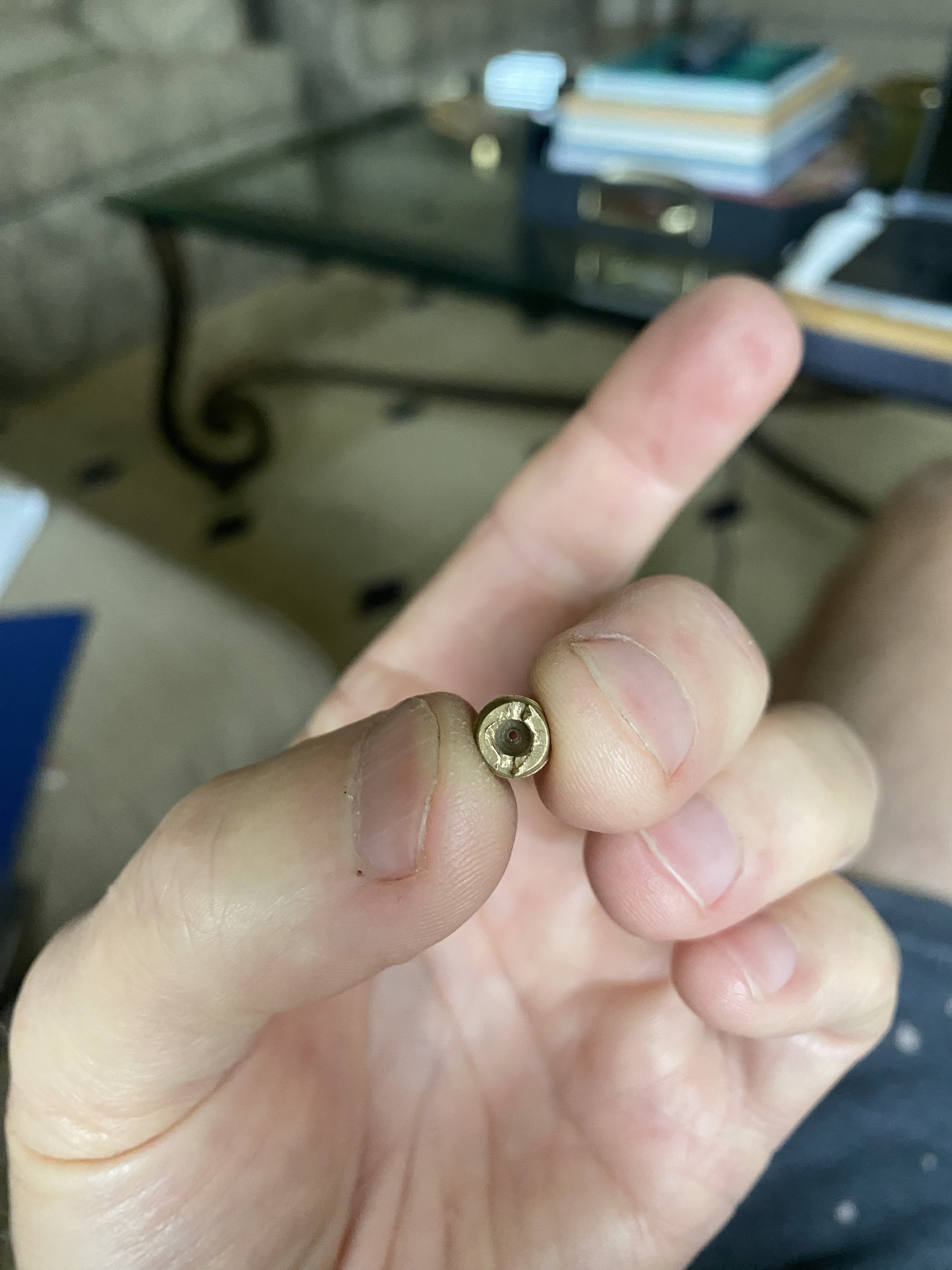

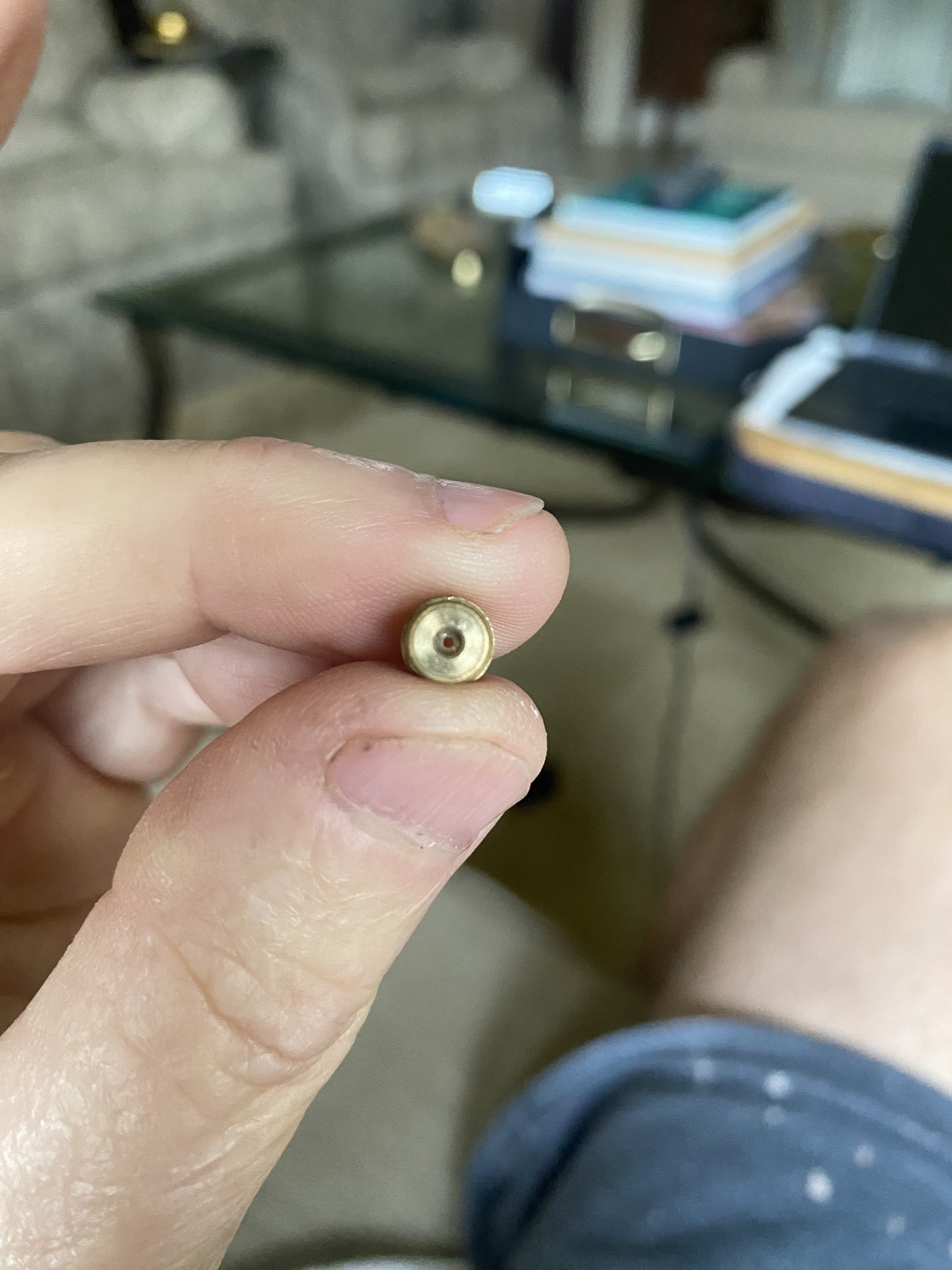

Hello to all
I have not run my powerwasher for 2-3 yrs. So, before I tried running it, I did the following:
  • drained all the gas out of both gas tank and carburetor
  • cleaned gas tank
  • changed the oil
  • checked air filter [does not have a fuel filter], it was fine
Added 93 octane gas and after a few pulls, she started, But, it would only stay running if the choke was left in the full position. when i started to move it to the "run" position, it would start to die so I moved it back to full choke. I operated it in the choke mode for about 1-2 hrs. When I ran her again, and tried moving from full choke to "run", it started to die and when i tried moving it back, she died. It would not start again.
Since it seems to be a fuel related issue, I pulled the carburetor and did the following:
  • cleaned carb (pulled main jet, and soaked in carb cleaner fluid)
  • clean carb bowl & passage ways (see the enclosed video)
  • pulled spark plug; it was badly fouled w a lot of blk carbon..so, cleaned and wire brushed it
  • added new fresh fuel again
She started up again, but unfortunately only ran again w choke on. Did some research/youtube video's, etc, and most of them state that the main jet is clogged, causing fuel starvation. See pics of main jet, front and back...it seems fully open, yes?
I am open to all suggestions to get her running correctly.

There is a tube that is above the fuel jet you pulled out. With jet removed, press down on the tube in carb throat for with screwdriver. In this tube are a series of small holes that need to be cleaned. The jet is just a small portion of the cleaning.
