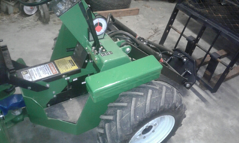

Good place for the fire ext. On your park brake, did your handle start off in the vertical position and you just made it longer? Mine starts off in the horizontal (off) and goes up from there. I think I would like to have it like yours, seems like it would be easier.
The part marked "A" is where the original handle was and "B" is the one that I welded on for the stop. The pipe being on there gets the handle away from the side a couple of inches ,so I don't skin my knuckles on that plate steel when putting the brake on/off.

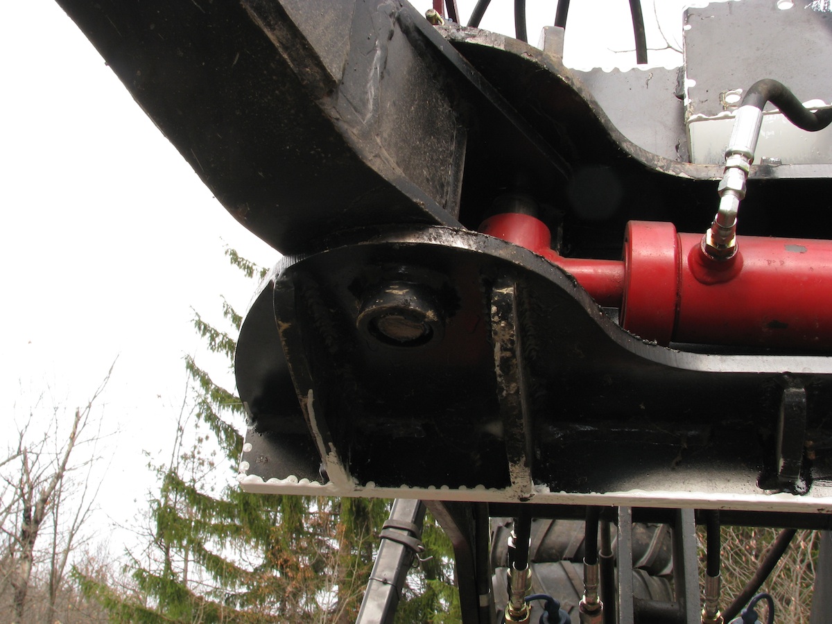

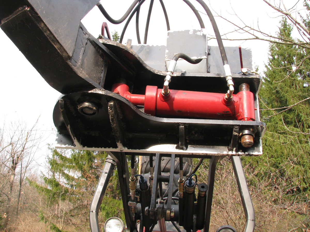

I am new to this make but interested in the T8 class - P2425 with removable backhoe, I did wonder if it would be possible to remove the hoe, & build a sleeve hitch lift to fit on the rear where the hoe was - something like this
HRH35 - Hydraulic Rear Hitch Kit - Struck Corp This is to allow a Brinly single bottom sleeve hitch plow to be used without the tractor having to run in reverse.
On the subject of the hoe, I remember this machine http://www.oilyhands.co.uk/images/Powerfab_180C_Brochure.pdf
It had a hoe that swung throu 140 deg but the kingpost swing bracket had two holes for the front pin on the swing cyl. This meant that a single cyl could either swing 90 left & 50 right, or by re setting the pin then a mirror image of before, 90 right & 50 left. Thus the full 180 arc was available to the user but not all at once. I have owned & run a couple of full size TBL's - the 180 is useful but I have never needed to go from full 90 left to full 90 right on any one job. (140 deg is the max a single cylinder can achieve before it bottoms out) They also built a small 3 pt attachment hoe with the same feature on, done the same way. Powerfab UK is sadly long gone.

I have a Lackender swinging minihoe that I use on the front end of my PT - I find it very handy - not just for digging but for using with the thumb to lift and move things such as logs or wood chunks when cutting firewood. The swing is centered.
